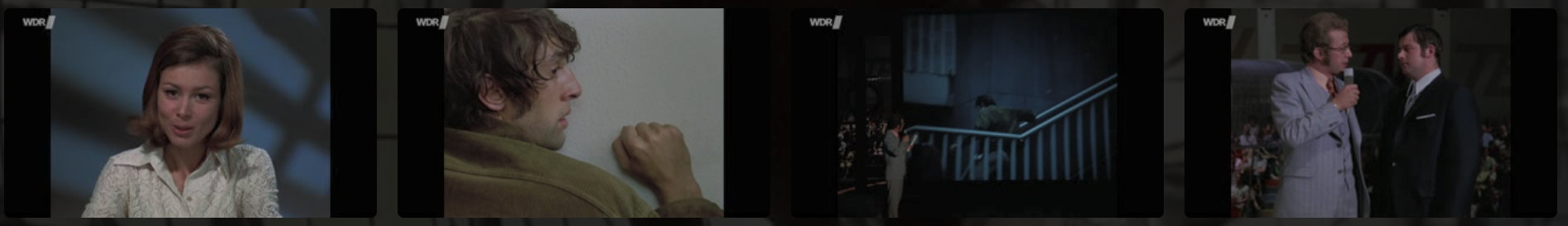

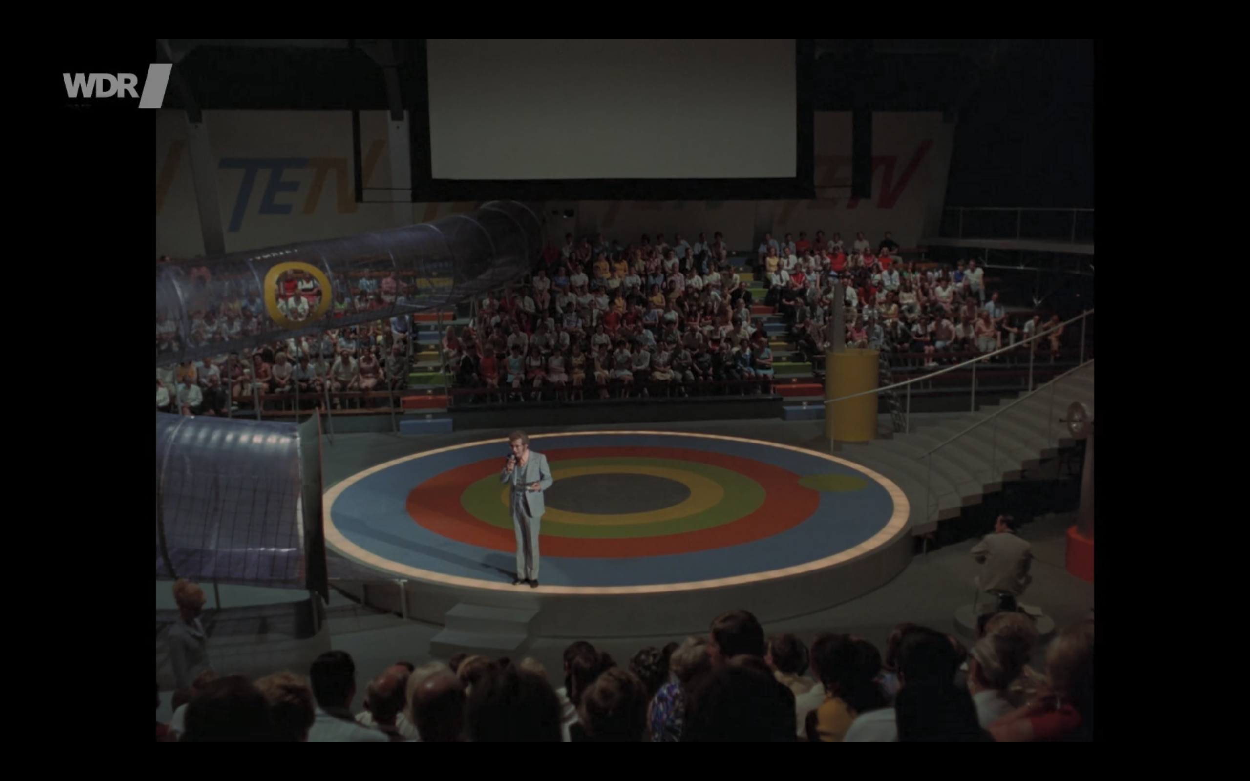

Killface69 96 Posted September 11, 2025 Posted September 11, 2025 (edited) Would it be possible to integrate a black bar detection for the media? Could run as a scheduled task. Due to the rise of DVB I have lots of old 4:3 content encoded in 16:9 with pillars, or 21:9 western classics also in 16:9; sometimes there's 16:9 letterboxed to 4:3. (Imax excluded) This leads to display issues, and I want to avoid reencoding my library. With black bar detection, full screen display should work much smoother across all devices/screens. Edited September 11, 2025 by Killface69
Luke 42243 Posted September 11, 2025 Posted September 11, 2025 18 minutes ago, Killface69 said: Would it be possible to integrate a black bar detection for the media? Could run as a scheduled task. Due to the rise of DVB I have lots of old 4:3 content encoded in 16:9 with pillars, or 21:9 western classics also in 16:9; sometimes there's 16:9 letterboxed to 4:3. (Imax excluded) This leads to display issues, and I want to avoid reencoding my library. With black bar detection, full screen display should work much smoother across all devices/screens. A visual would really help. If you could provide screenshots of what you see, compared to what you'd like to see, that would be extremely helpful. Thanks.
visproduction 335 Posted September 11, 2025 Posted September 11, 2025 45 minutes ago, Killface69 said: Would it be possible to integrate a black bar detection for the media? Could run as a scheduled task. I believe what KF is referring to are black bars that are part of the media. A 4:3 original content may have black bars left and right to allow it to play in the correct aspect ratio on a widescreen monitor. Also some 1.85 content gets thin top and bottom black bars for the same reason. Sometimes even 2.35 or 2.39 gets' top and bottom black bars added into th media for the same reason, to make sure the aspect ratio playback stays correct on widescreen 16:9 TV's. These extra black bars were often added into DVD content. Anyone recoding content from whatever source, could also add in black bars for whatever reason. I would think that is more rare. So, what can Emby do with searching for black bars inside content. Some movies, particularly from Wes Anderson make use of mulitple aspect ratios in the one film. So these movies will have black bars, left and right, top and bottom, during the normal playback because the director wanted to change the aspect ratio. I think any feature that Emby adds to look for black bars and auto crop them would require that the content is prescanned and then cropped during transcoding. It would be easy for this to fail in dark scenes, or with the exception change of aspect ratio. Also any TV programming can flip from one ratio to another with ads. I don't think this feature is practically, nor will it work well, plus you loose a generation just trying to run it in real time. TV's used to have buttons that flip the ratio around as needed for users. I think the TV manufactures have stopped this feature, perhaps because people hit the aspect change button and can't figure how to flip it back and then called for support. Also the need for this has gone away with newer content streaming releases and blu-ray media. The only people still running into the black bars are thoses dealing with content from DVD's, TV broadcasts or older copies encoded prior to around 2005. I think support for aspect ratio switching is gone from TV's for many years. Maybe projectors still have it. The correct fix for content with this problem, in my view, is to crop and reencode using a 3rd party encoder. Ffmpeg could do it from a script if you collected all identically black bared content together in one directory and hit the script to do all of the 4:3 with left and right black bars at once. Technically you could run 500 films through this crop by clicking Enter on a good script with a 'for' function. If you wanted to keep quality and only had software encoding, such a script may take 3 to 6 times the media duration to run for each media. If you had hardware encoding support, you still would not want to run any faster than 1 to 1 to keep the quality, so 500 films would take a while, but it could be done automatically. Prepping content happens all the time online. Netflix and Prime all prep content to work correctly for streaming on every release. I think it's a wrong approach to expect Emby to do this. It's your library. If you want playback to be cropped, then fix it by reencoding.

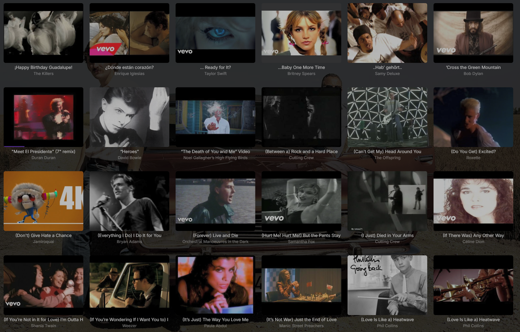

Killface69 96 Posted September 11, 2025 Posted September 11, 2025 (edited) Thans to visproduction, the first few paragraphs describe the issue perfectly. But there are also other cases for letterboxed or pillar boxed videos. I have music videos from the 90s, both pillar and letter. Lots of older releases from the Criterion Collection are also pillarboxed. I know of media switching the aspect ratio, that was addressed by my Imax example in brackets. Taking multiple samples across the media is the key. I also suggested a scheduled task for this library operation. I do not want to crop and reencode my media. Recompression takes time, consumes power and always degrades quality. No. Never. 4x3 video with pillarbox with default view on a 16:10 screen. Overview of my music video library. The black bars are a mess, and most 4x3 "remasters" in HD are 16x9 pillarboxed. No fun switching the display mode. 4x3 with pillar box viewed on 16x10, also with logo. Edited September 11, 2025 by Killface69 Screenshots
