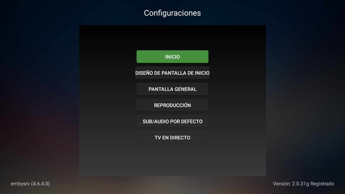

vdatanet 1619 Posted July 20, 2021 Posted July 20, 2021 Here you can find the ATV app version, 2.0.31g in this particular example:

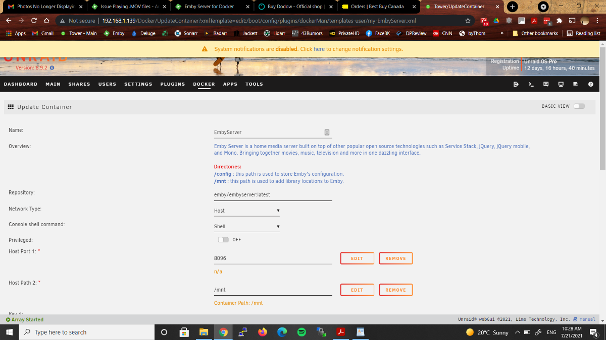

daniel.bmyer 11 Posted July 20, 2021 Author Posted July 20, 2021 The version that's installed is 2.0.0.9g. This is installed via a docker. I can't just update it...as far as I know. I'm wondering if I should remove the docker and reinstall. The files used to play fine.
daniel.bmyer 11 Posted July 20, 2021 Author Posted July 20, 2021 I uninstalled and reinstalled but same problem. It plays fine on the web server but not on the shield tv. Not sure why I would need to join a beta group? I don't want to be playing around with my unraid dockers. Do any of you have 2.0.0.9g installed and have it working? Something must have changed at some point as it used to play fine.
vdatanet 1619 Posted July 20, 2021 Posted July 20, 2021 7 minutes ago, daniel.bmyer said: I uninstalled and reinstalled but same problem. It plays fine on the web server but not on the shield tv. Not sure why I would need to join a beta group? I don't want to be playing around with my unraid dockers. Do any of you have 2.0.0.9g installed and have it working? Something must have changed at some point as it used to play fine. No, nothing to do with docker, it’s just the client app.
Carlo 4561 Posted July 21, 2021 Posted July 21, 2021 16 hours ago, daniel.bmyer said: The version that's installed is 2.0.0.9g. This is installed via a docker. I can't just update it...as far as I know. I'm wondering if I should remove the docker and reinstall. The files used to play fine. Not the issue here, but just so you know your docker can be updated with this command. docker pull emby/embyserver:latest This is covered in the Emby Docker instructions you can read from this page. https://emby.media/docker-server.html
