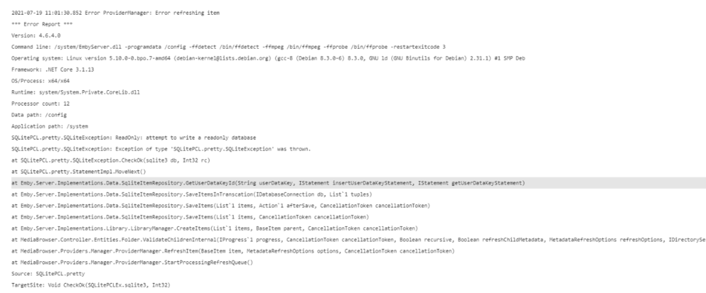

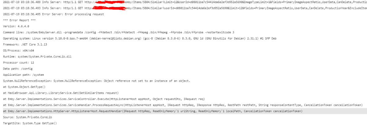

drokeravens 0 Posted July 19, 2021 Posted July 19, 2021 Hey! I'm running a emby server, and sometimes the login for all users stops working (invalid username / password). It has been happening a lot :/. I have checked the logs, and first I saw something weird: then I was going even more deep to know what is happening, and looks like this is the root of the problem: why is this happening?

Happy2Play 9802 Posted July 19, 2021 Posted July 19, 2021 Not sure we've see this error but there is a issue with your Database. ReadOnly: attempt to write to a readonly database But looks similar to the Locked database error. I would first try the steps in the Locked database section of the KB. https://support.emby.media/support/solutions/articles/44002210894
drokeravens 0 Posted July 19, 2021 Author Posted July 19, 2021 2 minutes ago, Happy2Play said: Not sure we've see this error but there is a issue with your Database. ReadOnly: attempt to write to a readonly database But looks similar to the Locked database error. I would first try the steps in the Locked database section of the KB. https://support.emby.media/support/solutions/articles/44002210894 Restarting emby works, but still happening randomly ;-;
Happy2Play 9802 Posted July 20, 2021 Posted July 20, 2021 So that would suggest there is a similar/different issue still in 4.6.4.0. Unless this is a platform specific issue. But probably need to see the server log with this error and maybe the log before it.
Luke 42201 Posted July 20, 2021 Posted July 20, 2021 20 hours ago, drokeravens said: Restarting emby works, but still happening randomly ;-; Hi there @drokeravens, did you follow the instructions listed here? https://support.emby.media/support/solutions/articles/44002210894
