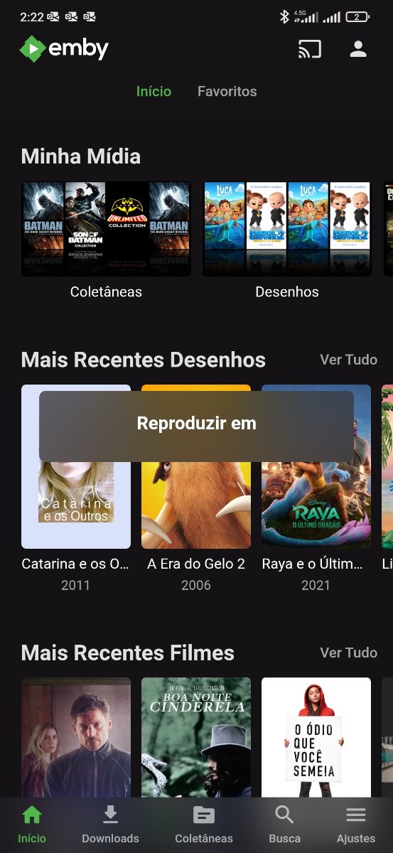

infinity net 1 Posted July 20, 2021 Author Posted July 20, 2021 E igual lhe falei qualquer play que eu da não aparece nenhuma tv para transmitir so aparece para transmitir para o notebook que esta o servidor ou para o celular

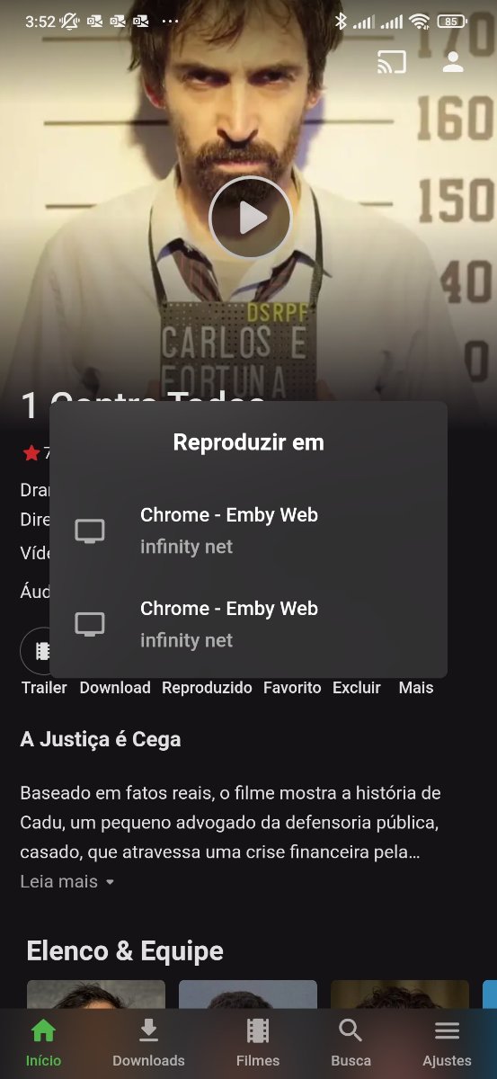

Luke 42201 Posted July 20, 2021 Posted July 20, 2021 43 minutes ago, infinity net said: E igual lhe falei qualquer play que eu da não aparece nenhuma tv para transmitir so aparece para transmitir para o notebook que esta o servidor ou para o celular Hi, can you please show a screenshot of what device you have selected in the "Play On" menu? Thanks.
infinity net 1 Posted July 20, 2021 Author Posted July 20, 2021 3 hours ago, Luke said: Olá, você pode mostrar uma captura de tela de qual dispositivo você selecionou no menu "Play On"? Obrigado.

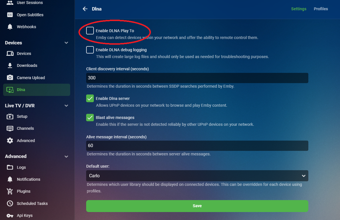

Carlo 4561 Posted July 20, 2021 Posted July 20, 2021 OK those are only Chrome Browser choices. Do you have any Smart TV's running Emby or DLNA? Do you have DLNA turned on in your Emby Server?

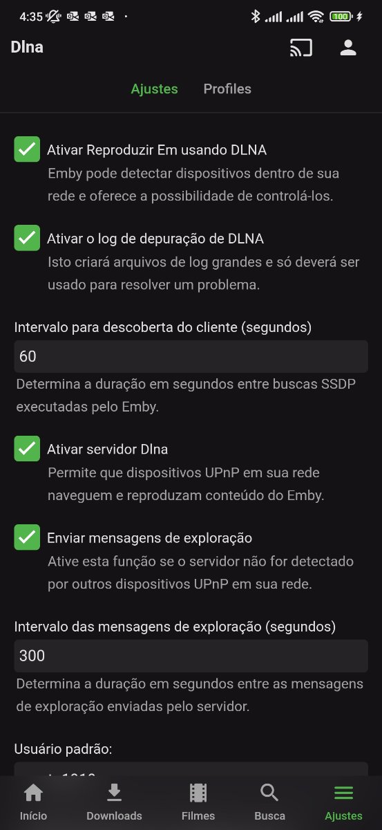

infinity net 1 Posted July 20, 2021 Author Posted July 20, 2021 34 minutes ago, cayars said: OK those are only Chrome Browser choices. Do you have any Smart TV's running Emby or DLNA? Do you have DLNA turned on in your Emby Server? Essa opção ai tem que esta ativa ou desativada
infinity net 1 Posted July 20, 2021 Author Posted July 20, 2021 Just now, infinity net said: Essa opção ai tem que esta ativa ou desativada
Carlo 4561 Posted July 20, 2021 Posted July 20, 2021 Yes you want it enabled. Did you change it or was it like this already?
infinity net 1 Posted July 20, 2021 Author Posted July 20, 2021 2 hours ago, cayars said: Sim, você quer habilitado. Você mudou ou já era assim? Ja e assim

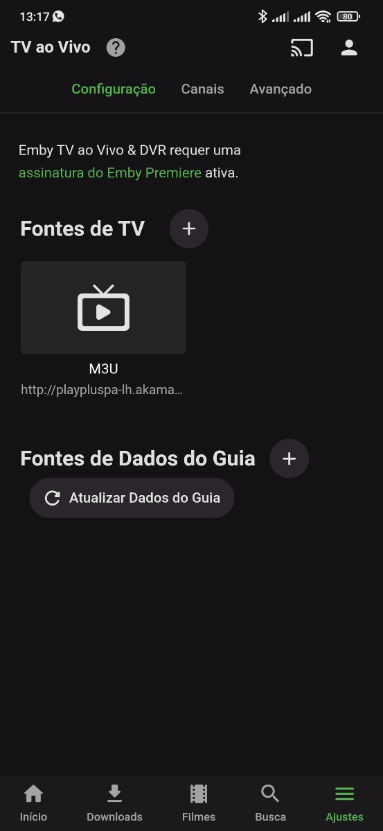

infinity net 1 Posted July 21, 2021 Author Posted July 21, 2021 Agora eu não intendo o porque de eu ter o emby premium e no painel dizer que eu nao tenho por isso nao consigo coloca lista m3u
Carlo 4561 Posted July 21, 2021 Posted July 21, 2021 (edited) Hi, That doesn't say you don't have it. That shows up because it's a Premiere Feature. It shows up on all systems. Besides, you already have an m3u file loaded. Edited July 21, 2021 by cayars
infinity net 1 Posted July 21, 2021 Author Posted July 21, 2021 Mas no painel nao aparece nada tem que baixa algum plugin
