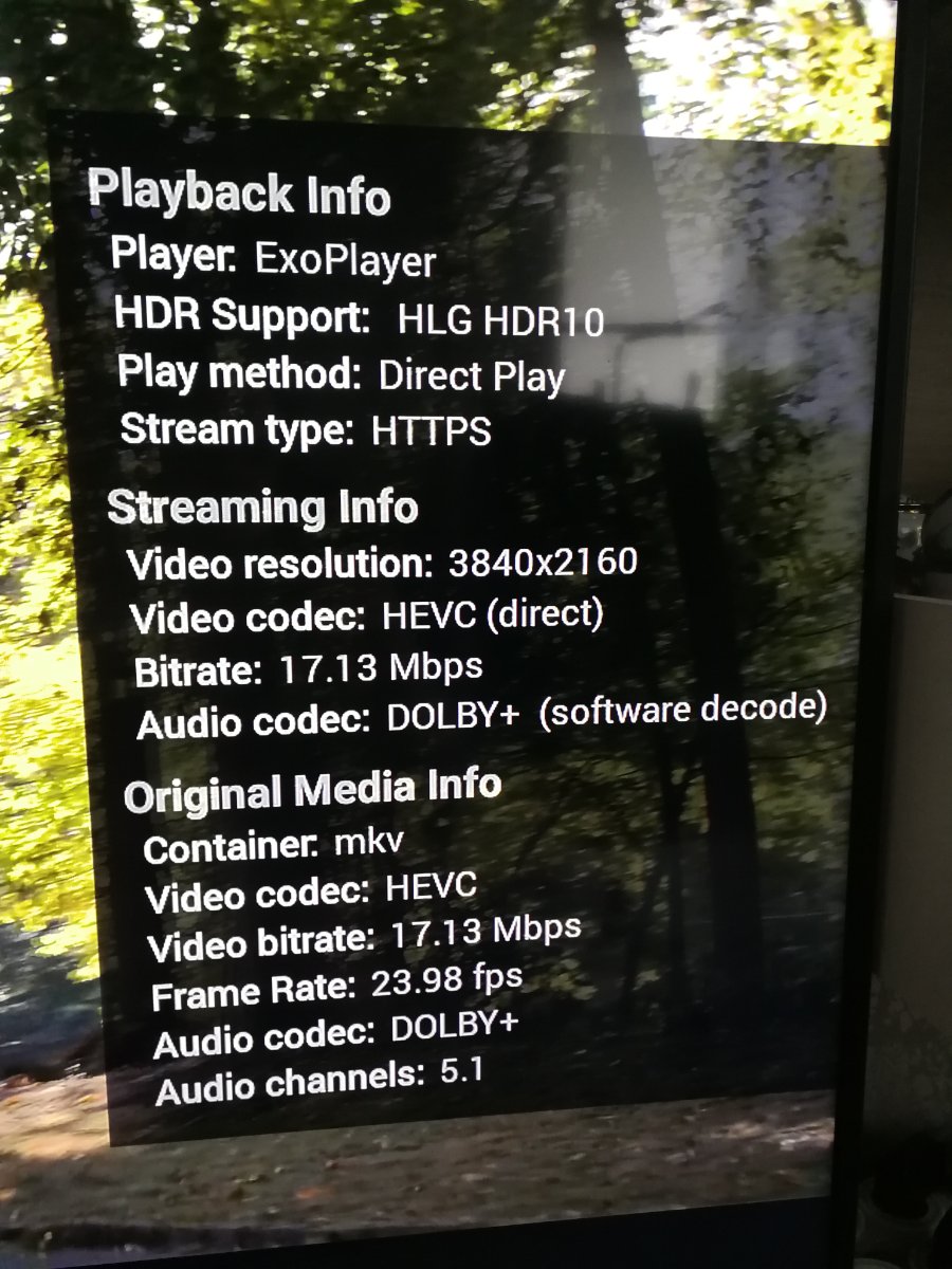

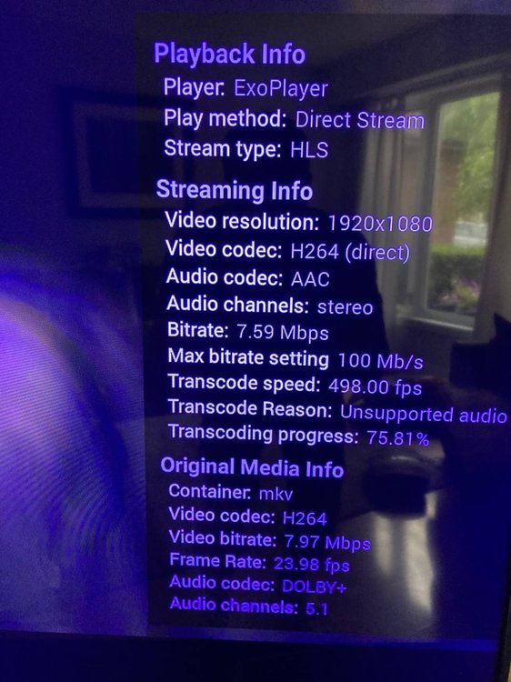

AcidDemon 0 Posted July 21, 2021 Author Posted July 21, 2021 (edited) I have asked a friend to stream the exact same content on his GTV system with headphones. // Due to his setup it's not the exact same file because he only has a FHD setup.But the audio line is the same. The settings on the GTV are the same. When he output the more detailed statistics it shows that it's downmixed to stereo. That's what missing on mine. I have added the two pictures. First picture is mine, second is his. Edited July 21, 2021 by AcidDemon Spell checked
ebr 16338 Posted July 21, 2021 Posted July 21, 2021 His is remuxing, yours is direct playing. Also, it would appear that he is running an older version of the app as an audio incompatibility shouldn't cause a remux anymore.

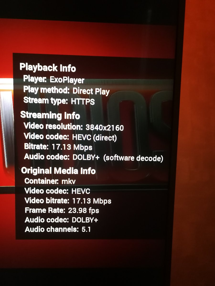

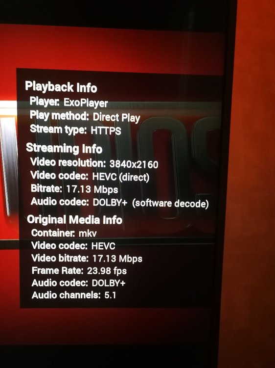

AcidDemon 0 Posted July 21, 2021 Author Posted July 21, 2021 I'm adding another screenshot from my Formuler Z8 device where everything is working correctly. Same headset. It looks pretty much the same as the one from the GTV.
