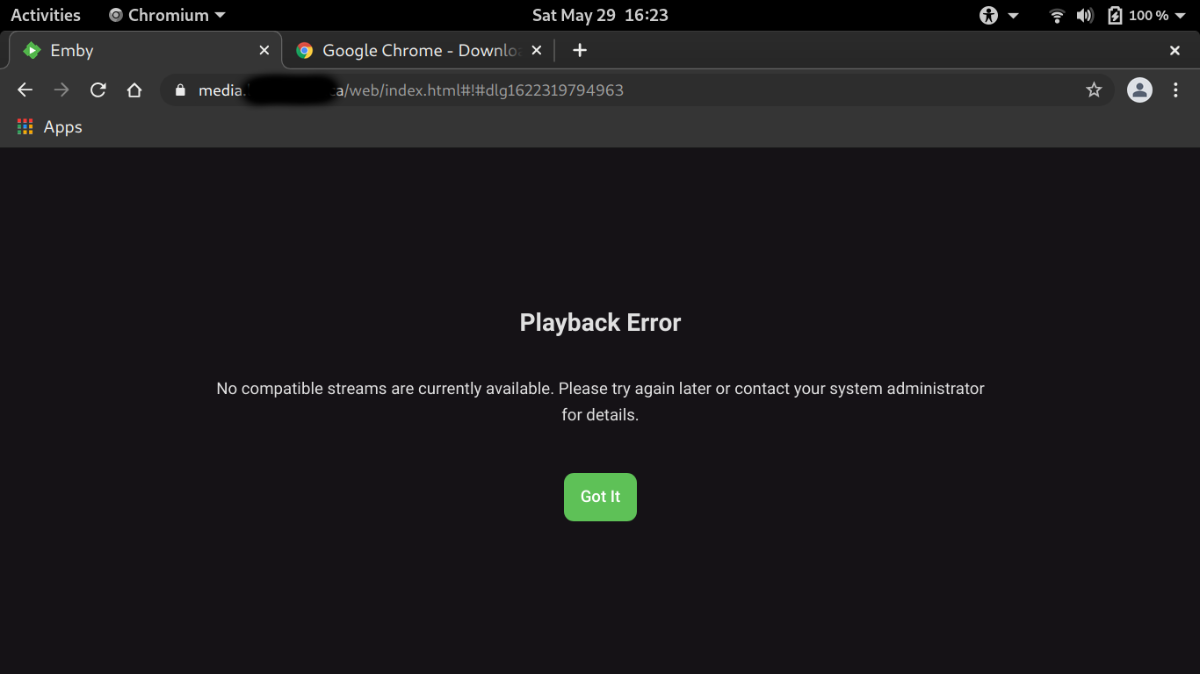

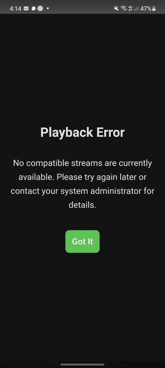

lushLi2ard60 0 Posted May 29, 2021 Author Posted May 29, 2021 Hello Luke, So I installed Firefox and Chromium, I attached a screenshot of the error. It's the same behavior, there is no plugin installed at all since it's a fresh install. I attached a screenshot of the same error when I try from the app & Chrome but from my phone. I also attached what it does when I try from my Chromecast. I tried a different movie each time as well. None of the devices work. Thanks.
