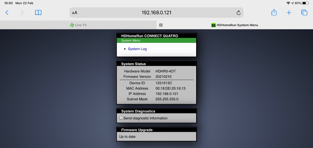

glenn1967 0 Posted February 22, 2021 Author Posted February 22, 2021 (edited) 7 hours ago, cayars said: Hi, what device is 192.168.0.115 ? It appears to be offline but is setup in Emby. Either get that working or remove it. After doing that please run a new guide refresh and then upload the complete log file not a subset of it. Thanks 192.168.0.115 is the IP address of my Emby Server, see screenshot. I uninstalled and reinstalled Emby completely and did a new guide refresh, still no guide data after this Friday. Complete log file attached. embyserver.txt Edited February 22, 2021 by glenn1967
Carlo 4552 Posted February 22, 2021 Posted February 22, 2021 You still have http://192.168.0.115/discover.json error showing up in your logs. What tuners do you have setup? Please post a screenshot of your tuner/guide setup.
glenn1967 0 Posted February 22, 2021 Author Posted February 22, 2021 7 minutes ago, cayars said: You still have http://192.168.0.115/discover.json error showing up in your logs. What tuners do you have setup? Please post a screenshot of your tuner/guide setup. Tuner is HDHomerun, screenshots attached.

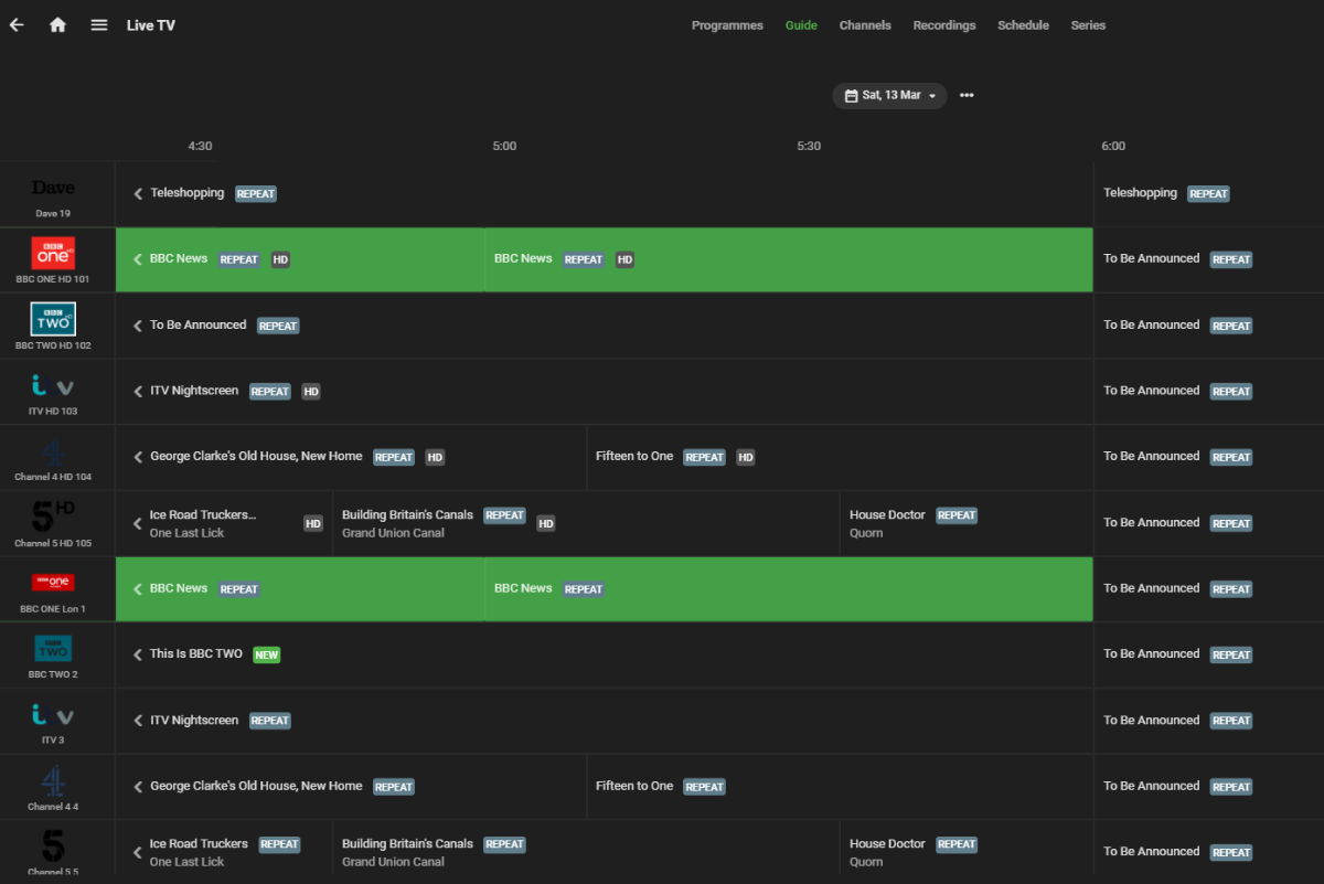

rbjtech 5000 Posted March 1, 2021 Posted March 1, 2021 Hi @cayars - it looks to be improving - and a lot of the minor channels now have the full 14 days, but the major UK channels (BBC, ITV etc) are still incomplete for the full 14 day guide. I checked after forcing a guide update, so this should be the latest picture. Thanks, Rich.
