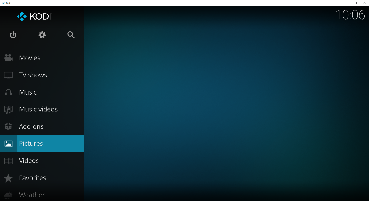

CharleyVarrick 283 Posted February 22, 2021 Author Posted February 22, 2021 Me again, I just noticed a minor issue, not sure if it relates or not to the recent Kodi update. 1st pic= In Emby web I see all my libraries, including Home Videos & Photos. 2nd pic= In Kodi all I see that relates to the above is Pictures, but its empty Is this normal ? 3rd pic = In Kodi, If I go in add-ons, select Emby-next-gen, Home Videos & Photos is there and accessible, but I would prefer it shows up from main page, as movies, tv and music do. Kodi offering Pictures but nothing to show
quickmic 1607 Posted February 22, 2021 Posted February 22, 2021 Native pictures support in main menu for Kodi is only supported in custom Skins or via addon query. So this seems alright. Was it different in the past (with 4.x versions?).
CharleyVarrick 283 Posted February 23, 2021 Author Posted February 23, 2021 On 2/22/2021 at 2:24 PM, quickmic said: Native pictures support in main menu for Kodi is only supported in custom Skins or via addon query. So this seems alright. Was it different in the past (with 4.x versions?). Now you make me question myself, but I really thought for sure Pictures library was offered and functional straight from Kodi homescreen in v18.
quickmic 1607 Posted February 24, 2021 Posted February 24, 2021 Yes but as I recall, it just offered you a link to the picture addons -> I guess it was emby-pictures. Not sure about that, cause I always replaced the picture selection link on home screen with a node link.
