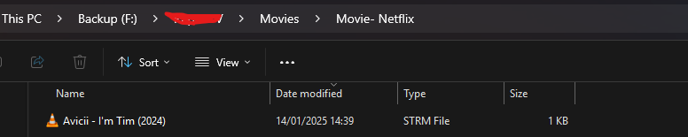

grimevil 62 Posted April 20, 2024 Posted April 20, 2024 18 hours ago, Webdoc said: Hello just started to use your script and noticed the vod movies have not been placed in folders, am I missing anything? Thanks I have the same issue, all movies are just in each folder. example \netflix\film (year).strm \netflix\film2 (year).strm instead of \netflix\film (year)\film (year).strm \netflix\film2 (year)\film (year).strm
Radical924 23 Posted December 24, 2024 Posted December 24, 2024 On 20/04/2024 at 01:16, grimevil said: I have the same issue, all movies are just in each folder. example \netflix\film (year).strm \netflix\film2 (year).strm instead of \netflix\film (year)\film (year).strm \netflix\film2 (year)\film (year).strm You need to set the setting "MovieGroupSubdirEnabled" in the config file after creating it with /c command to "True". Follow the instructions on the github page https://github.com/trix7777/m2strm?tab=readme-ov-file
grimevil 62 Posted January 14 Posted January 14 On 24/12/2024 at 11:46, Radical924 said: You need to set the setting "MovieGroupSubdirEnabled" in the config file after creating it with /c command to "True". Follow the instructions on the github page https://github.com/trix7777/m2strm?tab=readme-ov-file I have the option set in my config <add key="MoviesSubDir" value="Movies" /> <add key="SeriesSubDir" value="Series" /> <add key="TVSubDir" value="TV" /> <add key="DeletePreviousDirEnabled" value="False" /> <add key="UnwantedCFGEnabled" value="True" /> <add key="VerboseConsoleOutputEnabled" value="True" /> <add key="ProgramLogEnabled" value="True" /> <add key="PurgeFilesEnabled" value="True" /> <add key="SeriesGroupSubdirEnabled" value="True" /> <add key="MovieGroupSubdirEnabled" value="True" /> <add key="DownloadM3U8Enabled" value="True" /> It still does not create separate folders for each movie, I can send you the log if it helps debug it and screenshots of the folder setup?
trix77 4 Posted January 14 Author Posted January 14 (edited) 29 minutes ago, grimevil said: I have the option set in my config <add key="MoviesSubDir" value="Movies" /> <add key="SeriesSubDir" value="Series" /> <add key="TVSubDir" value="TV" /> <add key="DeletePreviousDirEnabled" value="False" /> <add key="UnwantedCFGEnabled" value="True" /> <add key="VerboseConsoleOutputEnabled" value="True" /> <add key="ProgramLogEnabled" value="True" /> <add key="PurgeFilesEnabled" value="True" /> <add key="SeriesGroupSubdirEnabled" value="True" /> <add key="MovieGroupSubdirEnabled" value="True" /> <add key="DownloadM3U8Enabled" value="True" /> It still does not create separate folders for each movie, I can send you the log if it helps debug it and screenshots of the folder setup? I'm sorry, but the MovieGroupSubdirEnabled option is for groups, there is no option to create a separate directory for each movie. I know this feature has been requested before, but I have not implemented it yet and I have no plans to work on this application at the moment. I still don't understand why on earth you would want to do this? Edited January 14 by trix77 . 1
