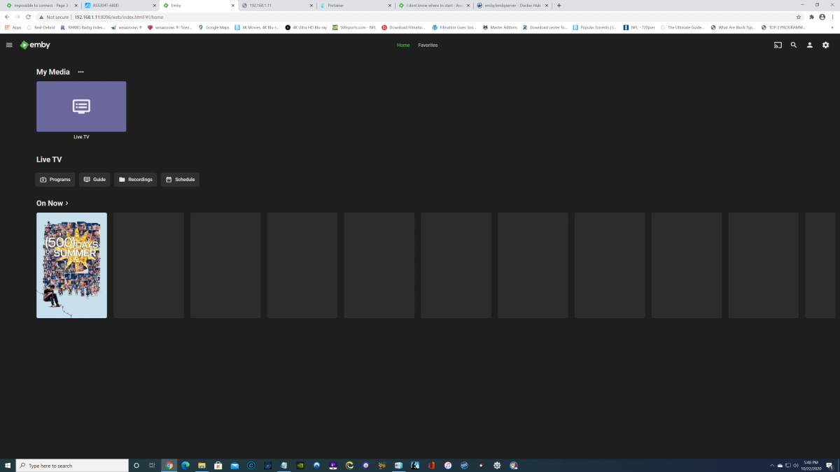

I'm up and running. I really appreciate all the help everyone has given.
Thanks Again,
Bdub43
