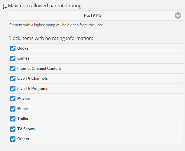

dethknite 37 Posted July 21, 2014 Posted July 21, 2014 The scraped movies seem to contain more text than just Rating from IMDB. ie. <mpaa>Rated R for violence throughout, language and brief nudity</mpaa> This makes parental controls not work at all and movies that are R show up under a Kids profile set to only allow up to PG. perhaps adding in the ability to detect "Rated " keyword and then parse for the next characters up to " " (trailing space). 1

dethknite 37 Posted July 23, 2014 Author Posted July 23, 2014 (edited) Further analysis: I reprocessed all movies and TV and created movie.xml and .nfo files. The issue still occurs with unknown ratings. For example.. Devil's Knot http://www.imdb.com/title/tt0804463 http://www.themoviedb.org/movie/152792 The rating MediaBrowser 3 scraped was "15", this does not match any of the filtering used in parental controls, so I would assume it should not display since I have it set to not allow non rated movies. But it shows up. It seems the do not allow un rated movies only works for blanks. Also failing are "Non Rated", "Not Rated", "Approved", "Rated R for sexual content, nudity and some language", etc. Perhaps a good fix would be to disallow anything that does not match.. and perhaps strip off the "Rated " if it exists. __________________________ Plex uses the following: <mpaa>Rated PG-13</mpaa> __________________________ XBMC skins rating: "Rated Country:Rating" ie. "Rated US:PG-13" or "Rated PG-13" __________________________ As reported in inssue #426 The output nfo now automatically puts a "Rated " in front of the mpaa rating value you have. 1. MPAA Ratings - <mpaa></mpaa> tag - XBMC expects the literal "Rated " to appear before the actual rating (example <mpaa>Rated R</mpaa>). If you want the actual "UK:U" to appear in the mpaa, change your pattern to: (?<grp1>(UK:.*?))</a> which will now output <mpaa>Rated UK:U</mpaa> in the nfo file. Edited July 23, 2014 by dethknite
ebr 15662 Posted July 23, 2014 Posted July 23, 2014 The rating MediaBrowser 3 scraped was "15", Are you 100% sure that was us? We put the country code in front of ratings like that so it would be something like "GB-15" if we got it. Or, there is a new bug because this has been working. Putting extra textual information in that tag just seems very wrong to me. We've been using it for years with nothing but the actual valid rating in it.
dethknite 37 Posted July 23, 2014 Author Posted July 23, 2014 (edited) I am sure.. I estimate about 10% of movies have invalid data in the movie.xml file that was created with the latest beta version of MediaBrowser 3. see attachement: <ContentRating>15</ContentRating> * There never was extra textual info in the tag used in movie.xml, only in the actual XBMC.nfo file that was scraped from XBMC and MediaCompanion. Edited July 24, 2014 by dethknite
dethknite 37 Posted September 13, 2014 Author Posted September 13, 2014 I am marking this as still an issue. I uninstalled MB3 completely, installed the newest beta today. Let it update all the metadeta with the default settings.. (not storing in xml in media folder.. so it is simply stored in MB3 database). Still have "Rated PG-13 for scenes of...." or "Rated R for violence and nudity..." getting pulled for rating. So when I set the Kids login to PG Movies for max allowed, and check Block all unrated for all categories... it still displays all the movies and TV shows that have the Rated .... blurb. As stated before... it seems this is a common rating system out there. Would be best to parse the "Rated " keyword out as XBMC does and shown above. Otherwise the parental controls are really a mute point for me unless I go through and manually change the rating for a few thousand movies and shows...

Solution Deathsquirrel 744 Posted September 13, 2014 Solution Posted September 13, 2014 Easy enough to sort if the source is MBS. Remove all the metadata files from a movie that you know has this issue. You can leave the .JPG & .PNGs but lose the rest. Open MBS, edit that movie, refresh the data. Look at what MBS creates. If the problem is coming from some other metadata scraper it won't exist after you do that. 1
