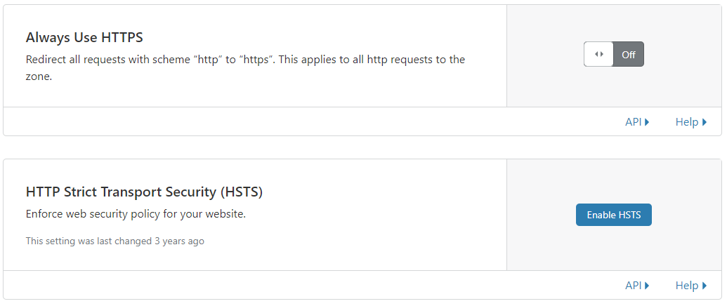

Also Turn on these options under SSL/TLS settings - Edge Certificates, are these options on?   (shown below both are OFF)
Edited by pir8radio

I had "Always use HTTPS" enabled before.  But I didn't have HSTS setup - since then I have set this up now.
It's just when I try and access my server in the emby theatre app using just  emby.mydomain.net  I see it not redirect to the https:// protocol (even though it's enabled on Cloudflare).
It seems to stay on the HTTP URL.  Because of this when I try and log in it will fail to authenticate.
