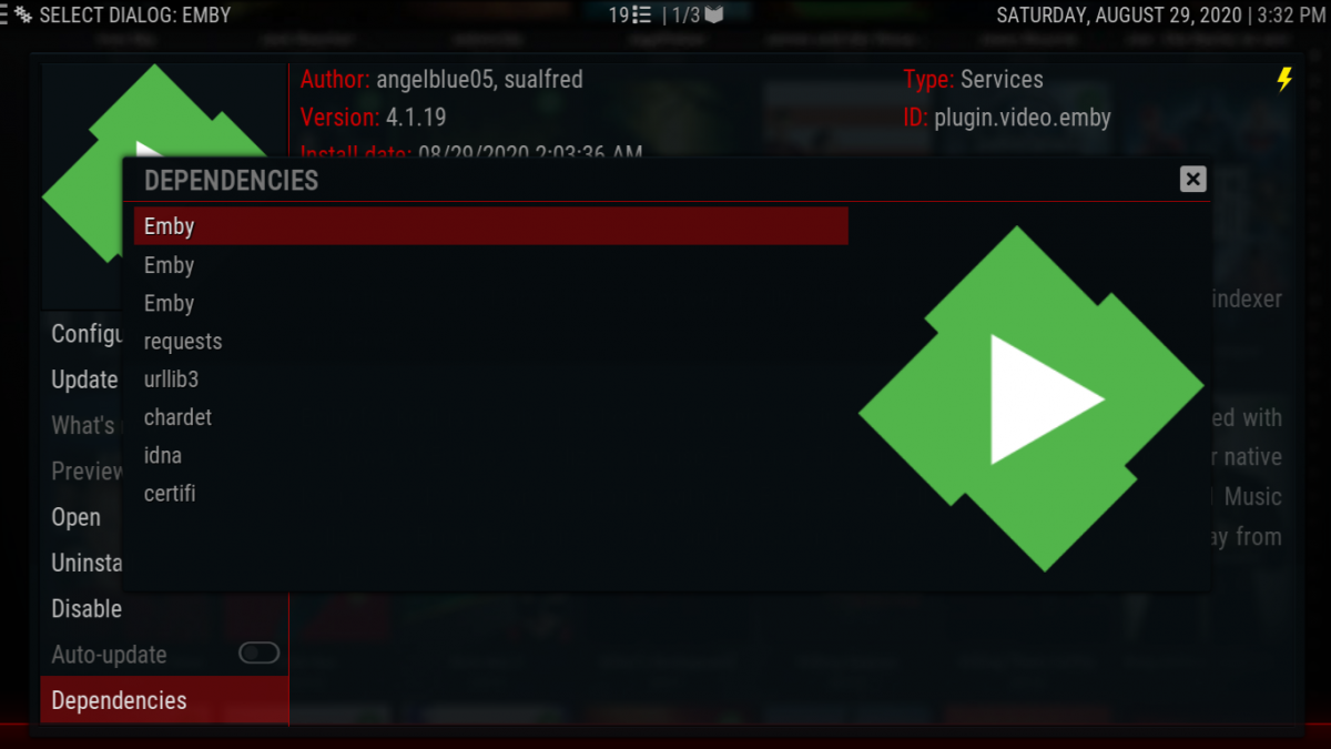

Currently when I perform a restore, an addon named, TheCrew, stops working. However, an update exists that will fix it but I have to update LibreELEC to v9.2.4 which updates Kodi to 18.8 and then I can update the third-party, TheCrew, addon. This addon also updates a number of dependencies. [see screenshot]. I've also included Emby dependencies to demonstrate there does not appear to be any overlap.

Doing so, I was able to resolve my own issue. There was a dependency addon that was stepped on by TheCrew addon. The REQUESTS dependency addon is relied on by ResolveURL, SportsDevil and Emby.
Steps to fix [for my case]: Restore from backup. Update LibreELEC to v9.2.4/Kodi 18.8 then immediately "Update All" in "Available Updates" under Add-on Browser. Once complete, then and only then, do you update TheCrew addon and all it's dependencies.
Alternatively you could dig through Kodi 'System' settings and find 'Addons' and then "Running" dependencies and find the 'Requests' addon and upgrade/downgrade based on the version that is currently giving you issues.
