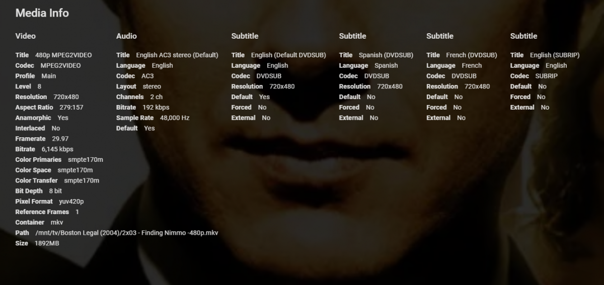

theflyingfool 1 Posted August 8, 2020 Author Posted August 8, 2020 5 minutes ago, speechles said: Is it the runtime? I can start to deduce where it is and start to build a defense against that part. I assume runtime is going to be a major issue when missing. @theflyingfool When you experience the issue again please give us the "Media Info" section of the web app. This is at the bottom of that items detail page. Because we have not fixed the issue and can only guess at the cause it can/will happen again. Please if you can help us identify the problem. Thanks and apologies for the issue. We expect certain data to always return from the server. That is our mistake and we can correct it. We just need to see where the mistakes are being made. Thanks again. I've found another item. I assume this is what your looking for: On the off chance you think it has to do with multiple versions, I only have a single version of any boston legal episode, example of one that wasn't working: 6 minutes ago, ebr said: Hi. Your first post said 4.0.4 which is the standard release but then we asked you to try the beta and you said you did and the problem was still there but never confirmed the version of the app after you said you installed the beta. I just want to be sure you are actually running the beta version because we know of an issue like this that is fixed in it. Thanks. My apologies request was unclear. I may have been slightly annoyed, the request because the very first reply I got asked the same question. Batman Beyond has issues in both 4.0.4 and 4.0.8
speechles 2004 Posted August 8, 2020 Posted August 8, 2020 (edited) Runtime is mysteriously and noticeably absent. Usually a culprit of the item still copying over as Emby "noticed and ingested it". Aspect ratio on some are curious but that shouldn't throw the Roku until it attempts to play them. I bet it is the runtime in some form expected to exist. I can find the cause of that part. Hopefully that is all this is. Thank you for taking the time to give us clues to give us better direction. We will do our best to prevent this in the future. We will have something soon. Until then you can run a "REFRESH" on that item on the items detail page within the Roku app. That will give it a runtime. You may not even be able to get to that point because before you get there it crashes. In that case you will need us to prevent the crash so you can get to that refresh button and click it. This is the expected work flow. You will be able to do this again soon. Also.. Items without runtimes will ALWAYS TRANSCODE because they are seen as live streams with missing runtime on the Roku. It will transcode to produce a seekable stream in this case. Once you refresh and gain a runtime it will properly use capabilities detected on the Roku. Edited August 8, 2020 by speechles 1

speechles 2004 Posted August 8, 2020 Posted August 8, 2020 (edited) The item is partially ingested. When you go to play the partially ingested item it(your Emby server) then creates the runtime. But if you go to the "detail" screen before this it grabs the playback info(to get version/audio/subtitle information on streams) just the same as if were going to play but isn't actually playing. This is what crashes it I believe is the attempt to pull the playback info that is missing runtime. When you actually play the item with the PLAY button before you get to the detail screen it should not crash but play the item. Did you play these by pressing "play" on your remote directly on the item... or ...are you going to the detail screen and using the "play" button shown on the screen? Edited August 8, 2020 by speechles
theflyingfool 1 Posted August 8, 2020 Author Posted August 8, 2020 I suppose I'm a tad confused, with all that, I would have thought media info through the web app should show the runtimes.(example Avatar, which was direct playing on a roku prior(and while) pulling the media info on the web app) With Batman beyond on 4.0.4 & 4.0.8 I can not get to individual episode details, I can get to the show, but any attempt to play an episode or get to an episodes details cause crash to home.
speechles 2004 Posted August 8, 2020 Posted August 8, 2020 (edited) @Luke where did runtime go? Is that not showing within the "Video" field of the items detail screen "Media Info" on the web app anymore? It gets hard to deduce what is missing when everything isn't shown. Ghosts. Hard to spot ghosts. Did runtime get removed long ago and I just missed the memo? Curious. Runtime is missing on all my things on the web app media info video section. Shouldn't that be exposed? Edited August 8, 2020 by speechles
