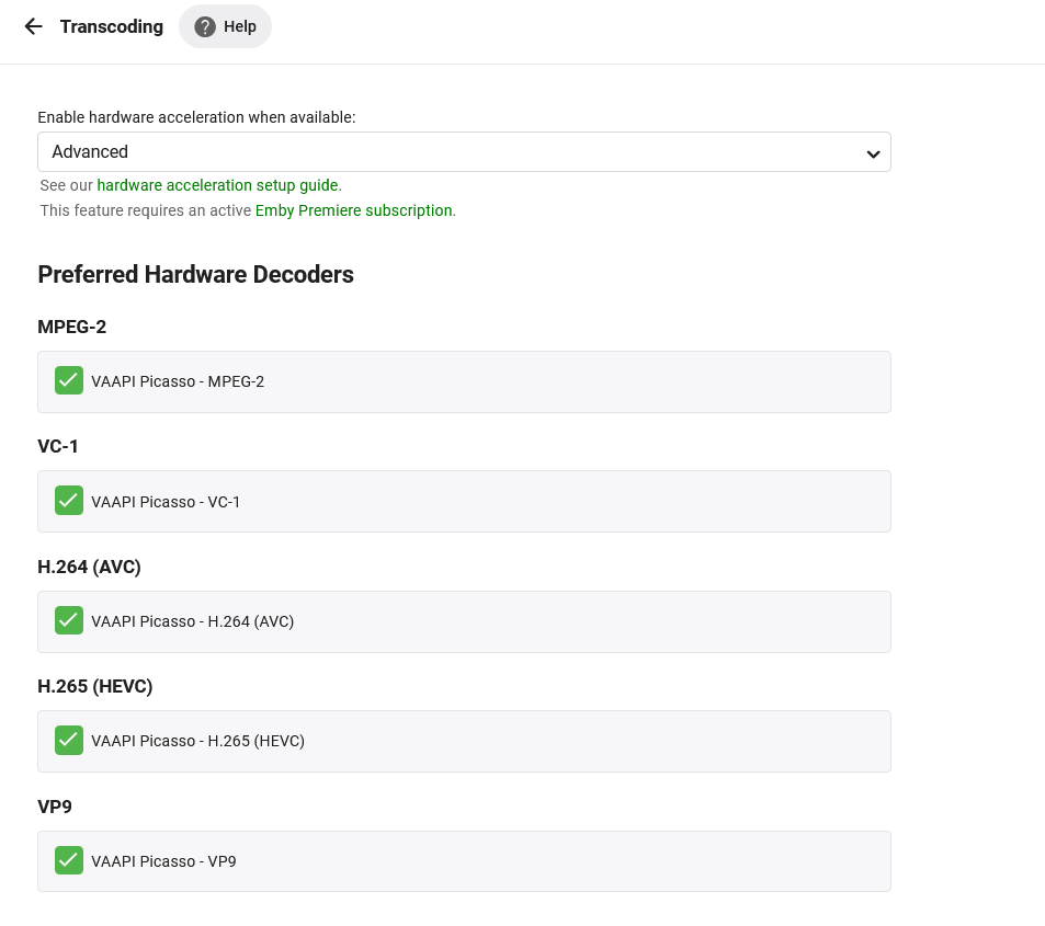

Guest phoenixexcinere Posted May 25, 2021 Share Posted May 25, 2021 6 hours ago, cayars said: Can you make it bigger or just do 100% screen captures with the PrtSc key above the backspace? Link to comment Share on other sites More sharing options...
Carlo 4328 Posted May 25, 2021 Share Posted May 25, 2021 Thank you. Much easier to read! I'm going to suggest you install the Diagnostic Plugin from the plugin catelog After Emby server restart you will have a couple more menu options on the left menu. Go into ADVANCED TRANSCODING Select TONE MAPPING tab up top. Set the top options to match these: That will make sure software tone mapping is available as well as limit it to 1080p so you won't be sending 4K streams when using software tone mapping. Let us know how this works out for you. Link to comment Share on other sites More sharing options...
Guest phoenixexcinere Posted May 25, 2021 Share Posted May 25, 2021 7 hours ago, cayars said: Let us know how this works out for you. Unfortunately not the colors are still pale But if I set Tone Mapping Method to Extra-T, as you can see on ny screenshot, the colors are still perfect, indeed, i think Emby use software tone mapping to do that, because the CPU usage is at 100%. I must confess that I don`t know if a ryzen 3200g support tone mapping on hardware side Link to comment Share on other sites More sharing options...
