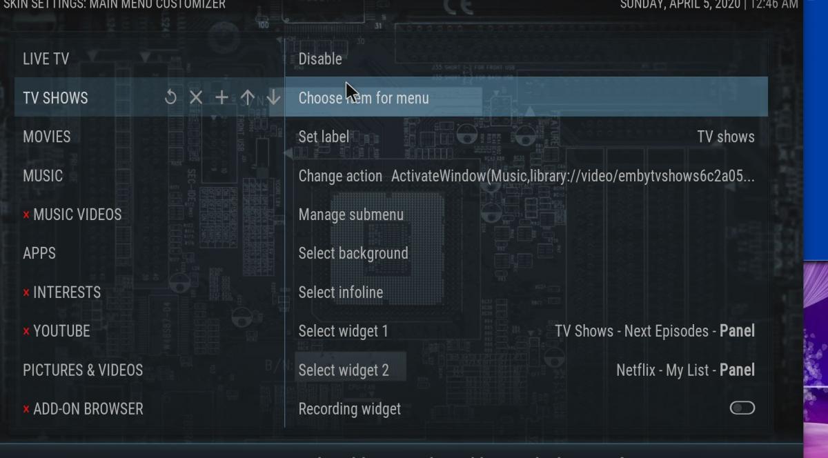

jachin99 87 Posted April 5, 2020 Posted April 5, 2020 (edited) I took a little bit of a better look at this. It looks like my skin shortcut for tvshows is being pointed to the music window and videos db at the same time. I grabbed a screen capture that explains more and I'll post that tomorrow. Edited April 5, 2020 by jachin99
jachin99 87 Posted April 5, 2020 Posted April 5, 2020 I cant be sure that I'm reading this right but here is a screenshot
jachin99 87 Posted April 6, 2020 Posted April 6, 2020 Downgrading to Kodi 18.5 didn't change anything
