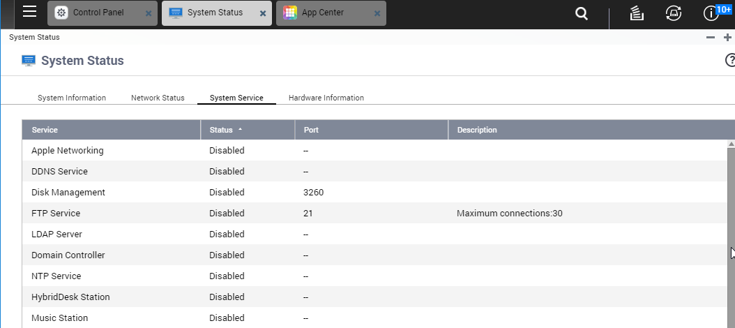

ngranger 1 Posted December 14, 2019 Author Posted December 14, 2019 Not exactly sure how to check that. is that found under "system status" > "system services"? Nick
ngranger 1 Posted December 14, 2019 Author Posted December 14, 2019 i took a few screenshots of the system services list if that helps....
ngranger 1 Posted December 14, 2019 Author Posted December 14, 2019 I noticed the emby server was on when i loaded the ps3 up thismorning for the kids. I i think that answers your question Luke?
