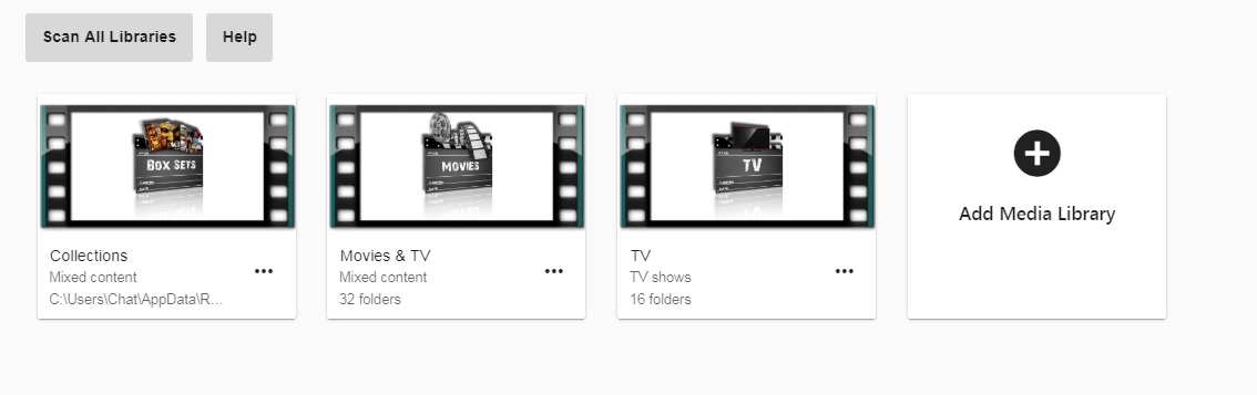

embyuser102019 0 Posted October 8, 2019 Posted October 8, 2019 (edited) Dear Emby Team, I am a premiere users and after an Emby update in February 2019 it seems there are a few issues I am having. 1. "Movies" are being displayed with folders beside them. This is the parent folder containing the movie. Screen shots attached. 2. "TV" programs is displaying as blank. screen shot attached. 3. "Home screen" has stopped displaying "Continue Watching", "Latest media", and "Next Up". Screen Shot attached. 4. "Collections" is showing up as blank also. Screen shot attached. I would like to know how I can correct each of the issues. Please advise if you require additional information. Log attached. Thanks. Edited October 8, 2019 by embyuser102019

ebr 15664 Posted October 8, 2019 Posted October 8, 2019 And the type of your Movies library is "Movies" and your TV library is "TV Series"?
embyuser102019 0 Posted October 8, 2019 Author Posted October 8, 2019 Hi, Collection = Mixed Content Movies = Mixed Content TV = TV Shows
ebr 15664 Posted October 8, 2019 Posted October 8, 2019 Why are you using Mixed Content? It looks like you have everything separated by type... My guess right now is probably that you have pointed your "Movies & TV" library to the same location(s) as your just "TV" library and that is not supported (the same location in multiple libraries).
embyuser102019 0 Posted October 8, 2019 Author Posted October 8, 2019 Hi, When i originally installed Media Browser several years ago, Under movies I had MKV, MP4 and DVD (Video_TS) and BluRay (BDMV) folder structure also. Mixed Content seemed to display the information best. For TV it has always been TV Shows. However, I have checked the paths and they seem to be separate locations. The paths have not been changed since the initial install and I don't believe they are pointing to the same location. If I have understood you correctly. Thanks.
ebr 15664 Posted October 8, 2019 Posted October 8, 2019 Why is one of the libraries named "Movies & TV" if it doesn't point to any TV locations? Most similar situations to yours have come down to shared locations across libraries. Keep in mind that adding D:\TV and D:\TV\Bluray to two different libraries would be sharing locations (because the second one is a subset of the first)...
embyuser102019 0 Posted October 8, 2019 Author Posted October 8, 2019 It's was named Movies and TV originally when some scraping would not find certain movies. The scrape worked better under mixed content and some TV movies were coming up as TV shows. That scraping has improved over the years it seems. I understand the D:\TV and D:\TV\Bluray would be shared location, However I have; D:\Movies1\BLU RAY\MOVIES and D:\Movies1\BLU RAY\TV So would that be Ok?

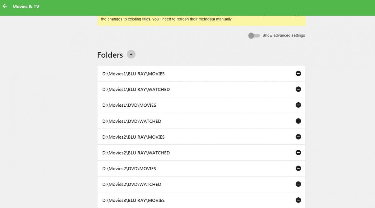

Happy2Play 9441 Posted October 8, 2019 Posted October 8, 2019 It's was named Movies and TV originally when some scraping would not find certain movies. The scrape worked better under mixed content and some TV movies were coming up as TV shows. That scraping has improved over the years it seems. I understand the D:\TV and D:\TV\Bluray would be shared location, However I have; D:\Movies1\BLU RAY\MOVIES and D:\Movies1\BLU RAY\TV So would that be Ok? But that would suggest TV identification then. All your images show doubled content. You only show a portion of your folders paths as your movie and tv library shows 32 folders and 16 for TV. Could you have doubled your library assigned folders?
embyuser102019 0 Posted October 8, 2019 Author Posted October 8, 2019 Hi Thanks for your response. Yes i have 32 folder for Movies D:\Movies1\BLU RAY\MOVIES D:\Movies1\BLU RAY\WATCHED D:\Movies1\DVD\MOVIES D:\Movies1\DVD\WATCHED D:\Movies2\BLU RAY\MOVIES D:\Movies2\BLU RAY\WATCHED D:\Movies2\DVD\MOVIES D:\Movies2\DVD\WATCHED D:\Movies3\BLU RAY\MOVIES D:\Movies3\BLU RAY\WATCHED D:\Movies3\DVD\MOVIES D:\Movies3\DVD\WATCHED D:\Movies4\BLU RAY\MOVIES D:\Movies4\BLU RAY\WATCHED D:\Movies4\DVD\MOVIES D:\Movies4\DVD\WATCHED D:\Movies5\BLU RAY\MOVIES D:\Movies5\BLU RAY\WATCHED D:\Movies5\DVD\MOVIES D:\Movies5\DVD\WATCHED D:\Movies6\BLU RAY\MOVIES D:\Movies6\BLU RAY\WATCHED D:\Movies6\DVD\MOVIES D:\Movies6\DVD\WATCHED D:\Movies7\BLU RAY\MOVIES D:\Movies7\BLU RAY\WATCHED D:\Movies7\DVD\MOVIES D:\Movies7\DVD\WATCHED D:\Movies8\BLU RAY\MOVIES D:\Movies8\BLU RAY\WATCHED D:\Movies8\DVD\MOVIES D:\Movies8\DVD\WATCHED And for TV D:\Movies1\BLU RAY\TV D:\Movies1\DVD\TV D:\Movies2\BLU RAY\TV D:\Movies2\DVD\TV D:\Movies3\BLU RAY\TV D:\Movies3\DVD\TV D:\Movies4\BLU RAY\TV D:\Movies4\DVD\TV D:\Movies5\BLU RAY\TV D:\Movies5\DVD\TV D:\Movies6\BLU RAY\TV D:\Movies6\DVD\TV D:\Movies7\BLU RAY\TV D:\Movies7\DVD\TV D:\Movies8\BLU RAY\TV D:\Movies8\DVD\TV They have not been doubled up. They all contain different files. The Watched folders contains movie stub files. Movie that have been archived to removable storage.
ebr 15664 Posted October 8, 2019 Posted October 8, 2019 Is D a mapped network drive? If so, I strongly suggest UNC paths. Also, a little bit of organization change would make setting this up in Emby a LOT easier - e.g. move all movies under one parent folder and all TV under another and then you just have one location for each library. And, in the process, change the content type of your Movies library to just Movies.

embyuser102019 0 Posted October 8, 2019 Author Posted October 8, 2019 Is D a mapped network drive? If so, I strongly suggest UNC paths. Also, a little bit of organization change would make setting this up in Emby a LOT easier - e.g. move all movies under one parent folder and all TV under another and then you just have one location for each library. And, in the process, change the content type of your Movies library to just Movies. Hi, D is a local disk. Movies1, Movies2, Movies3 .... to Movies8 are 8 separate local Physical disks. These disks are Mount points onto the root of the D:\ Disk. So therefore I can't have a single folder for Movies or TV. So are you suggesting i change the content type for the Movies & TV folder? But why would this stop working after the last update when nothing changed on this end?

ebr 15664 Posted October 8, 2019 Posted October 8, 2019 In order to better support true folder browsing, some of how we handle mixed content libraries changed in the last major release (4.x). I'm assuming that's what you are running into and still suspect some sort of overlap somehow. Have you considered a drive pooling solution? About $30 could greatly simplify your life in any number of applications...
