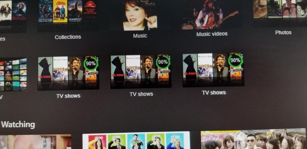

gerry.emm 10 Posted March 5, 2019 Author Posted March 5, 2019 Well, I have seemingly solved the problem but it looks like I have created 2 others...first of all, here's what I have done. I went through each and every folder and sub-folder for all my tv shows and have deleted every single file that was not an actual video file. Then, I removed all my tv libraries from EMBY...I have combined the 5 separate libraries I used to have into one single library...I used to have a library for my shows, one for my daughter's shows, one for animated series, etc...now, I have ONE library called "TV Shows" which contains them all...so EMBY re-scraped them all, but somehow, I have ended up with 3 times the heading "TV Shows" on my main menu, even though there is only one "TV Shows" library...I also got rid of an un-related library called "Playlists" but it also still shows up on my main menu... Can anyone guide me as to how to get rid of the duplicate libraries please? And before you ask, yes, all 3 have the exact same content...and if you could explain how to get rid of the"Playlists" library, that would be greatly appreciated too!!! Thanks again in dvance for any help you can provide!!! Gerry
Solution CChris 58 Posted March 5, 2019 Solution Posted March 5, 2019 the duplicate libraries are a known issue, as far as I know.There is one way to get rid of them:delete the library from your library management section in the admin panel.then, run two complete library scans.After they have finished, please add the library again.this should solve the issue with duplicated / multiplied libraries for now. 1
Luke 40074 Posted March 5, 2019 Posted March 5, 2019 That is correct, you can follow that procedure. It is resolved for the next release to not allow it to happen again. thanks.
gerry.emm 10 Posted March 5, 2019 Author Posted March 5, 2019 Thanks a million guys...I did as you suggested and it seems to have fixed the first problem...at last look, EMBY was re-scraping my TV Shows, and there seems to be only one heading... Any suggestions on how to get rid of the "Playlists" heading that I deleted from my libraries but is still being displayed on the main menu? And again, thanks in advance for any help you CAN provide as well as for the help you have ALREADY provided...it is MUCH appreciated!!! Gerry
Happy2Play 9441 Posted March 5, 2019 Posted March 5, 2019 (edited) Thanks a million guys...I did as you suggested and it seems to have fixed the first problem...at last look, EMBY was re-scraping my TV Shows, and there seems to be only one heading... Any suggestions on how to get rid of the "Playlists" heading that I deleted from my libraries but is still being displayed on the main menu? And again, thanks in advance for any help you CAN provide as well as for the help you have ALREADY provided...it is MUCH appreciated!!! Gerry Have you looked at your Home Screen setting? User icon-Home Screen-Playlists Edited March 5, 2019 by Happy2Play 1
gerry.emm 10 Posted March 6, 2019 Author Posted March 6, 2019 Hi Happy2Play, Thanks for guiding me there...I un-checked the option to display that "menu option" in my Home Screen settings, and "miracle of miracles"...it's gone!!! Thanks a ton to everyone that helped solve these little problems!!! My EMBY server finally looks the way it used to!!! Gerry P.S. - to anyone considering using "Media Companion" to help scrape your content properly...DON"T...I suspect that it"s what got me into this mess to start with!!!
