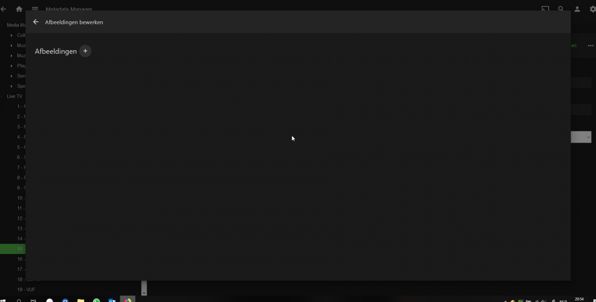

B3rt 8 Posted January 8, 2019 Author Posted January 8, 2019 when i edit channel 14, 15 or 16 there is no image to delete, i only get the option to add an image, see attached file

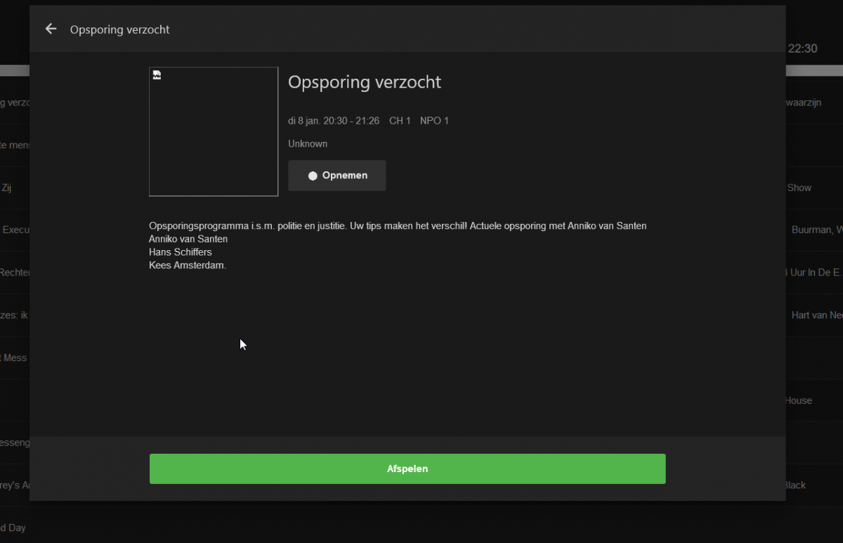

B3rt 8 Posted January 8, 2019 Author Posted January 8, 2019 I also noticed that when i click on the EPG tekst here is also a picture missing.....
B3rt 8 Posted January 8, 2019 Author Posted January 8, 2019 I restarted emby first and tried again and now there was a blank image, so i proceed with what you asked. I deleted image of channel 14, 15 an 16 then reloaded the epg and attached the server log to this topic serverlog3.log
