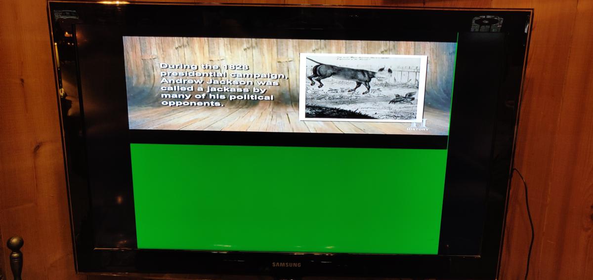

bmoses 9 Posted October 14, 2018 Posted October 14, 2018 My parents have a Roku stick. When they watch live TV SD channels the screen is split in 2 with the show on the top half and the bottom half being all green. See attached picture. If I change the quality down to 2 Mbps to force it to transcode it will play fine. Nexus player and other devices play the channels fine too.

speechles 2010 Posted October 15, 2018 Posted October 15, 2018 (edited) https://emby.media/community/index.php?/topic/60962-video-issues-when-trying-to-view-an-episode It is the same issue as the thread above. The stream has a funky SAR and the roku is using that to determine how to render the video. The display aspect ratio (DAR) is 4:3 at 720x480. But the SAR says it is 8:9, the sample aspect ratio. Usually this is 1:1, or if 16:9 content is shown in 4:3 it is 16:9, it usually isn't 8:9. Since it is 8:9, and 8 is half of 16. You see half the image, and green(the video representation of nothing) on the bottom half. I am sure this is a Roku bug, as it should be smart enough to work around a poor SAR and figure out the correct display aspect ratio without it. The Roku appears to depends on it for some reason. I will ask on Roku forums what is happening. This is sort of out-of-our-control without forcing a full transcode on the item. That would incur a penalty to you of eating your CPU % in use. If this is what we must do it can be done, but I want Roku to address this too, and give a reason their player works unlike many others on other platforms. https://forums.roku.com/viewtopic.php?f=34&t=122935&p=606812 Above is the URL to trace this issue back on Roku forums. I have let them know it is an issue. Edited October 15, 2018 by speechles 1

speechles 2010 Posted October 18, 2018 Posted October 18, 2018 The RokuTV get firmware updates last. They must be stable. The streaming stick and some others get updates.. if.. you manually update. When you manually update, you will possibly get firmware that has barely been beta tested. If you wait until the Roku automatically updates itself you will not suffer these issues. This is probably related to a firmware update on the Roku stick. Roku is aware of issues like these. The reason it didn't green screen before is the app was fully transcoding your video. Now the app knows it can stream copy it, and is doing so. But somewhere the Roku is messing up the delivery. Believe me, it isn't us. We don't want to transcode what should play directly. If Roku does nothing to address this we will figure something out to work around it. If that something is even an OSD button that looks like a wrench and all it does is force a full video transcode. @@Luke @@ebr what do you think?

bmoses 9 Posted November 26, 2018 Author Posted November 26, 2018 @speechles Apologies for the late reply to this! I was at my parents this weekend and was testing out the new setting, which works perfect btw, and while i was there i saw there was a system update for their Roku's. After applying the update the green screen issue went away! So it looks like roku fixed it and they no longer get the green screen even in the non-beta version of the app. thanks for your help on this!
