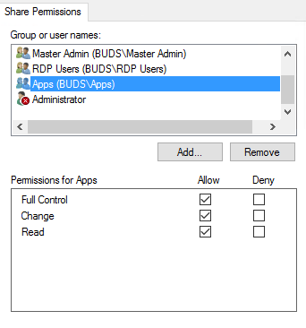

So I had emby setup and working for about a month or 2, all the media added and accessible, went and finally paid for the lifetime subscription and went to go log in and so some test, when I couldn't see any media, Started troubleshooting, found out that if I tried to add new media or modify the existing, that emby could not see the network essentially. Tried adding drive as mapped networking drive, ensured I could see the network shares, checked permissions for username ( which has full writes to the drives) checked networking settings across the board. I even went as far as to completely wipe it and re-install fresh, and tried it on a different pc and the pc that has the data, still cant see the network path. I work in IT tier2/tier3 so I know my way around and how to troubleshoot, but this issue has me perplexed.  Error is "There was an error adding the media path. Please ensure the path is valid and the Emby Server process has access to that location." when adding media to the library.

You need to make sure that the user account EMBY is running as has access to your shared drives.  Just because your use account has access to the shares does not mean that EMBY does.
Also you should not use Mapped Drive as they are unreliable.  You should use the UNC path instead.

I am saying that whatever user account that is running the EMBY service, needs to have access to those shared drives
If you login to the PC with the EMBY user account and try to access the drive via explorer: \\ip\sharename does it work? and can you read/write?
Okay, so yes then, the user account that has the emby server running on it, does have access to those shares with full permissions, and I can access/read/write to the shared drives with that account on the server its running on from within windows. Within Emby in the library section, when adding/editing media under folders + , it shows local drives and network. If I expand network its completely blank with no ... for  going back a level. if I manually type in the IP and wait or hit refresh its blank. if I manually type in the IP and hit enter, it shows it as added in the list, then when I hit save it gives me that error.

If you expand network and its blank, then the user account is not able to browse the network, since you are running on a domain there is any number of things that could be causing issues, Group Policy for example.
I suggest posting screen shots of what you are seeing, and server log for the same time period

See screen shots and log attachments, the order is a little off, but it should be, emby 1.png: emby network selected.png: emby ip.png: emby added.png: emby added error.png. I am not beyond letting you into my system to see if we can figure this out, I spent most of yesterday working on this.
