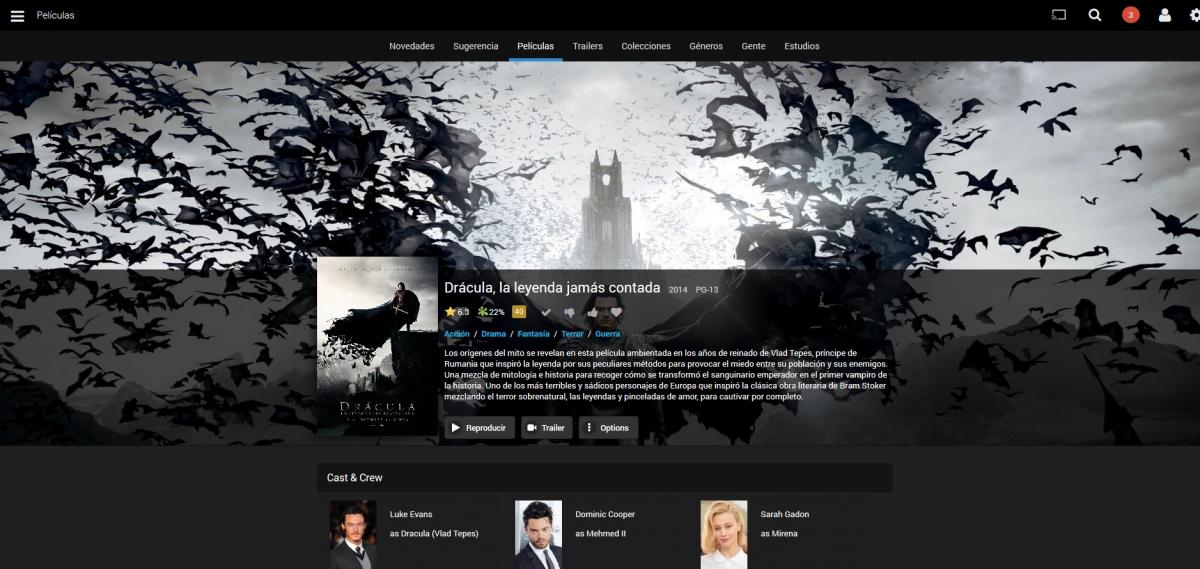

I installed MediaBrowser in openmediavault trougth its plugin, up here all right.
I created the library, movies, music and photo. I created the covers and sypnosis of the movies, everything perfect...but i can only play the photos, however the movies and music can not play it. It's the same in both the pc and my SmartTV Samsung.

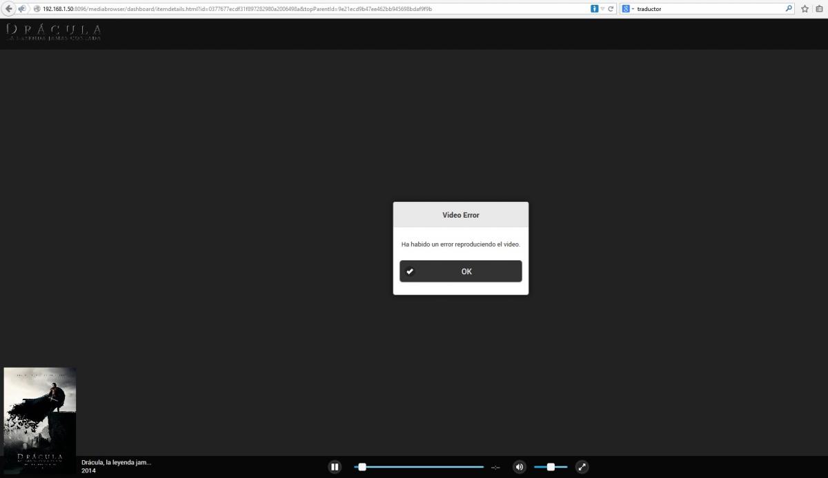

At the end I put pictures of what happens to me.
The error happens to me in firefox, and app samsung dlna.
In firefox I upload images.
In DLNA network error
Samsung App: "Unable to play None of the mediasources are playable"

2015-02-05 12:58:51.0162 Error - DtoUtils: ServiceBase<TRequest>::Service Exception
    *** Error Report ***
    Version: 3.0.5490.2
    Command line: /opt/mediabrowser/MediaBrowser.Server.Mono.exe -programdata /var/lib/mediabrowser
    Operating system: Unix 3.2.0.4
    Processor count: 1

2015-02-05 12:59:15.1207 Info - App: /var/lib/mediabrowser/ffmpeg/20140923/ffmpeg -fflags +genpts -i file:"/media/71486a89-fdb4-4e8f-b669-fee57a22bed4/disco2/peliculas/Dracula la leyenda jamas contada (HDRip) (Elitetorrent.net).avi" -sn -codec:v:0 libx264 -force_key_frames expr:gte(t,n_forced*5) -vf "scale=min(iw\,720):trunc(ow/dar/2)*2" -preset superfast -crf 23 -maxrate 872001 -bufsize 1744002 -vsync vfr -profile:v baseline -level 3 -map_metadata -1 -threads 0 -codec:a:0 aac -strict experimental -ac 2 -ab 128000 -af "aresample=async=1" -f mp4 -movflags frag_keyframe+empty_moov -y "/var/lib/mediabrowser/transcoding-temp/streaming/00b676d691f0e9a33ea61fc855062473.mp4"
2015-02-05 12:59:15.1931 Info - App: FFMpeg exited with code 132
2015-02-05 12:59:16.2810 Error - App: Error streaming media. The client has most likely disconnected or transcoding has failed.

Okay, you're not using MBC and it looks like you are on some flavor of Linux and you have some connectivity issues (I can see us not able to get out to the internet).  Not sure if those are related to your playback or not.
I'll move this over to the proper forum and see if someone has some ideas for you.

here it looks like a bad ffmpeg version somehow
2015-02-05 12:55:42.8349 Error - App: ffmpeg is missing encoder libx264
2015-02-05 12:55:42.8349 Error - App: ffmpeg is missing encoder libx265
2015-02-05 12:55:42.8349 Error - App: ffmpeg is missing encoder mpeg4
2015-02-05 12:55:42.8349 Error - App: ffmpeg is missing encoder msmpeg4
2015-02-05 12:55:42.8349 Error - App: ffmpeg is missing encoder libvpx
2015-02-05 12:55:42.8349 Error - App: ffmpeg is missing encoder aac
2015-02-05 12:55:42.8349 Error - App: ffmpeg is missing encoder ac3
2015-02-05 12:55:42.8349 Error - App: ffmpeg is missing encoder libmp3lame
2015-02-05 12:55:42.8349 Error - App: ffmpeg is missing encoder libvorbis
2015-02-05 12:55:42.8349 Error - App: ffmpeg is missing encoder srt
let's see if the update resolves it
Ohhhh no! still the same ... I upgraded to the latest Version 3.0.5518.1, and still the same, I can not play movies or music or videos. Os last command log to see if you can help me (looks perfectly with gedit, nano and windows with notepad ++, with notepad does not look good).
Thanks for your interest !!!
server-63558809800.txt
try restarting the server
I restarted the server, I turned off the nas (OMV), and still the same !!!
Please always post the log file, thanks.
but if i had to guess, ffmpeg doesn't have execute rights
I finally got something. I can play movies and music from nas to pc.
I have done these steps:
apt-get install w32codecs
apt-get install mplayer mencoder ffmpeg flvtool2
and "deb-multimedia-keyring" was installed
But in my Samsung smart TV app I get the not watch movies, I still leaving the message "Unable to play None of the mediasources are playable".
upload log
server-63558924900.txt
Fixed and running!
I deleted the app from Samsung and reinstalled the app, and all resolved. I see the movies in my SmartTV.
Nothing like being stubborn and not give up !!!
MediaBrowser Thanks to the team and his community for their support and interest !.
Thank you very much !!!
  • Like 1
