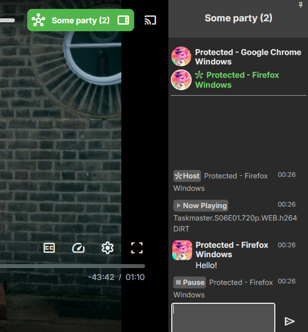

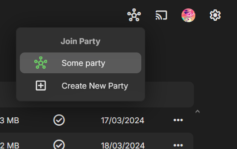

Protected 63 Posted October 23, 2024 Posted October 23, 2024 And in response to Drago's earlier question, I used a "room list" UI rather than an invite-based UI. Here are screenshots (spoilers, I guess): 1 1
