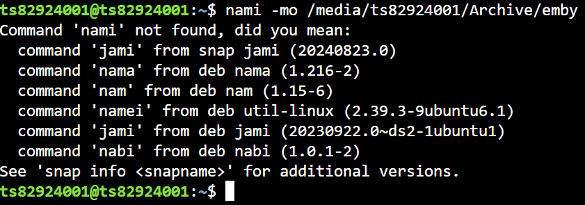

TMCsw 179 Posted September 26, 2024 Posted September 26, 2024 8 hours ago, PartlyCloudy said: https://pastebin.com/jeaY1ELm First please post screen shots directly here, not only is it allowed it’s encouraged. Next how is this drive mounted? /etc/fstab ? (preferred) Then what does this command show? nami -mo /media/ts82924001/Archive/emby

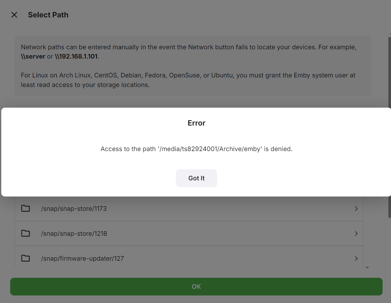

PartlyCloudy 1 Posted September 27, 2024 Author Posted September 27, 2024 (edited) 19 hours ago, TMCsw said: Next how is this drive mounted? /etc/fstab ? (preferred) /dev/sdb1 Also, it is a new error now, screenshot attached. emby has full rwx permissions as well. 19 hours ago, TMCsw said: Then what does this command show? nami -mo /media/ts82924001/Archive/emby It gives and error, screenshot attached. Edited September 27, 2024 by PartlyCloudy

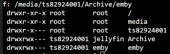

TMCsw 179 Posted September 27, 2024 Posted September 27, 2024 typo, i meant namei -mo /media/ts82924001/Archive/emby Is this a UBS drive?
PartlyCloudy 1 Posted September 28, 2024 Author Posted September 28, 2024 5 hours ago, TMCsw said: Is this a UBS drive? External HDD 5 hours ago, TMCsw said: namei -mo /media/ts82924001/Archive/emby The outcome of that is attached

Q-Droid 880 Posted September 28, 2024 Posted September 28, 2024 9 hours ago, PartlyCloudy said: What Linux distro? Only root can get to ts82924001. Permissions are needed for access on every directory along the path. chmod o+rx /media/ts82924001 /media/ts82924001/Archive
