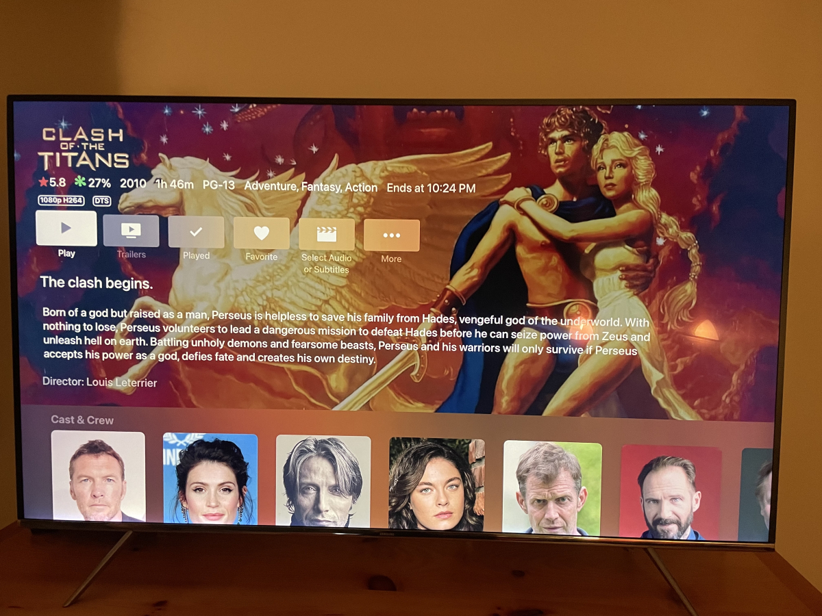

Hi,
Emby thinks my Clash of the Titans movie is the 1981 version by mistake:
IMG_7252.thumb.jpeg.7ff68ccf701a9c4864387049e3e7d745.jpegIMG_7251.thumb.jpeg.6121901bef93818a6d55dbd34046eb83.jpeg
It's the 2010 version though:image.thumb.png.1cf545d08fc5cd70f6b58cbe2a1f6ba7.pngh:
Anyone know how I can get it to load the correct metadata?
I'd prefer changing the actual MKV file as opposed to doing something within Emby server, that way if I ever have to wipe the metadata/upgrade servers/etc it will always load correctly.

@SynesthesiaBruhWould need to see the server log for when you imported the media but will guess do to naming scheme year was not utilized in the query.
What server version?
If 4.8 you can do Remove Identification on the item and ReIdentify.  If on earlier version just Identify with name and year or providerid.

Put the year in brackets - as per the emby naming standard. ie Clash of the Titans (2010) 1080p.mkv
https://emby.media/support/articles/Movie-Naming.html#naming-your-media
Failing that (unlikely) you can also put the tmdbid directly in the filename with square brackets ie [tmdbid=18823]
https://emby.media/support/articles/Movie-Naming.html#id-tags-in-folder--file-names
Yea I'd like to see the server log from when this was imported because even though the year in parentheses is recommended, your naming should have been fine. Thanks.

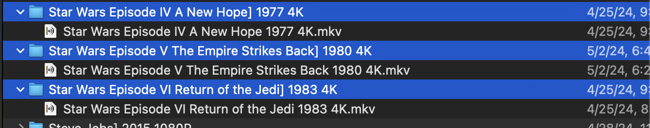

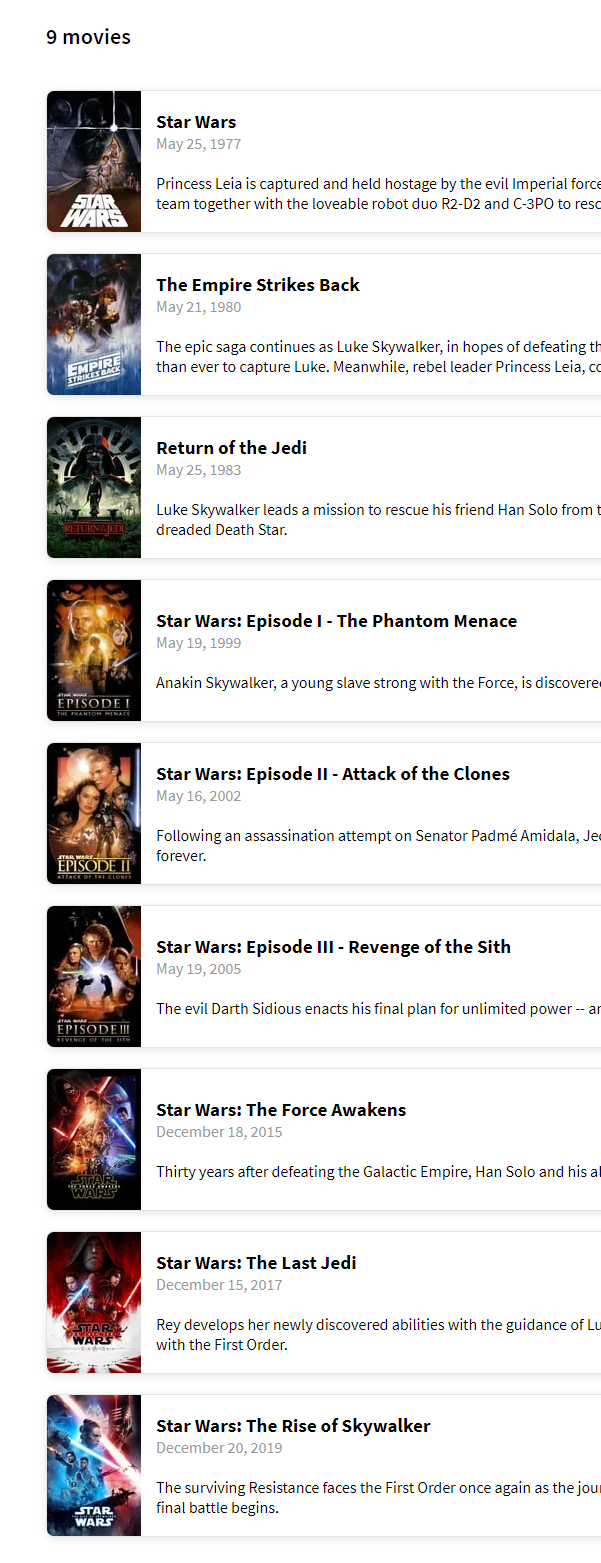

2: I have 3 star wars films, Episodes 4, 5, and 6 [1997, 1980, 1983]. If I search "Star Wars" only the first movie comes up:
Now I can search for the other 2 episodes but not if I search "Star Wars", I need to search "The Empire Strikes Back" or "Return of the Jedi".
Oddly, if I search "A New Hope" the 4th episode doesn't come up as a search item lol.
Here's how the movies are organized in my library: Screenshot2024-04-30at9_06_14PM.png.f3b976500fc8fae92c8b3a9720034a9f.png

Also, Clash of the Titans is still popping up as the old version, but this is definitely the remake:
Let me know if you need anything.

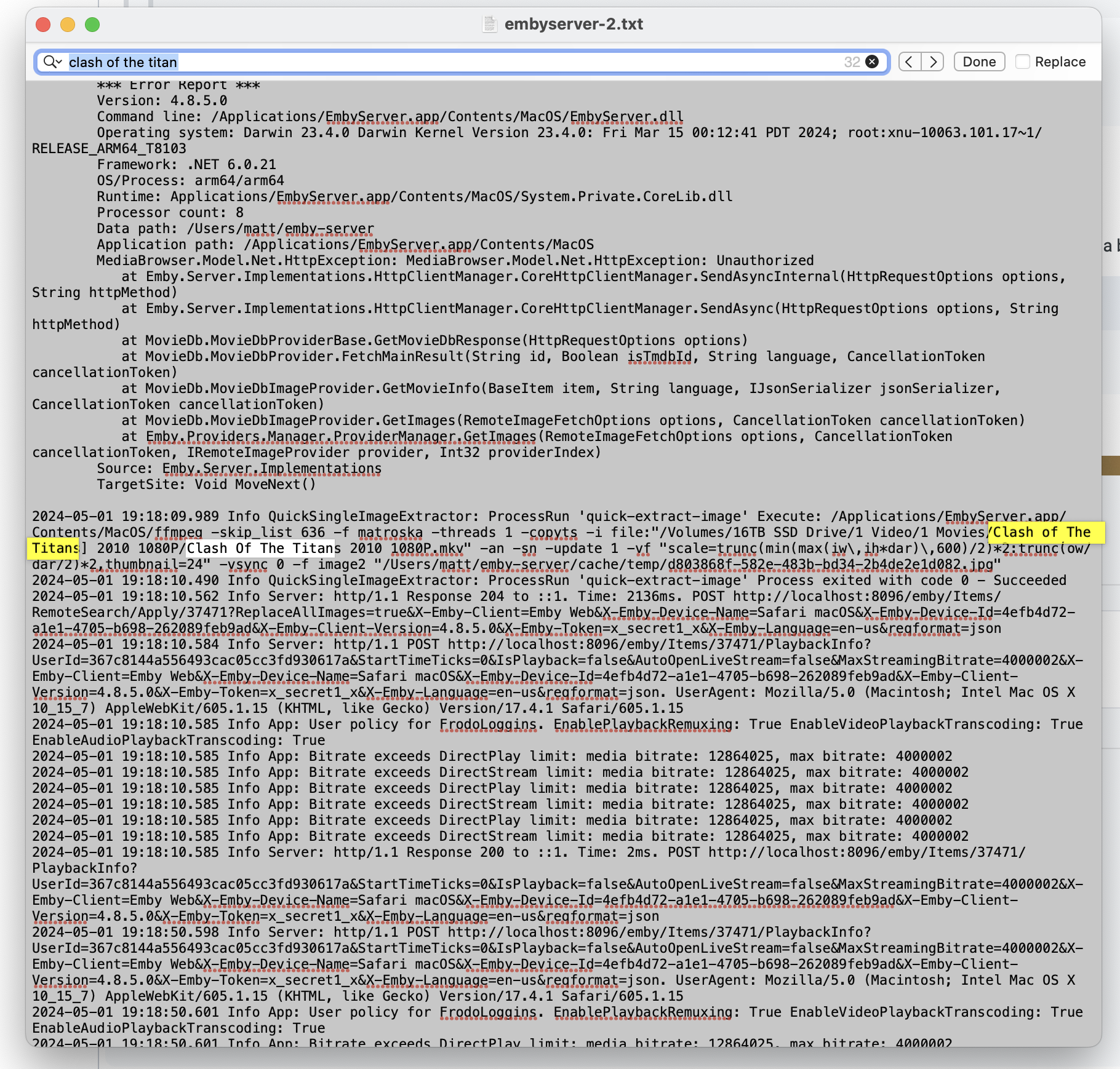

As for Clash of the Titans I don't see it in the log.
ALRIGHT I renamed the Austin Powers movies/folders like an adult this time and now both movies show up 100% fine.
As for Clash of the Titans: Idk, I'm watching it right now lol. Must be in there. I uploaded a new server log if you're curious but not a big deal anymore.
This is a bit above my pay grade but the name at least appears now:
21 hours ago, Luke said:
@SynesthesiaBruhplease try using the Identify feature on these titles and see if that helps.

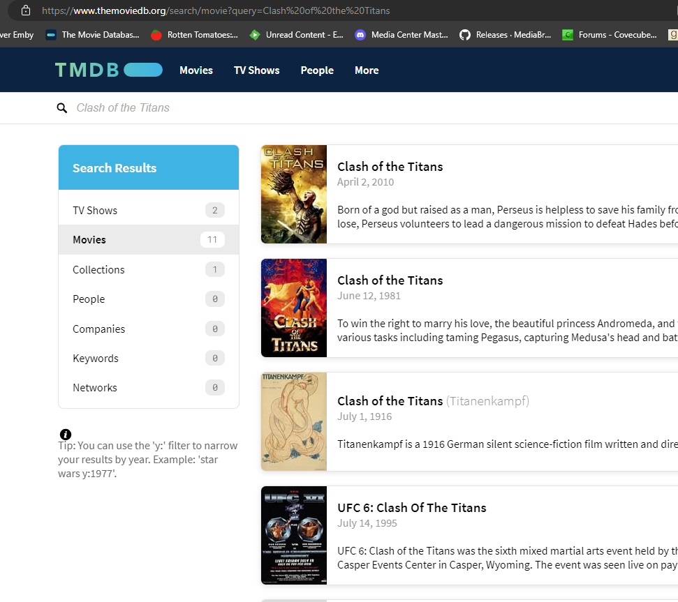

Alright I used the identify feature for Clash of the Titans. The cover art looks good:
And the correct cast is shown, but the background image is still the same. Refreshed metadata but it's still wrong:
I don't mean to be pedantic, but is it possible to get the correct metadata to show up without using the identify feature? If you need anything just let me know.
As for Star Wars: Is there anything I can do to get all movies to show up when searching "Star Wars" or have episode 4 show up when searching "A New Hope"?
embyserver-2.txt
Can you try the Identify feature again? You had some outgoing requests to the moviedb api fail, which is likely the root of your problems. Hopefully it was just a temporary blip. If you're using a vpn, try turning it off.

SynesthesiaBruh

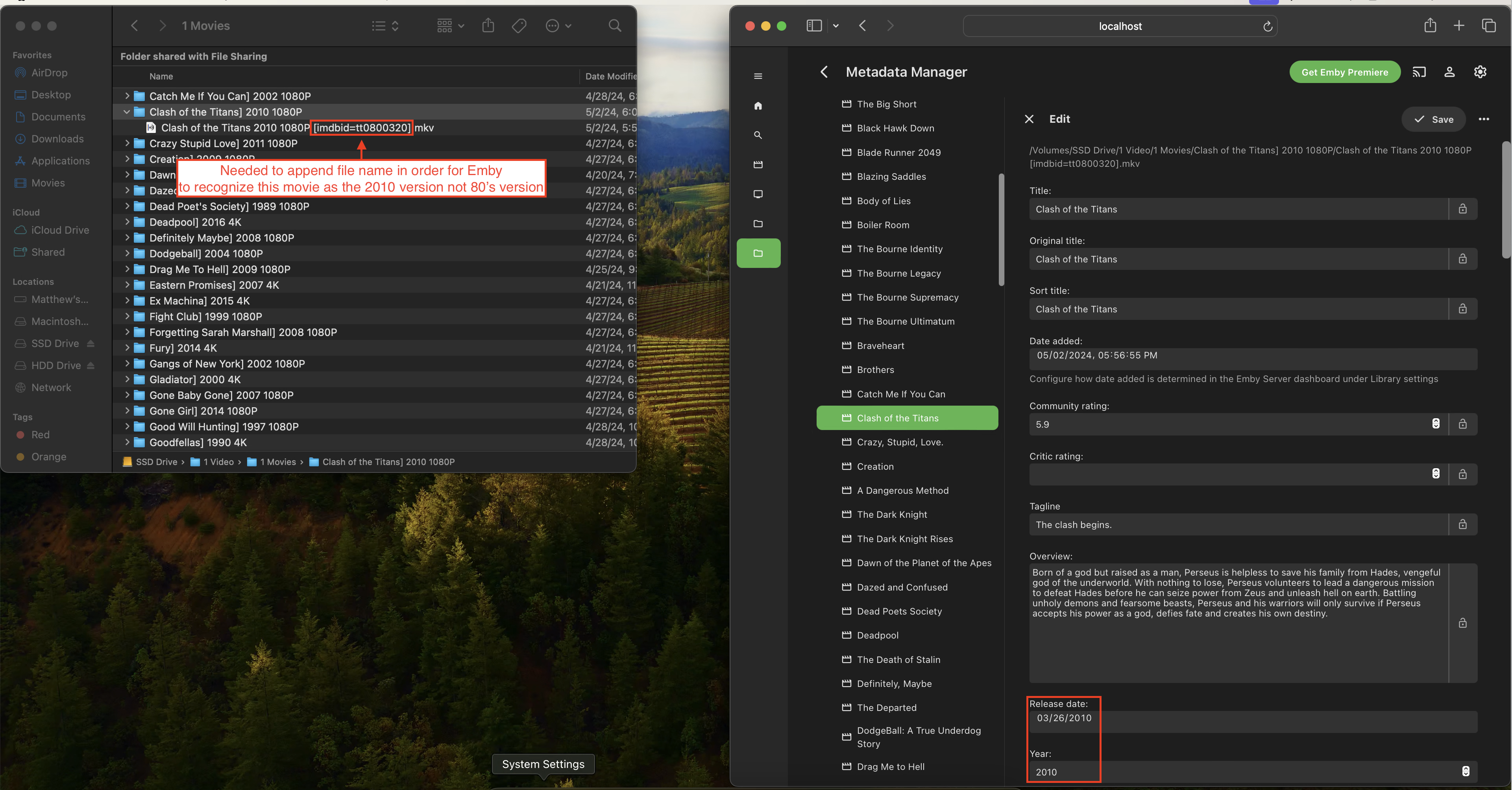

Ok I added the tmdbid ID to the end of the file name like rbjtech suggested and now Clash of the Titans is all good.
I'm pretty sure that was just caused by me being an idiot and entering an IMDB link instead of it's ID...

So now the only thing left: Do you know how I can populate the search results with all Star Wars movies I have just by typing "Star Wars" instead of the name of the episode?
It needs to be part of the title or original title in order to show up in search results.

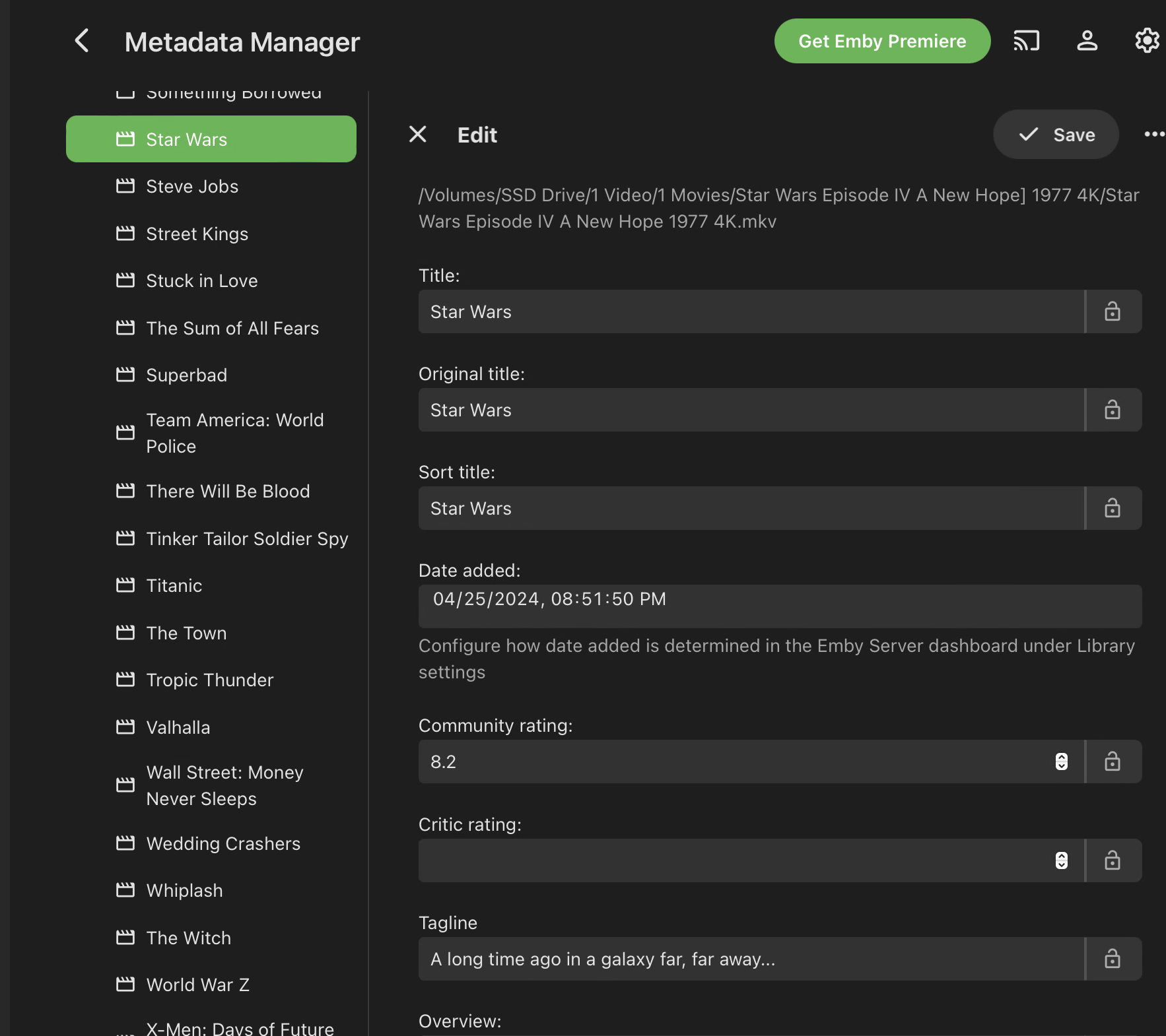

SynesthesiaBruh
Thanks so I have "Star Wars" in both the folder names and the titles:
And not just in the file's name but the "main titles" as well:image.thumb.png.3bea5955d187be25dd4d2d10ae2df74a.png
Any ideas?
HI, yes but what's important is the title and/or original title in Emby Server.
Happy2Play
Any ideas?
Will require your manual metadata changes after Identification as you cannot query sites with modified names and get positive results and if they are correct the provider will provide original title via metadata.
Renamed via metadata
  • Like 1

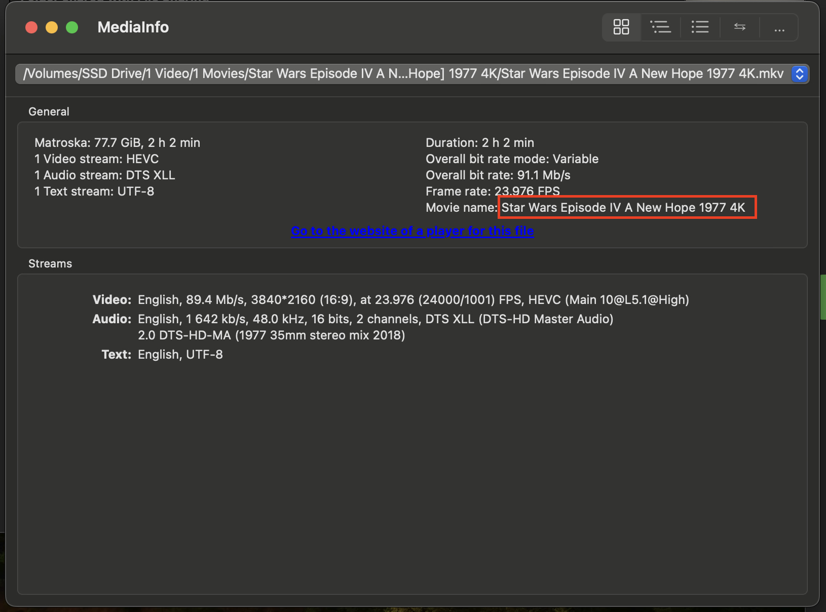

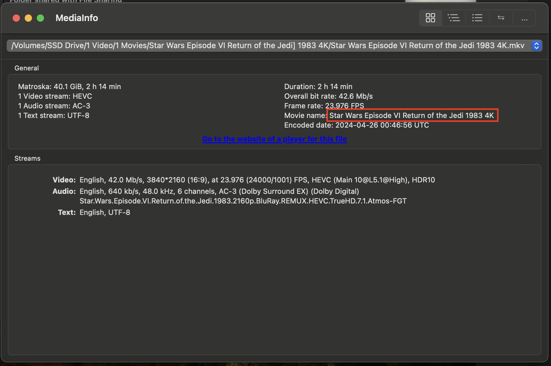

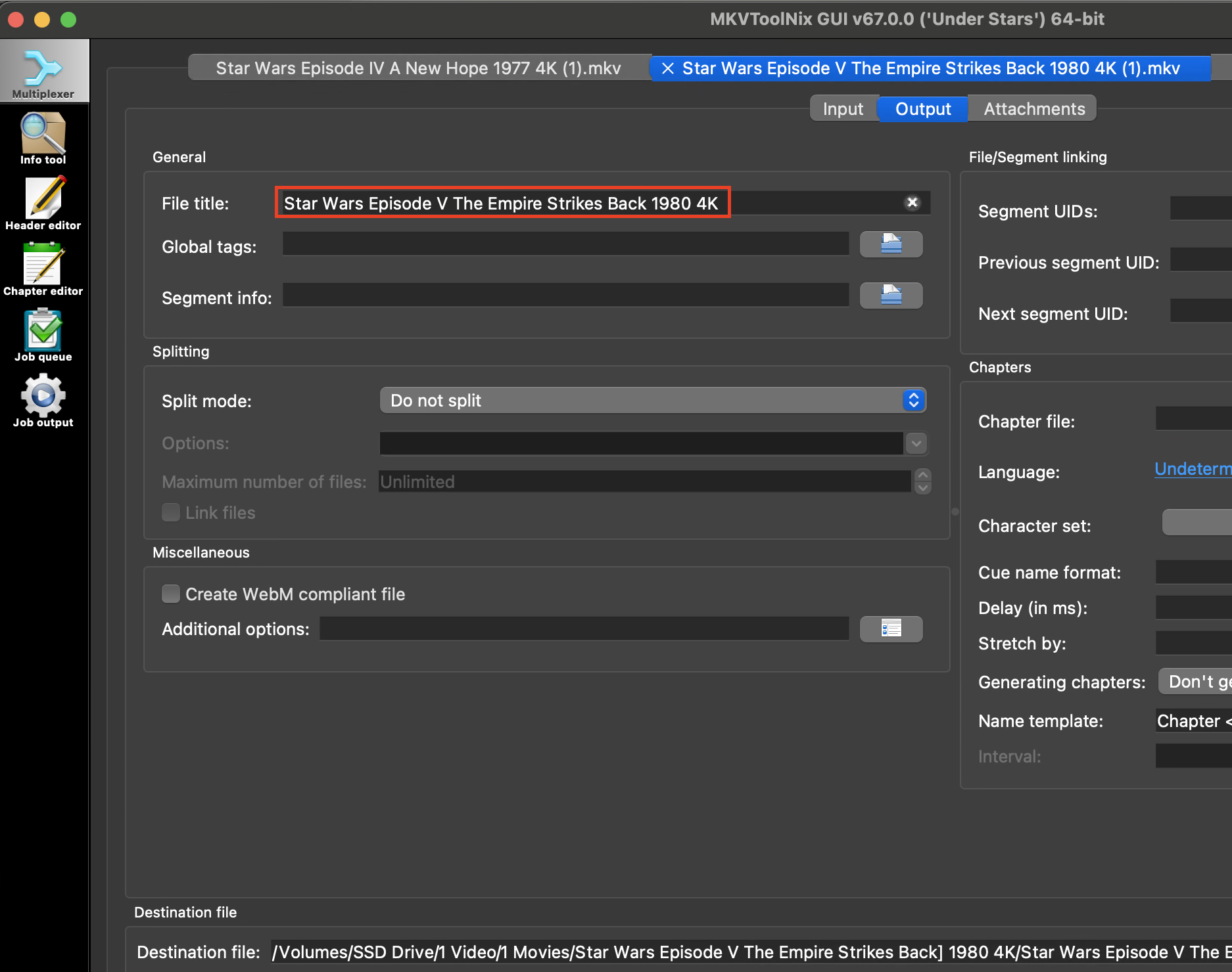

Hi,
Sorry. Thank you. OK SO. What website is your first screenshot from?

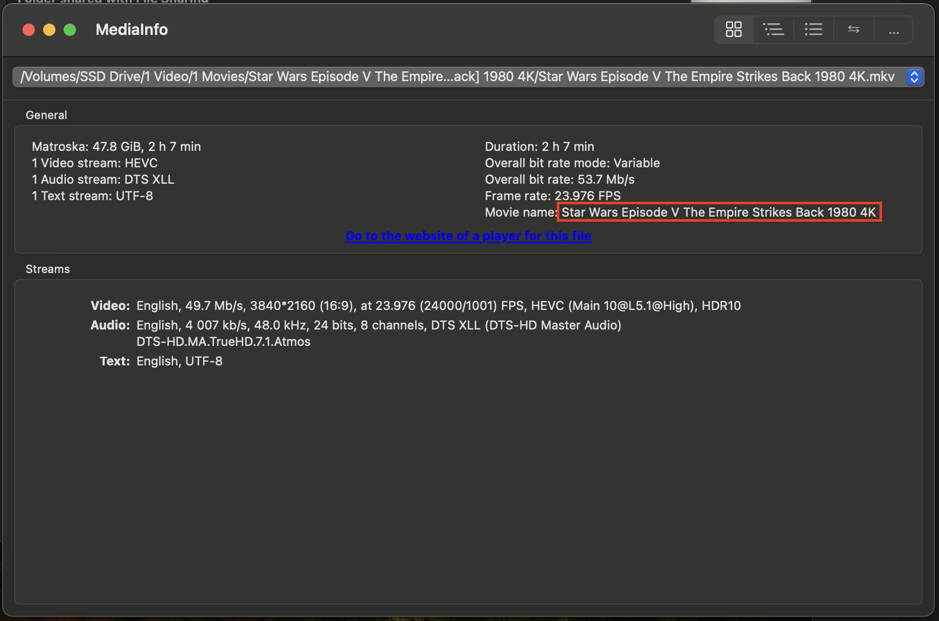

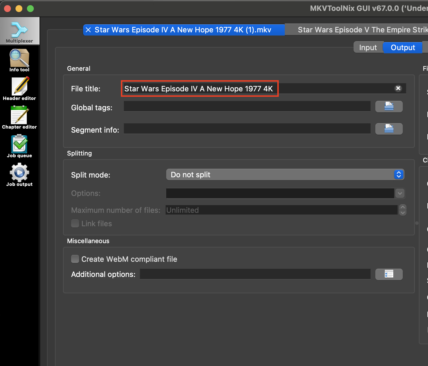

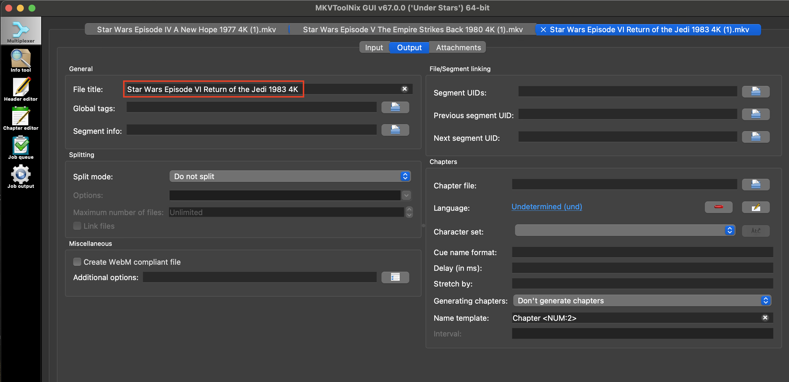

Now if I understand you correctly, yes I did rename all 3 Star Wars films in MKVToolNix [Output tab > General section > File Title: field]. But what website is Emmy quering to?
Below are my 3 Star Wars movies. I named them whatever IMDB had them as [other than the colon as I can't name files with a colon in MacOS]. I'm assuming that's fine?:
1.thumb.png.85f80af7cdff441eb32d456577c17a42.png2.thumb.png.62f64e78422a08362aa28ec8da032f84.png3.thumb.png.b9f7edbc8259a51dcd2faa31d0e61a6e.png
2C.thumb.png.49a32a3e88756efd263500c46abc163e.png2B.thumb.png.6998348931380c4ab51ae4599d818fe5.png1B.thumb.png.f959cf6b1e49fe656df6d2410917f386.png

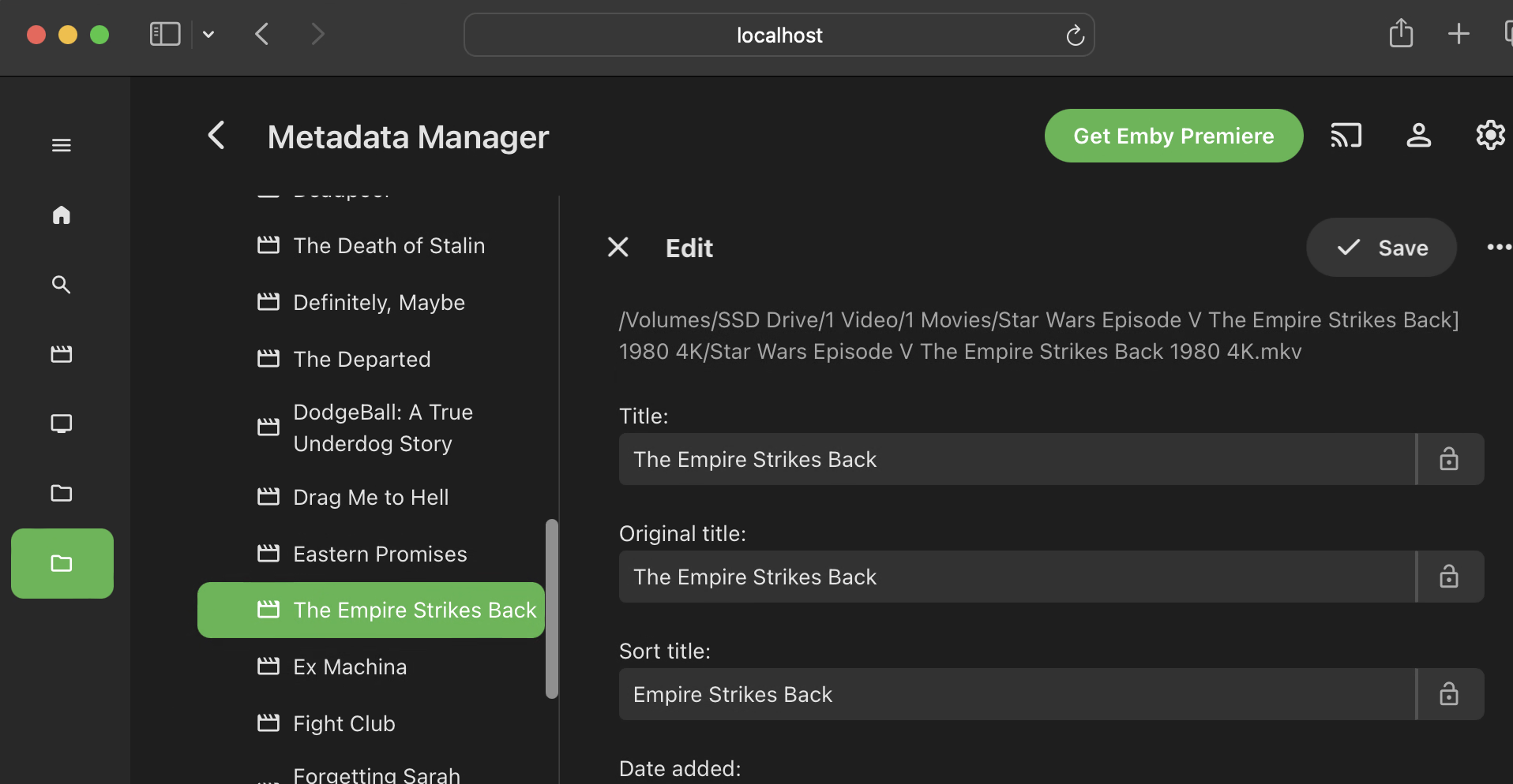

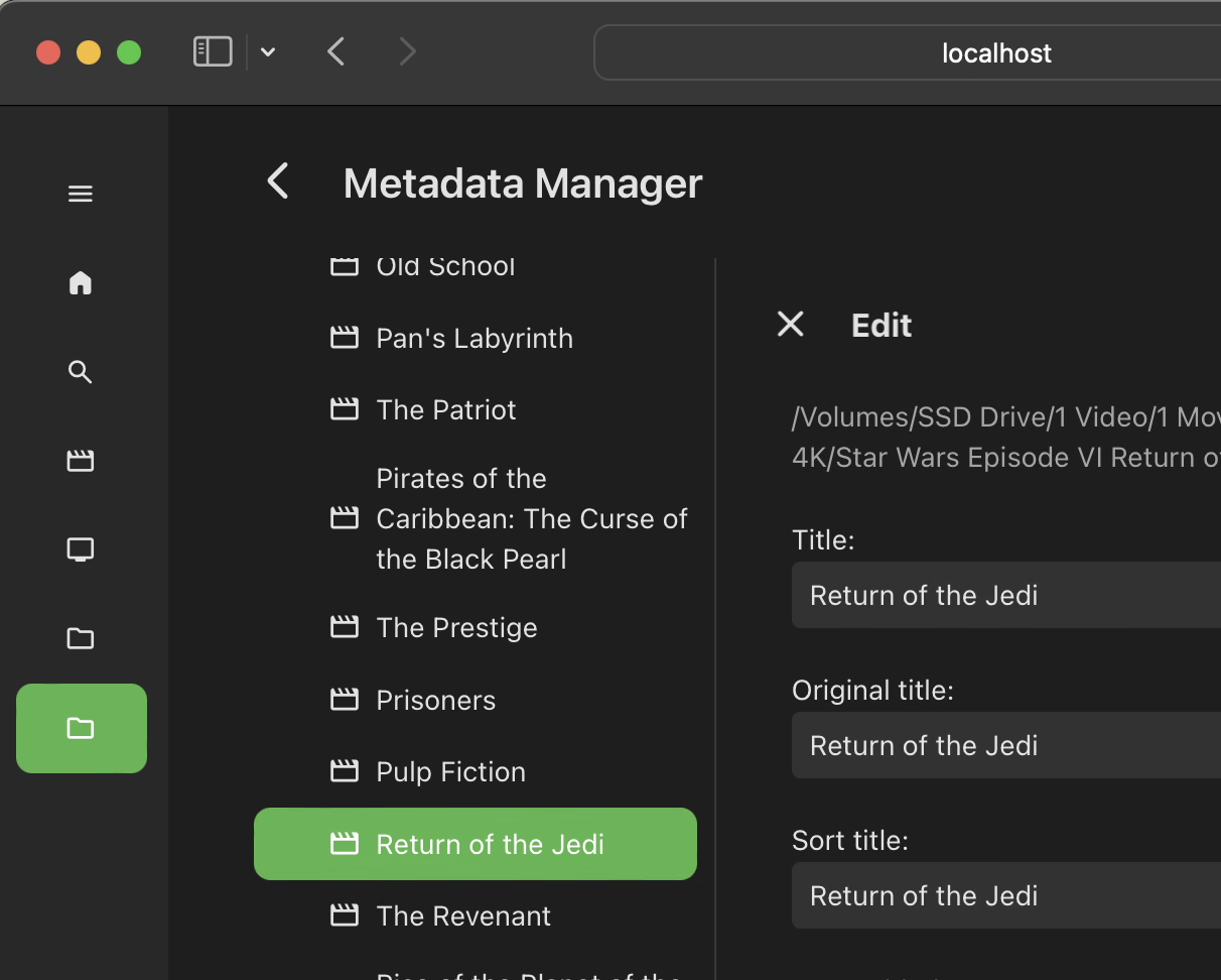

BUT in Emby's metadata manager the titles are different:
3A.thumb.png.63d5d07001f239d475533267471b6a87.png2A.thumb.png.ead65c9da65f535e3410e356464726ea.png1A.thumb.png.8b0d64fb5032cf6b8012c18cc05626fd.png
I'm assuming I'm doing something wrong but can't figure out what. How can I stop Emby from changing the names?
It is TMDB.  Note title will be whatever the provide site has as filename is really irrelevant.  So is the embedded title.  Sure there is a library option but only applies if no internet metadata id found.
Prefer embedded titles over filenames
This determines the default display title when no internet metadata or local metadata is available.
TMDB
So you have to manually manipulate the metadata Title to your liking.
Edited by Happy2Play
  • Like 1
SynesthesiaBruh
TMDB
ARE YOU SERIOUS?!?!?! Why would they do that lol?! The 4th film is just Star Wars even though that's not the full name lol and then they named the 5th/6th by their episode, and then finally after 1999 they decided to just name them correctly? Any idea why that's so disjointed? I'm sure there's a reason?
Also... If I search Clash of the Titans on TMDB nothing comes up... Not the 80s version or the remake....
WHAT?!
SynesthesiaBruh
I smoke too much weed. So if I do the trick where I add the IMDB ID to the file's title for all my Star Wars films that will bypass TMDB and it's smooth sailing?
Happy2Play
Have no ideas as I get 11 movies
Happy2Play
Maybe as you are dependent of what providers you have enabled on the library and the provider site having the IMDBid for the media.  But in general yes.
Happy2Play
Note it would be folder naming as filenaming is not used as all.
Star Wars (1977) {tmdbid=11}\asdflkjaldfj.mkv will get Star Wars.
SynesthesiaBruh
Like I said, I smoke too much weed...
If moviedb is your highest priority metadata fetcher then I would put the Tmdb id into the filename, not the imdb id.
