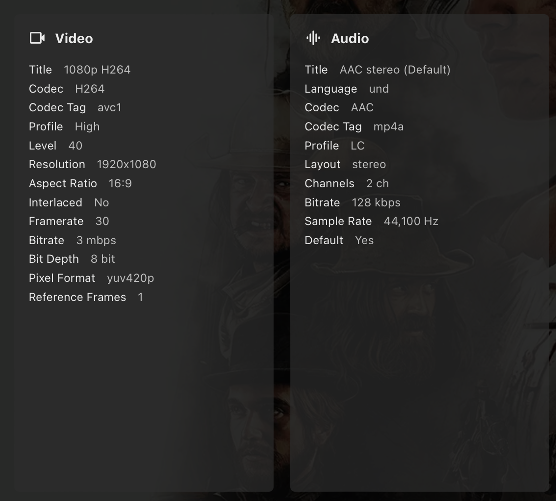

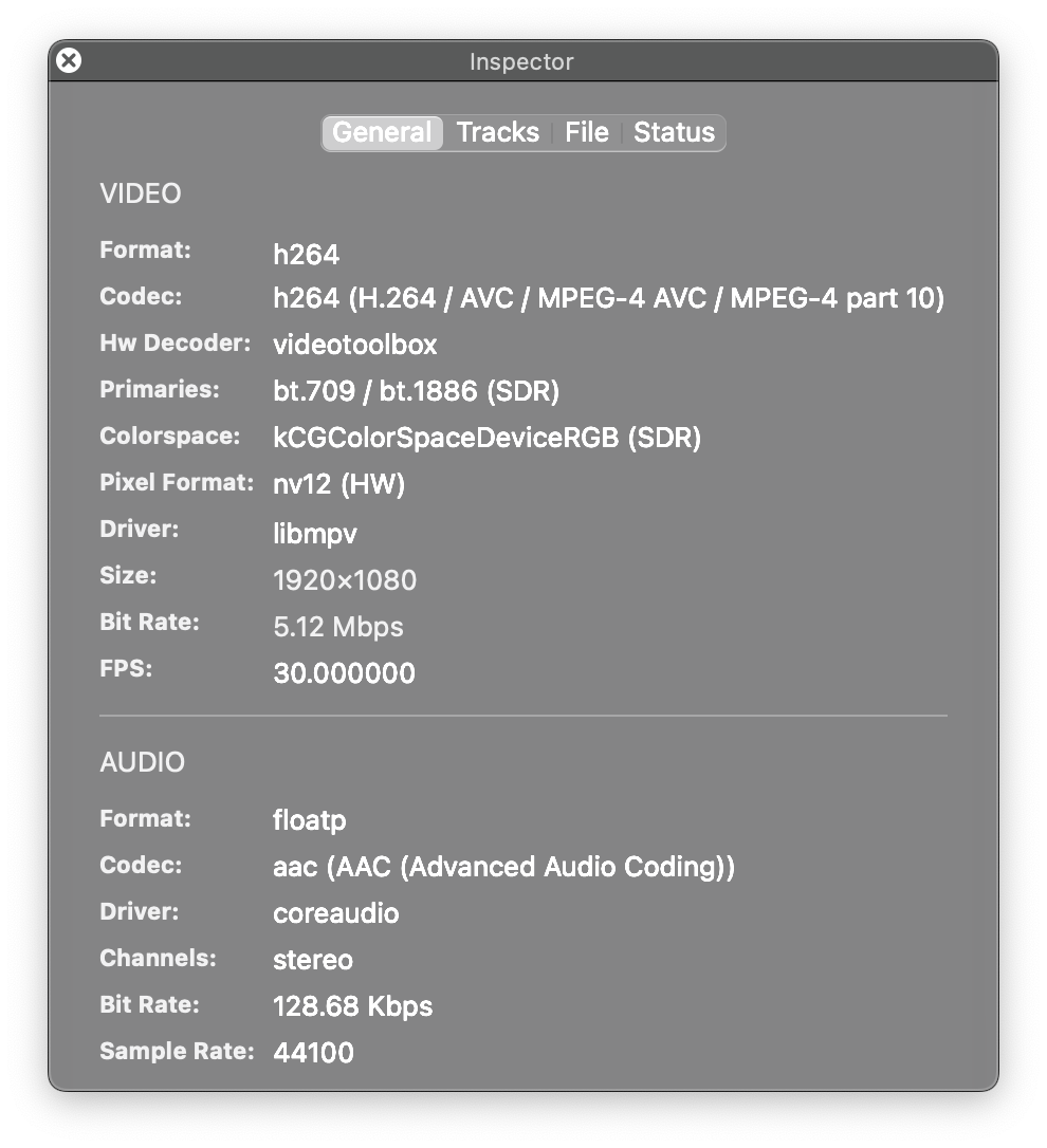

zaHrecsohbiw 13 Posted July 4, 2024 Posted July 4, 2024 I think this is still on-topic (apologies if not), but tying my two posts together, it would seem beneficial to have the ability to force transcoding, even in cases where a file meets the criteria for using the native player. This is a file that both my Apple TV (via Emby) as well as QuickTime Player on my Mac struggle mightily to play. In both cases, they have failed to play it at all, played it with stutters, played it with no audio, etc. If I load the same file with IINA, it plays just fine (using videotoolbox no less, and libmpv), and it seems to play just fine when I set the preferred player in the Emby Apple TV app to MPV. I'm pre-apologizing in case the uploaded images appear very large in my post.
Luke 40018 Posted July 6, 2024 Posted July 6, 2024 On 7/4/2024 at 5:44 PM, zaHrecsohbiw said: I think this is still on-topic (apologies if not), but tying my two posts together, it would seem beneficial to have the ability to force transcoding, even in cases where a file meets the criteria for using the native player. This is a file that both my Apple TV (via Emby) as well as QuickTime Player on my Mac struggle mightily to play. In both cases, they have failed to play it at all, played it with stutters, played it with no audio, etc. If I load the same file with IINA, it plays just fine (using videotoolbox no less, and libmpv), and it seems to play just fine when I set the preferred player in the Emby Apple TV app to MPV. I'm pre-apologizing in case the uploaded images appear very large in my post. HI, when it outright fails, what exactly happens? That should trigger a failure and the app will automatically switch to server transcoding. Let's start with that and see if we can get that one worked out.
