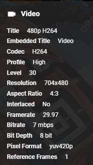

Skopin 9 Posted September 30, 2023 Share Posted September 30, 2023 (edited) I'm having an issue with a show playing in the wrong aspect ratio. The show is 4:3, and that is what the metadata shows when viewing it both in MediaInfo and in Emby. But when it actually plays, it is stretching it horizontally to 3:2. I've tried switching the aspect ratio in the player, but the only options are Auto, Cover, and Fill, and none of them change anything. Looking at the file in MediaInfo, there are two aspect ratios, DAR, and original DAR. The Emby player seems to be reading the original DAR with no way to change it to what it should actually be displaying. I've tried using MKVToolNix to change the aspect ratio, but there does not seem to be any way to remove the original DAR. Here is what the video looks like in Emby Here is what it looks like when viewing in MPC-HC in the correct aspect ratio This is what the metadata shows in Emby And here is the MediaInfo for the file Edited September 30, 2023 by Skopin Link to comment Share on other sites More sharing options...

generiq 113 Posted October 12, 2023 Share Posted October 12, 2023 I've compared the played frame sizes in VLC, mpv standalone and Theater. They all match, and are correct. So here's the discrepancy. If you look at the headers in mkvtoolnix, you'll see 704x480 and 704x528. If you calculate them out, 704/528=1.33 (4x3) this is correct. 704/480=1.46. 3:2 ratio equates to 1.5. Which is very close to 704/480. And if you drop it into handbrake, it reads as 704x442. If you alter the dimensions in handbrake's configuration and recode, which eliminates the 3:2 original ratio, play it and overlay each player, they all match. I suspect that what you think is correct is actually incorrect. I'll attach the handbrake reencode, so you can see what I mean. Link to comment Share on other sites More sharing options...

Solution generiq 113 Posted October 12, 2023 Solution Share Posted October 12, 2023 Interestingly, when played in the Windows player, it's stretched. Are you using the Theater from the Windows store or download from the Emby website? You should be using the download from the Emby site. https://emby.media/emby-theater.html 1 Link to comment Share on other sites More sharing options...
generiq 113 Posted October 12, 2023 Share Posted October 12, 2023 (edited) And the file I corrected in handbrake plays correctly in the Windows player. So it would appear that the Windows player gets it wrong. Edited October 12, 2023 by generiq Link to comment Share on other sites More sharing options...
Skopin 9 Posted October 12, 2023 Author Share Posted October 12, 2023 8 hours ago, generiq said: Interestingly, when played in the Windows player, it's stretched. Are you using the Theater from the Windows store or download from the Emby website? You should be using the download from the Emby site. https://emby.media/emby-theater.html This resolved the issue. I was using the Windows Store version. The installer version works as expected. Thanks for your help! I really didn't want to have to reencode all of those episodes. 1 1 Link to comment Share on other sites More sharing options...
