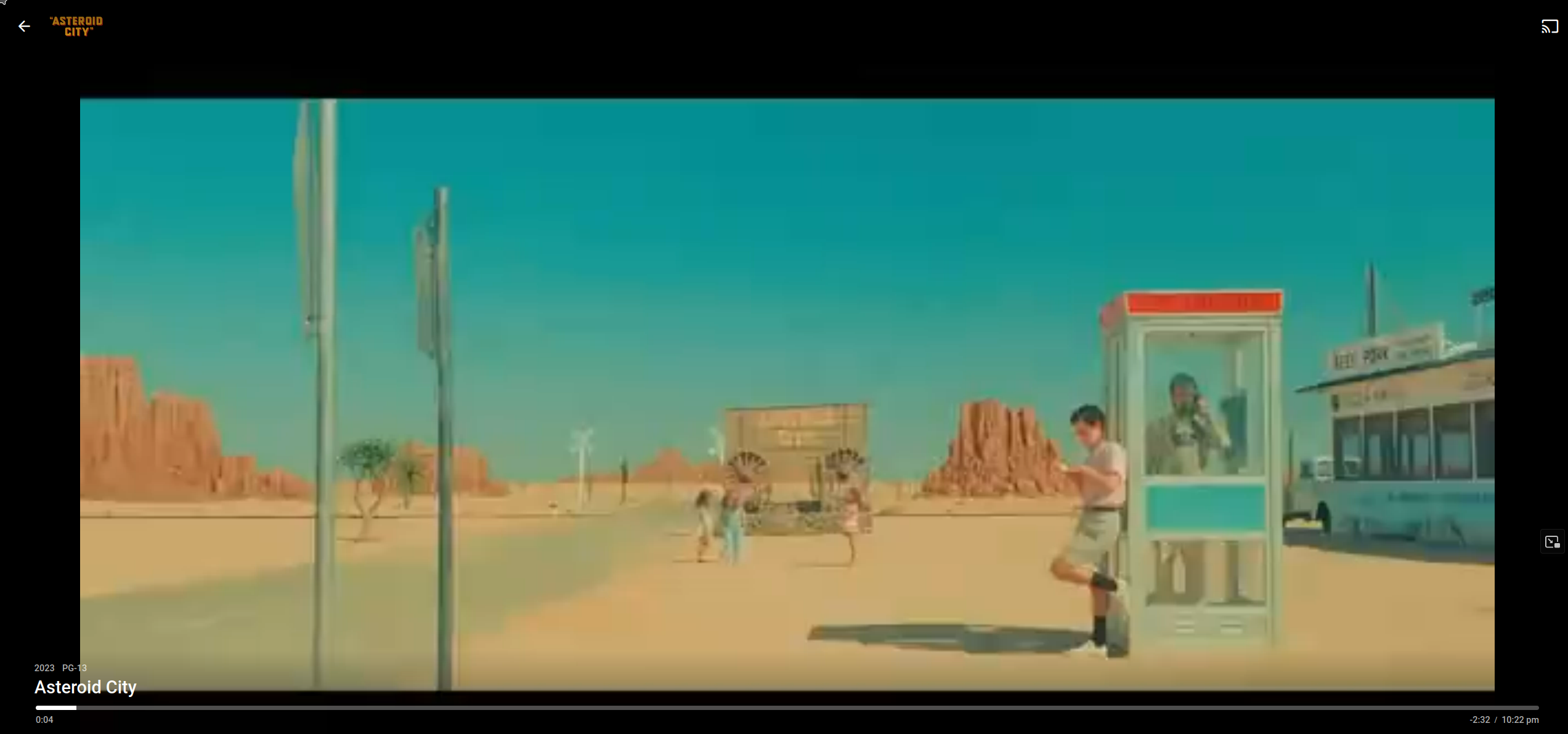

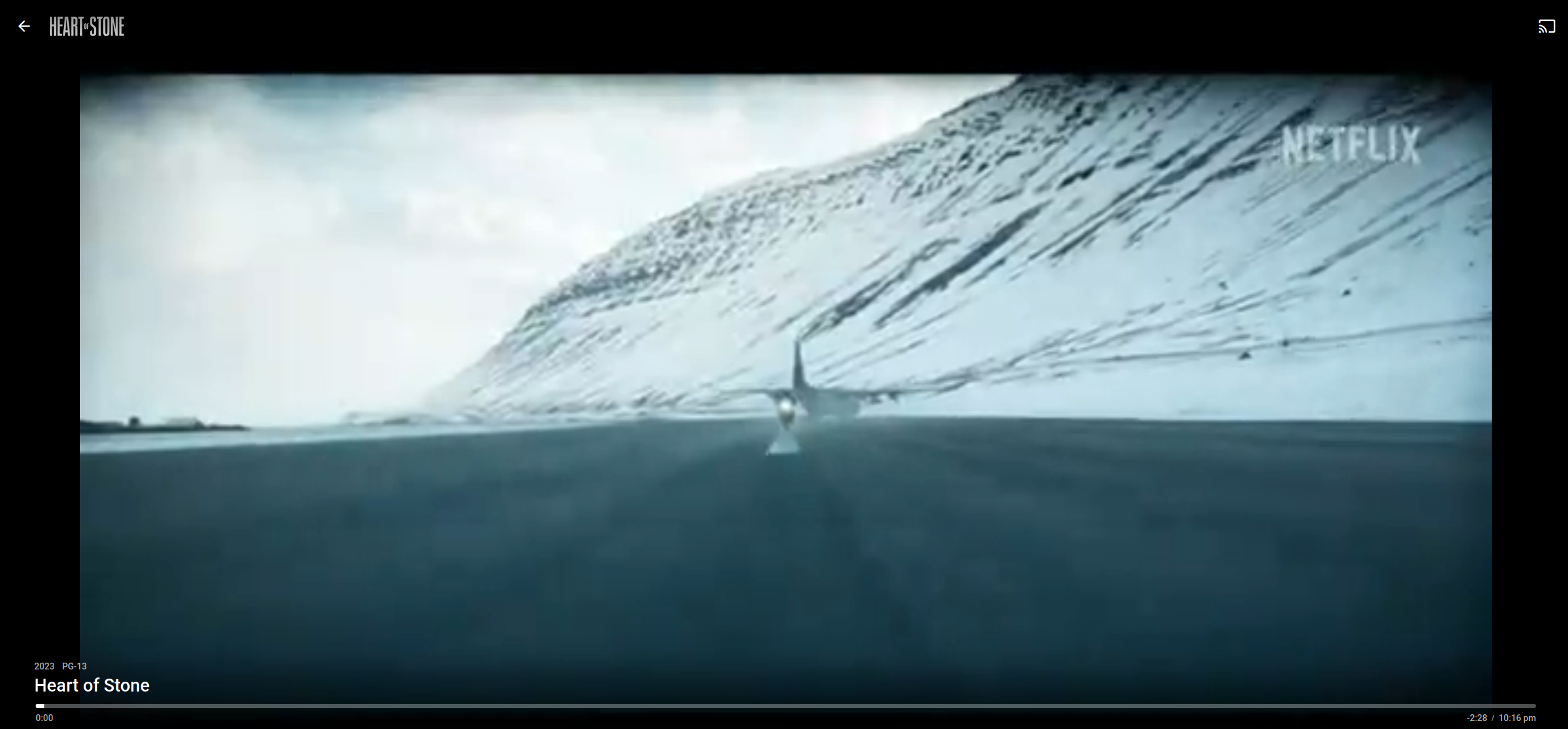

revan415 1 Posted December 13, 2023 Share Posted December 13, 2023 Honestly, emby should take this off the marketing site. It shouldn’t be advertised in the current state. I also purchased a premier license and this was a motivating factor, but these trailers are not watchable. If there is no solution, it shouldn’t be a feature. If manual trailer videos is the only solution, it should be clearly stated in the marketing info about the feature. I.e. “Trailers like the movies! (Downloading trailer content required)” Great server streaming platform with a ton of great features, this is a small blemish, but one all the same. 1 Link to comment Share on other sites More sharing options...

r32nj 1 Posted December 13, 2023 Share Posted December 13, 2023 When I setup trailers about a year ago they seemed to be of decent quality. Recently they started being basically unwatchable (480 or less) so I turned off the trailers altogether. It would be nice to be able to watch high quality trailers with the same level of setup as what was working before. Link to comment Share on other sites More sharing options...

Stroudy 13 Posted January 20 Share Posted January 20 The YouTube trailers do look trash on my Android TV (Google TV). But they look really good quality on my phone (Pixel 7 Pro). No idea why YouTube decides that 1 should have good quality and the other should have bad? Link to comment Share on other sites More sharing options...
