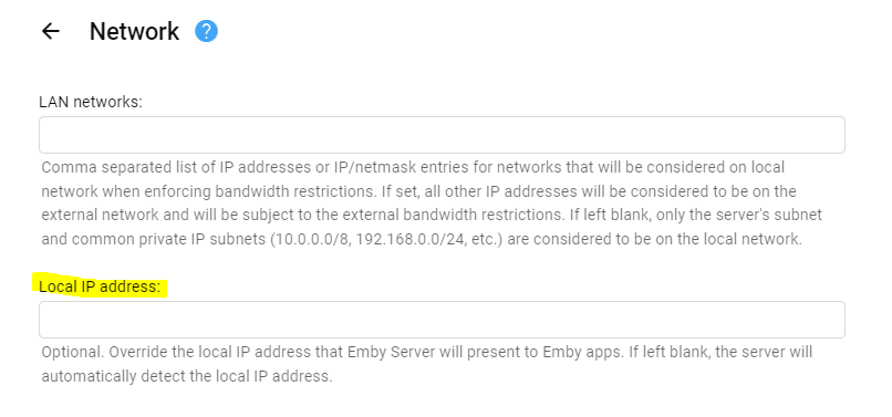

ebr 15667 Posted September 8, 2023 Posted September 8, 2023 Hi. Have you checked to see if there is something (like a space) entered in this field?
Carlo 4552 Posted September 14, 2023 Posted September 14, 2023 @akarshjaiswal In the field shown above in ebr's post have you set this to 192.168.1.42 then restarted Emby Server? @GrimReaperalso asked you some very valid questions above that we need answers to if you are still having an issue. Forget about Emby Connect for right now as we want to keep diagnosing the issue as simple as possible. Carlo 1
