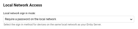

Luke 37119 Posted May 17, 2023 Share Posted May 17, 2023 How did you configure their password options? Link to comment Share on other sites More sharing options...
Erdrick 1 Posted May 17, 2023 Author Share Posted May 17, 2023 (edited) Below is the only password option I see. Users are connecting from the WAN side of the network, via a URL, not an IP address. Although, that shouldn't have anything to do with this issue. Edited May 17, 2023 by Erdrick Link to comment Share on other sites More sharing options...

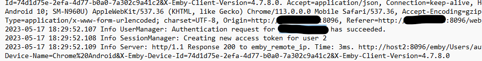

Luke 37119 Posted May 17, 2023 Share Posted May 17, 2023 OK please attach the emby server log from a failed attempt. Perhaps I'll be able to spot something there. How to Report a Problem Thanks. Link to comment Share on other sites More sharing options...
Erdrick 1 Posted May 17, 2023 Author Share Posted May 17, 2023 I can see in the log, it says "user is not allowed to access" from this device. Link to comment Share on other sites More sharing options...
Erdrick 1 Posted May 17, 2023 Author Share Posted May 17, 2023 Here is where it allows me to log in, after I enable server management. Link to comment Share on other sites More sharing options...
Luke 37119 Posted May 17, 2023 Share Posted May 17, 2023 OK so you must have configured user device access. Try undoing that and granting them access to all devices. The reason why it's working when they are admins is because admins are excluded from that filter. Link to comment Share on other sites More sharing options...
