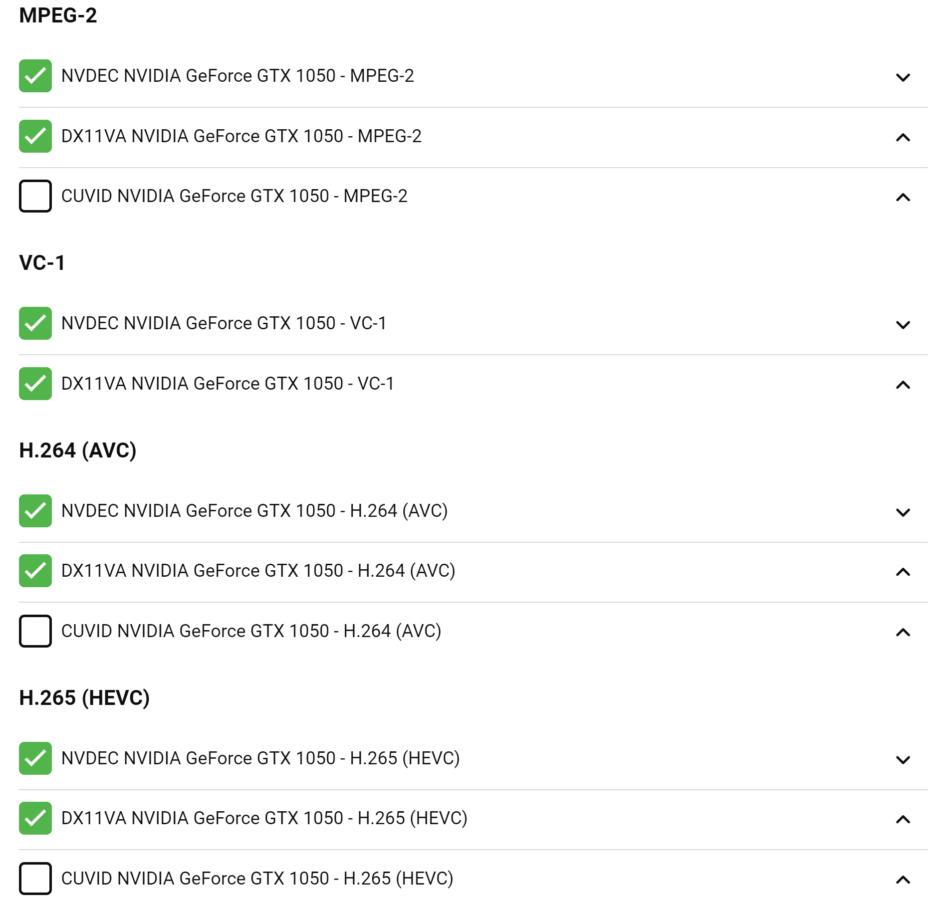

hotwill 3 Posted March 13, 2023 Author Posted March 13, 2023 11 hours ago, softworkz said: Thanks. The detection log _does_ show the cuvid decoders. Can you please go to the dashboard "Transcoding" page and set HW acceleration to "Advanced" and see whether the CUVID decoders are listed there? What's the meaning of "The detection log _does_ show the cuvid decoders"? @softworkz Here is the "Advanced" page:

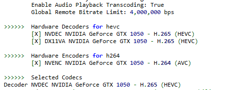

softworkz 4570 Posted March 13, 2023 Posted March 13, 2023 4 minutes ago, hotwill said: What's the meaning of "The detection log _does_ show the cuvid decoders" They weren't visible in the hw decoders list in the log: Can you try with the HEVC CUVID decoder? (check box and move to top)
hotwill 3 Posted March 14, 2023 Author Posted March 14, 2023 On 3/13/2023 at 3:31 PM, softworkz said: They weren't visible in the hw decoders list in the log: Can you try with the HEVC CUVID decoder? (check box and move to top) HEVC CUVID decoder works fine. Why CUVID works fine but NVDEC does not?
softworkz 4570 Posted March 14, 2023 Posted March 14, 2023 43 minutes ago, hotwill said: HEVC CUVID decoder works fine. Why CUVID works fine but NVDEC does not? We haven't been able to identify a clear pattern. In most cases, both are working, but sometimes only one of them. That's why we're even having both as option. Sorry for the inconvenience.
