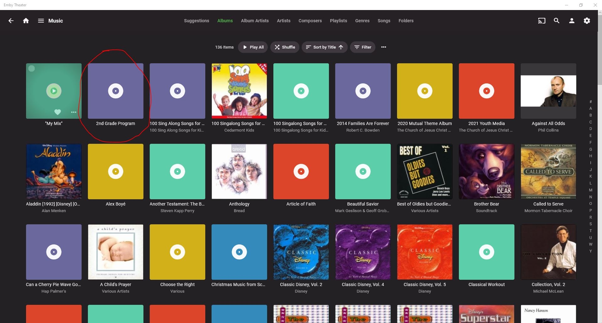

PryorFamily 0 Posted October 22, 2021 Posted October 22, 2021 I have had this problem for a while. But I finally figured out something consistent with all of them. They are all in the same Artist folder in my Library. The folder is called Unknown Artist (artifact from windows media player). Whenever I open the album in Android, Emby Theater, or iOS (oddly enough they work if I use the web app) I have tried Scanning Library Files, moving one of the album folders to a different folder and embyserver.txtchanging some metadata but nothing fixes the problem. See attached log and screenshot of when I open one of these albums

PryorFamily 0 Posted October 25, 2021 Author Posted October 25, 2021 @LukeI normally just search for music instead of browsing for it. I took a couple more screenshots browsing for the music instead of searching for it. 1st screenshot shows the album I am going to click on 2nd screenshot shows what happens after the click (Blank Screen). All of this music that I have identified resides in one folder on my server. I did move one album out of that folder and it still has the same problem in the new folder location.

PryorFamily 0 Posted October 27, 2021 Author Posted October 27, 2021 @cayars The whole affected folder zipped is 1.39 GB. So I zipped just one of the folders inside of it and tried to attach it and it failed every time. It said Unknown server error. I even tried to message it to you directly but it wouldn't upload. 2nd Grade Program.zip So I uploaded it to my google drive and set it to share with anyone with the link. Here is the link to access it: https://drive.google.com/file/d/1PPeRkQP2hEnhwAG0cq9ju7HDuqWEbfZx/view?usp=sharing In response to your other question about the folders having valid media content. The answer is yes. I can click on the 3 dots and play the music from this screen I just can't open the album
PryorFamily 0 Posted October 27, 2021 Author Posted October 27, 2021 @Luke I upgraded the server and now something interesting is happening. All of the albums that were problematic have disappeared but the songs that were in those folders are still in the emby If I go into the metadata the album is still listed but just doesn't show up in emby. See screenshots below: Your second request is not valid anymore because I can't see the albums and I don't know how to capture the contents of the browser debug console for Emby Theater app (and the issue wasn't present in the web app). Thoughts?
Happy2Play 9441 Posted October 27, 2021 Posted October 27, 2021 (edited) The issue i see with this music is they only have almun and track tag so Emby will not properly show them outside the Folder view. The 2nd Grade Program files and the image above shows to many missing tags. 4,7,0.15 Edited October 27, 2021 by Happy2Play
Carlo 4552 Posted October 27, 2021 Posted October 27, 2021 I took a look as well and Emby has no chance of identifying this as there is no artist folder, basically no tagging at all. Even the file names are track #1 to #11. The only thing it knows is you have 11 tracks in a folder called 2nd Grade Program. I tried to acoustically sample the files to see what this might be but even that was unreliable. Who is the artist for this?
Luke 40065 Posted October 27, 2021 Posted October 27, 2021 Not having an artist folder is ok. The question is really about the embedded metadata within the tracks. Are the tracks tagged with album and albumartist values?
Happy2Play 9441 Posted October 27, 2021 Posted October 27, 2021 3 hours ago, Luke said: Are the tracks tagged with album and albumartist values? Sample provided only has Album just like the image provided. So with the lack of information the only tab that will work/work properly is Folder view and Songs.
Luke 40065 Posted October 28, 2021 Posted October 28, 2021 @PryorFamily can you update the embedded metadata within the tracks to add the albumartist value? Then run a library scan and emby server will pick up the changes. Your can easily do this with tools such as Picard and mp3tag. Please let us know if this helps. Thanks.
PryorFamily 0 Posted October 28, 2021 Author Posted October 28, 2021 @Luke You fixed it. Adding data to the albumartist value corrected the issue. As a relatively new user I have a couple other things I've been trying to figure out: 1) Is there any support to control emby with your voice (Google Assistant) while driving? Scenario: I'm driving and want to turn on some music but don't want to pick up my phone and push all the buttons to start the music. I'd just like to say "Hey Google Play Randy's Playlist in emby" or something like that and have it start playing. This is supported with other apps like spotify and pandora but I can't seem to get it to work with emby. 2) Network changes: This problem has been really annoying and I can't find a work around. I listen to Audiobooks or music while I jog so here is what happens. I turn on some music while in the house stretching then I head outside to go jogging. I get a few hundred feet from the house and the music stops (Because I lost my wifi connection and all the buffered music has played). I then have to stop and turn off wifi close emby and then restart the music. Is there any way that emby could handle network changes a bit better? Like buffer enough ahead so it has 30-60 sec to handle the network change and keep going without a hiccup. 3) Is there a way to save my username/password in the android/iphone apps? Periodically I have to re-log in and the user/pass has to be re-entered each time. Thanks for your help!
