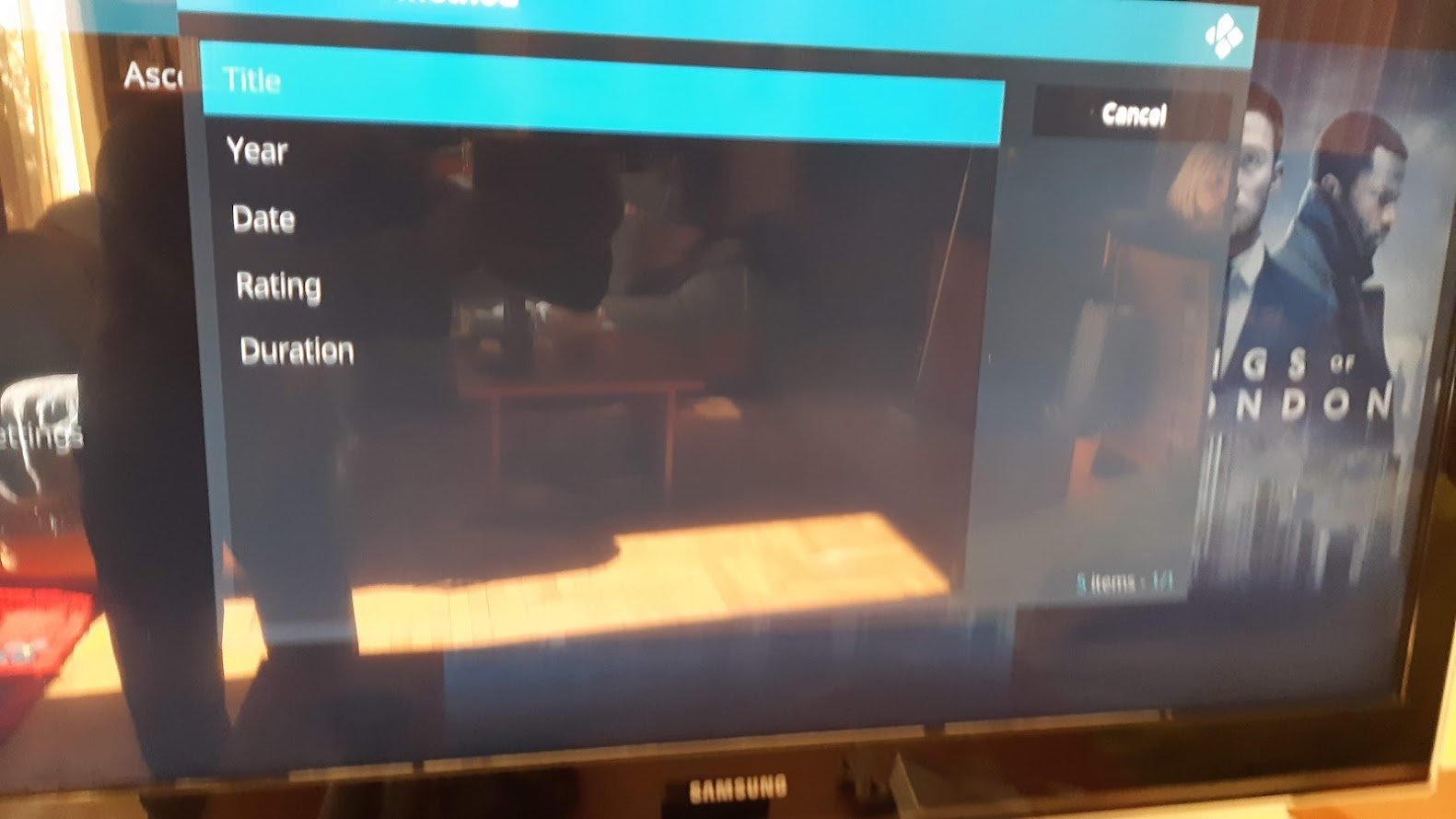

stefprob 3 Posted October 21, 2021 Posted October 21, 2021 I am having the following odd problem, when i add my TV Shows menu from Emby (video nodes, emby next-gen, Tv SHOWS), i do not have the option to short them by episode. If i add them through the normal TV SHOWS of Kodi (media, video, import--> dirext smb path to tv shows folder) the option to short them by episode is available.
stefprob 3 Posted October 22, 2021 Author Posted October 22, 2021 (edited) Update, i open emby, choose TV SHOWS and when i get in a show i still cannot sort by episode, there is no option to select it.... I have tried with the default Kodi skin and with AEON MQ for Matrix. Edited October 22, 2021 by stefprob

stefprob 3 Posted October 22, 2021 Author Posted October 22, 2021 The pic you have posted is from the default Kodi TV SHOWS menu and yes, it has a sort by episode option. I am talking about the TV SHOWS from Emby next gen menu, where no option like this exists:
