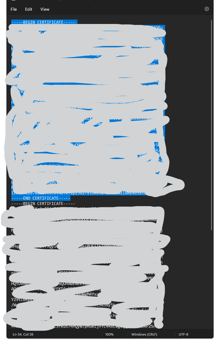

bandit8623 132 Posted February 6, 2023 Author Posted February 6, 2023 (edited) On 2/2/2023 at 11:28 AM, Teredactle said: I'm also got the email One thing is that when you create the certificate, no IP doesn't give you the option of just the cert, you need to select a "web server" - I don't recall what I did last time I generated it, worked fine though, I used Other this time. @bandit8623 so I went through to try and regenerate with the newly created PEM file from NO-IP and got errors (even after updating to the latest windows openssl verion 3.0.7).. F8240000:error:1E08010C:DECODER routines:OSSL_DECODER_from_bio:unsupported:crypto\encode_decode\decoder_lib.c:101:No supported data to decode. Input structure: Certificate F8240000:error:1E08010C:DECODER routines:OSSL_DECODER_from_bio:unsupported:crypto\encode_decode\decoder_lib.c:101:No supported data to decode. Input structure: Certificate F8240000:error:1E08010C:DECODER routines:OSSL_DECODER_from_bio:unsupported:crypto\encode_decode\decoder_lib.c:101:No supported data to decode. Input structure: Certificate F8240000:error:1608010C:STORE routines:ossl_store_handle_load_result:unsupported:crypto\store\store_result.c:151: F8240000:error:1608010C:STORE routines:ossl_store_handle_load_result:unsupported:crypto\store\store_result.c:151: F8240000:error:1608010C:STORE routines:ossl_store_handle_load_result:unsupported:crypto\store\store_result.c:151: F8240000:error:1608010C:STORE routines:ossl_store_handle_load_result:unsupported:crypto\store\store_result.c:151: F8240000:error:1608010C:STORE routines:ossl_store_handle_load_result:unsupported:crypto\store\store_result.c:151: F8240000:error:1E08010C:DECODER routines:OSSL_DECODER_from_bio:unsupported:crypto\encode_decode\decoder_lib.c:101:No supported data to decode. Input structure: Certificate F8240000:error:1608010C:STORE routines:ossl_store_handle_load_result:unsupported:crypto\store\store_result.c:151: F8240000:error:1608010C:STORE routines:ossl_store_handle_load_result:unsupported:crypto\store\store_result.c:151: I'll also add the following comment, about the instruction(s). When I ran it this time it told me I needed a password, and had to use -password pass:mychosenpassword It's possibly because I skipped? a step here... It's unclear to me about MMC? I'm in the cert manager already as in step 6, this does the same thing no? Also at exporting, there are some additional checkboxes that are not covered in the instructions (Delete - self explanatory don't use this until you are sure all works, Export extended properties and Enable cert privacy, leave defaults like below? The next step asks the encryption, I chose AES256-SHA256, but there is also the option for TripleDES-SHA1. Maybe this is why it didn't work? In any case, did not work for me this round, as I got those errors above. Did it work for you? So the problem for me was maybe 2 fold. first the pem file downloaded from no-ip was all garbled(notepad). i went back and checked my old pem file(with notepad) from trustcore and it was not garbled. so what i did next was check the pem chain from no-ip instead(pemchain was not garbled and had clear text. once downloaded you have to edit the file in notepad. remove all text after the first section after -----END CERTIFICATE----- so you have one section only example below use only blue highlighted section save this file as the regular .pem file use this file in openssl. I am currently up and running with new cert! confirm this works for you and i will send in a trouble ticket with no-ip to have these pem files hopefully fixed. -- other things i did, but not sure had anything to do with it. **** pls try the first fix first before doing all the extra work in these last 4 steps. ***** 1- fully removed openssl 2- I installed Win64 OpenSSL v1.1.1s 64MB version on https://slproweb.com/products/Win32OpenSSL.html 3- in cmd ran SET OPENSSL_MODULES=C:\Program Files\OpenSSL-Win64\bin 4- added the files here into the installed openssl directories https://drive.google.com/file/d/1tX7BJuGYfzZ8925Vr3xy2fzOrv8SdP8I/view?usp=sharing this one included legacy.dll **** pls try the first fix first before doing all the extra work in these last 4 steps. ***** let me know how it goes -Jake Edited February 6, 2023 by bandit8623 added pem chain example 1

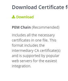

Teredactle 27 Posted February 10, 2023 Posted February 10, 2023 (edited) On 2/6/2023 at 1:48 AM, bandit8623 said: So the problem for me was maybe 2 fold. first the pem file downloaded from no-ip was all garbled(notepad). i went back and checked my old pem file(with notepad) from trustcore and it was not garbled. so what i did next was check the pem chain from no-ip instead(pemchain was not garbled and had clear text. once downloaded you have to edit the file in notepad. remove all text after the first section after -----END CERTIFICATE----- so you have one section only example below use only blue highlighted section save this file as the regular .pem file use this file in openssl. I am currently up and running with new cert! confirm this works for you and i will send in a trouble ticket with no-ip to have these pem files hopefully fixed. -- other things i did, but not sure had anything to do with it. **** pls try the first fix first before doing all the extra work in these last 4 steps. ***** 1- fully removed openssl 2- I installed Win64 OpenSSL v1.1.1s 64MB version on https://slproweb.com/products/Win32OpenSSL.html 3- in cmd ran SET OPENSSL_MODULES=C:\Program Files\OpenSSL-Win64\bin 4- added the files here into the installed openssl directories https://drive.google.com/file/d/1tX7BJuGYfzZ8925Vr3xy2fzOrv8SdP8I/view?usp=sharing this one included legacy.dll **** pls try the first fix first before doing all the extra work in these last 4 steps. ***** let me know how it goes -Jake Will give it a go as you suggest and post back here. I will prep the certificate and test it, but won't implement it unless I get feedback from my family, as there is a mix of older LG smart tv (already an issue), laptops, Fire sticks, etc... -Fatman EDIT - tried it, so basically took the pem-chain file, edited as you suggested, then I ran the 2 commands as I had the cert exported. Did not generate any errors. Pointed Emby to it, restarted Emby, SSL was broken. Changed it back to the old one, restarted Emby, all is well. I'll give it a go from fresh again, but not sure what happened there. Does Emby need to be updated too, I'm running v4.6.7.0 portable which works fine for me and really don't feel like upgrading unless there is something the new version resolved. Is this such a case, v4.6.7.0 won't work with the new SSL certs?? Edited February 11, 2023 by Teredactle

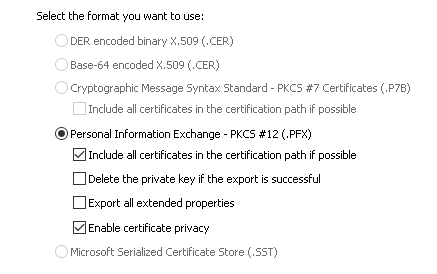

freshj 2 Posted May 22, 2024 Posted May 22, 2024 Hi, firstly thanks for this helpful guide. I managed to get SSL to work and have been using it over the last year. The time has come to renew the certificate and I did so thru the no-ip dashboard using my existing hostname & CSR. My old certificate is still active, expires in a few days. I have downloaded the new certificate pem chain from no-ip. Unsure of what is required now. Do I now have to combine the private key created prior with the new certificate pem I have downloaded to create a new pfx to use with emby? Similar to what was detailed with openssl before? What about the current one? Do I need to revoke that? Does it override the old one? Just not sure what the process is to renew the ssl certificate. Appreciate help in clarifying how this process should go.
Luke 40137 Posted May 23, 2024 Posted May 23, 2024 On 5/21/2024 at 8:50 PM, freshj said: Hi, firstly thanks for this helpful guide. I managed to get SSL to work and have been using it over the last year. The time has come to renew the certificate and I did so thru the no-ip dashboard using my existing hostname & CSR. My old certificate is still active, expires in a few days. I have downloaded the new certificate pem chain from no-ip. Unsure of what is required now. Do I now have to combine the private key created prior with the new certificate pem I have downloaded to create a new pfx to use with emby? Similar to what was detailed with openssl before? What about the current one? Do I need to revoke that? Does it override the old one? Just not sure what the process is to renew the ssl certificate. Appreciate help in clarifying how this process should go. HI, from Emby's perspective, you don't need to revoke anything, although you may still wish to do that. You just need to point it to the pfx and supply the password. Please let us know how things go. Thanks ! 1
freshj 2 Posted May 23, 2024 Posted May 23, 2024 Thanks Luke, I managed to fumble through and get my head around it. I just created a new pfx using the renewed certificate pem and pointed emby to that. Easy process in the end. 1
