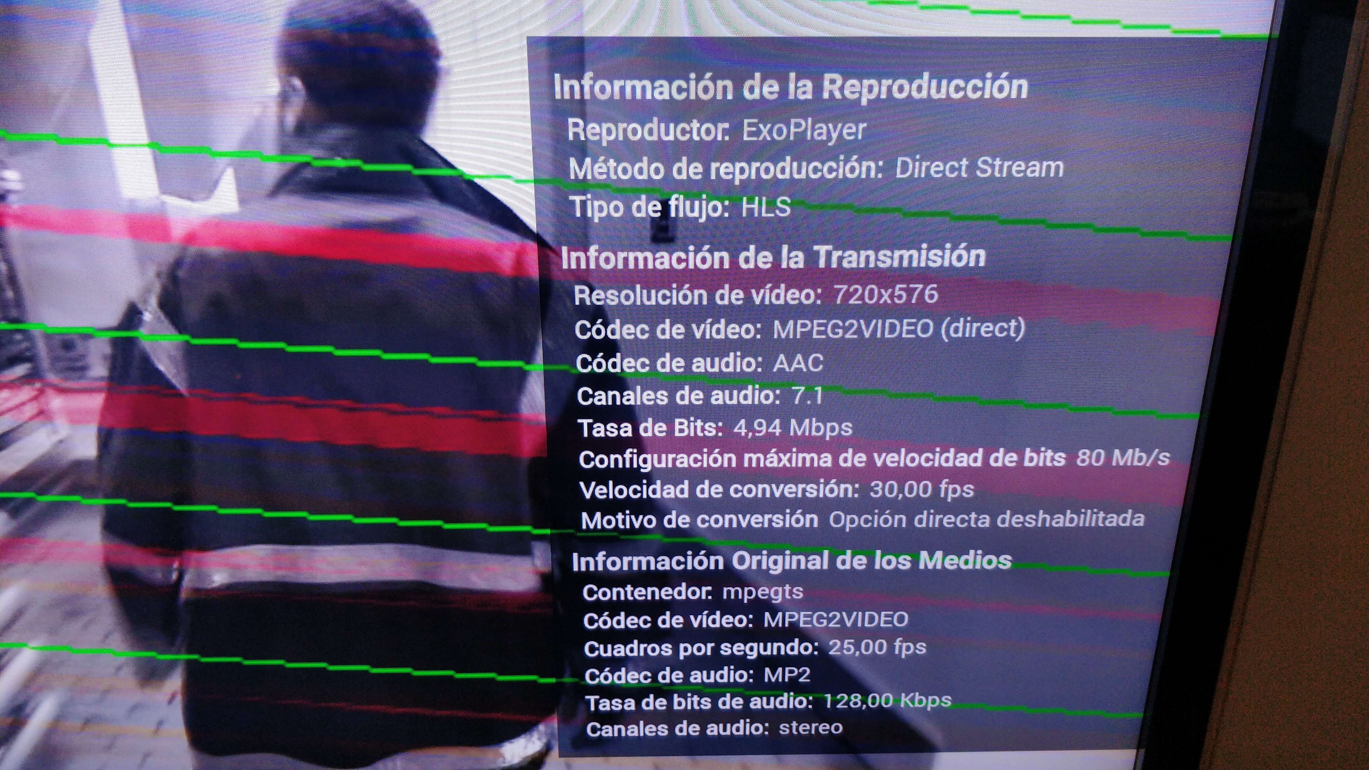

ekanemore 0 Posted October 16, 2021 Posted October 16, 2021 Hola, tengo un problema con Emby del Amazon FireTV cuando visualizo algunos canales de TV. Aparecen una líneas verdes en la reproducción de estos canales (DesdeEmbyFireTV.jpg). Versión EMBY: 4.6.4.0 Versión TVHeadend: Tvheadend 4.2.7-4.el7 Versión FireTv Stick Lite: Fire OS 7.2.4.2 Este error solo aparece cuando se visualizo con el EMBY del FireTV y solo con algunos canales (DMAX, DKISS,...). Si estos canales los reproduzco desde TVHeadend o desde el Navegador del FireTV se reproducen perfectamente (DesdeNavegadordelFireTV.jpg). ¿sabeis que puede ocurrir? Muchas gracias. embyserver.txt ffmpeg-remux-f44b489e-9c94-43c4-bc77-3922a417772d_1.txt
Carlo 4552 Posted October 18, 2021 Posted October 18, 2021 Hi, while playing back on the Fire TV can you bring up stats for nerds (COG icon during play back) for one of these green line videos and take a picture of the screen showing the Stats for Nerds info? Please upload that pic for us to take a look at. Thanks

ekanemore 0 Posted October 20, 2021 Author Posted October 20, 2021 Here is the information, but i get the solution to the problem. I have uncheck the option "Permitir copia de flijo de video" (solucion.jpg) and is working fine. Thanks @Luke and @cayars.
ebr 15663 Posted October 20, 2021 Posted October 20, 2021 Okay, so the issue was somehow with the stream copy of the mpeg stream. Interesting. Glad you got it going.
