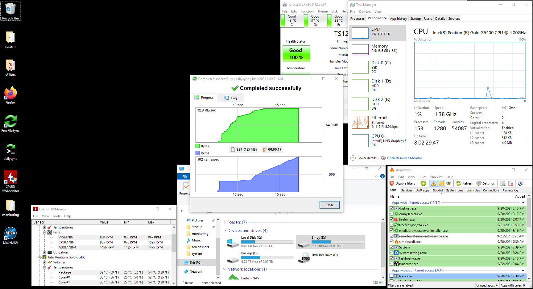

Bingie 99 Posted October 1, 2021 Author Posted October 1, 2021 It's been a week, everything working perfectly, running cool and quiet, no problems. I love this box! The case is a brilliant design. Air flow fantastic. Here is the remote desktop (using tightvnc), I leave these status windows open, so I can take a quick peek, to make sure everything is okay. Look at those low temperatures. Even the NVMe runs cool, no heat sink on it.
Bingie 99 Posted October 1, 2021 Author Posted October 1, 2021 (edited) Sorry, the hwmonitor was behind the daily sync message. Look at how cool the cpu is running. The system is idle right now. Edited October 1, 2021 by Bingie
