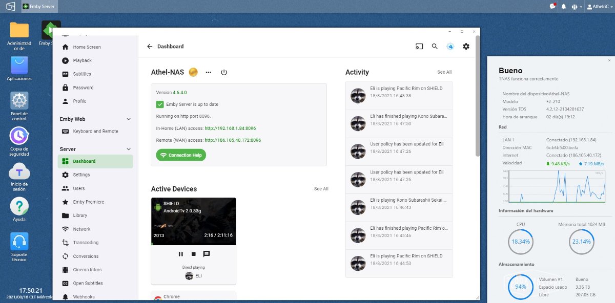

AthelriC 0 Posted August 18, 2021 Author Share Posted August 18, 2021 so i was doing some test today with my brother and the movie still freezes for buffering probleams the picture shows that the NAS is uploading 7.19MBps, and thats what i dont understand, why cant the NAS upload more to make the buffer bigger? Link to comment Share on other sites More sharing options...
Luke 30135 Posted August 18, 2021 Share Posted August 18, 2021 Is this a remote connection? Link to comment Share on other sites More sharing options...
AthelriC 0 Posted August 18, 2021 Author Share Posted August 18, 2021 40 minutes ago, Luke said: Is this a remote connection? Yes Link to comment Share on other sites More sharing options...
