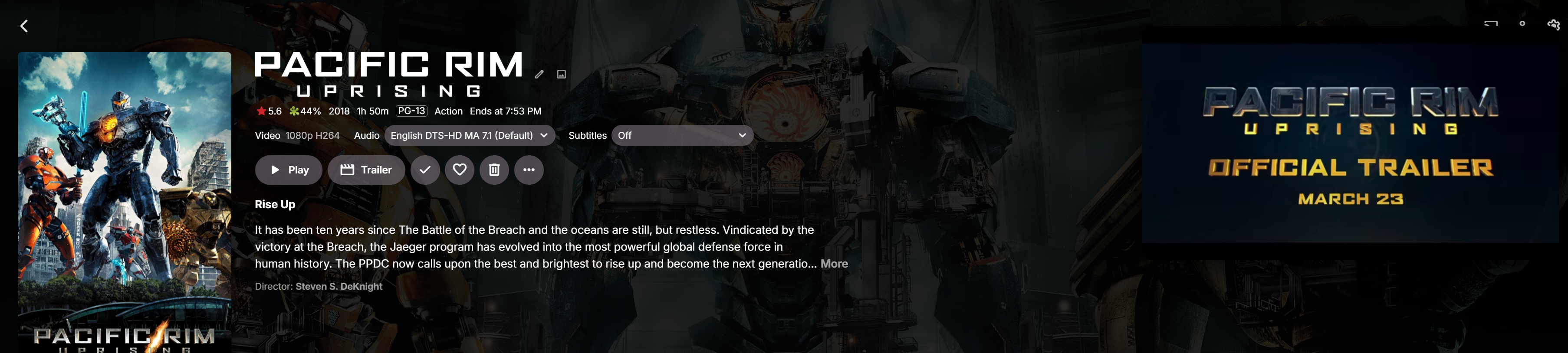

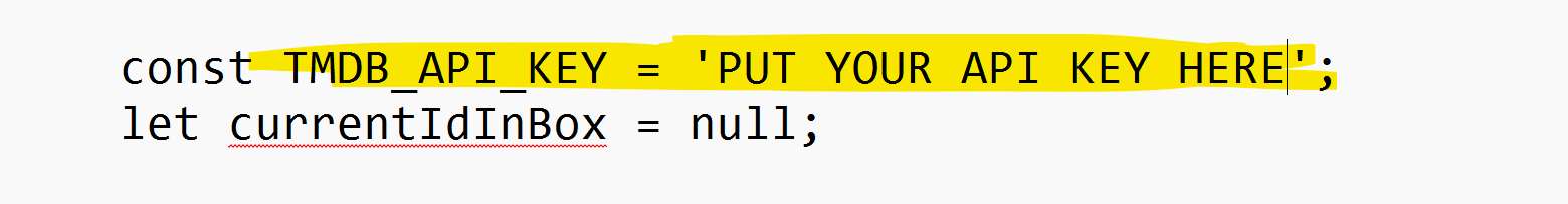

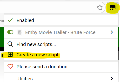

Auto play movie trailer inside folder - Spotlight like @sh0rty inspired
BIGDREY posted a topic in Web App CSS
Me and AI spent some time together today and came up this. Inspired by @Sh0rty. What this does is plays a movie trailer in the top right corner of the folder when you open it. I am using the TaperMonkey web browser extension this work. Getting it set up is pretty easy once you install the extension. You need a TMDB API key which you can get for free. Once you have that the rest is easy. Hit the TaperMonkey icon, then create new script copy and paste the code from the file input your API, save it, hit refresh on EMBY and there you have it. EMBY IN FOLDER TRAILER AUTO PLAY.txt -
