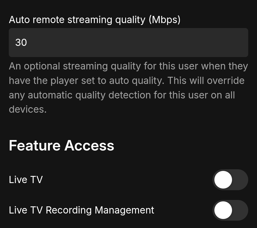

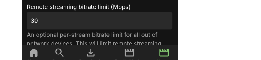

  6. SamES
    Playback error “no compatible streams”
    Do you use a reverse proxy or just standard port forwarding?
  7. SamES
    Can you also try removing this limit for a test?

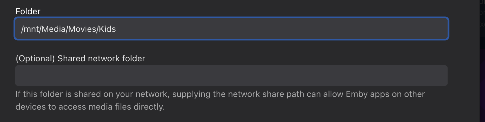

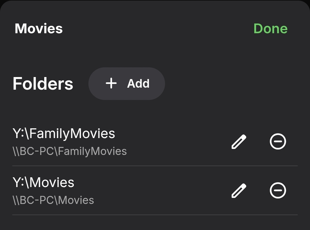

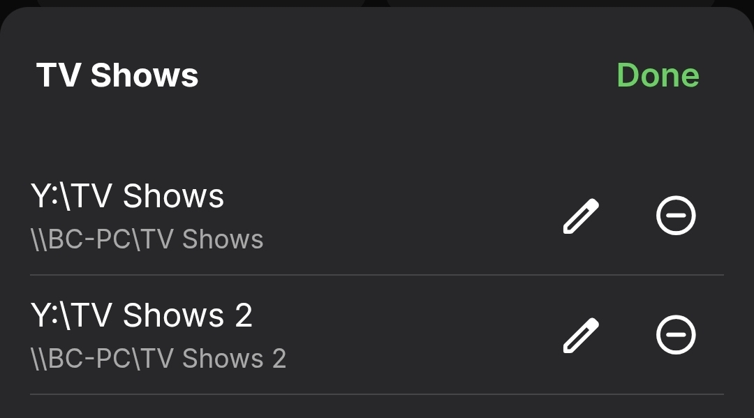

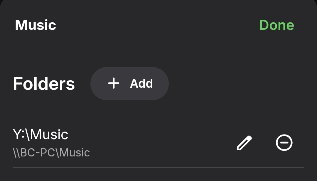

  8. SamES
    Do you set the Shared Network path on folders in your library or do you leave it blank?

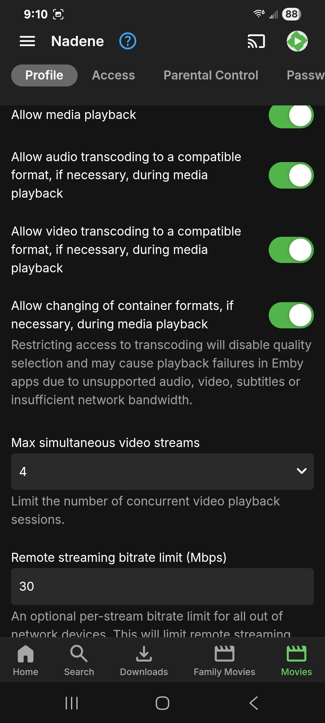

  11. brainfryd
    Hi Sam, Thanks again, for looking into this ... I looked at the playback attempts from earlier today and the file that the log is referring to IS a basic 1080p mkv with Ac-3, so it should just direct play... I've attached a screenshot for the media info from Emby. Also for reference, I can't even play a basic MP3 music file, the same non playback behaviour happens... I have other friends who can connect remotely to the server and the transcoding works perfectly the way it's setup. I can turn off the hardware transcoding if you think it's necessary, but 3 or 4 other clients including my phone, all transcode with no issues. Also I sent the screenshot earlier of the playback settings on the client, it was set to auto, here's the playback settings for the user on the server

  18. SamES
    Thanks for all the info. Something doesn't make sense with this. We'll have to try and get back to basics. Just to eliminate this as possibly being a problem. Can you please try and find where this is being limited, it could be in the playback settings on the client? Can you please turn off the hardware acceleration Transcoding option on the server and do some tests. Please test with a basic mkv file with a h264 1080p video and ac3 audio track, and ensure subtitles are all off. Does anything play, or is it just items that need transcoding due to TrueHD/DTS/bitrate that is the problem? Let's try and get something DirectPlaying, then we can work from there.
