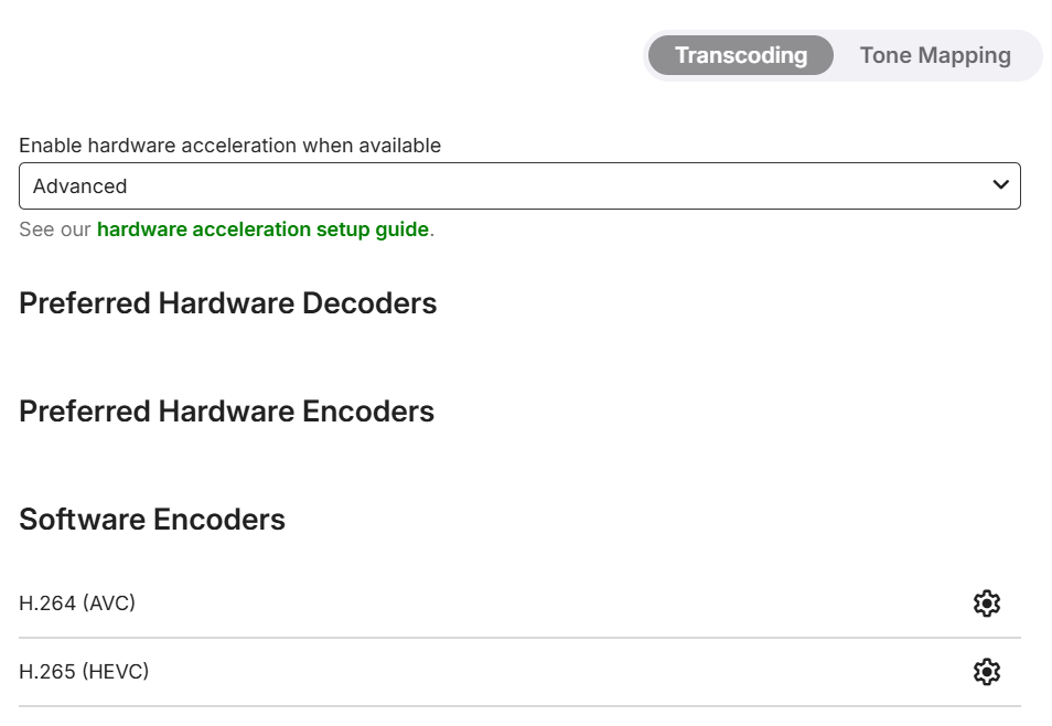

Coxeroni started following Unraid: HW transcoding not working (?)

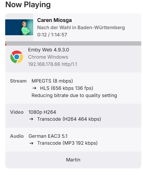

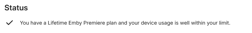

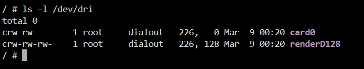

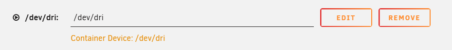

Emby Version 4.9.3.0 - Unraid 7.3.2 CPU is Intel® Xeon® CPU E3-1225 v6 @ 3.30GHz, which was working well with Plex before. I have Premiere lifetime if that is of interest: Recently I started converting some recorded TV episodes to a more "friendly" format, when I realised high CPU usage and very slow progress. Does it mean that HW transcoding is not working? It should state the encoders, shouldn't it? I forwarded /dev/dri in unraid ...and I can also see the device inside the Emby container: When I force transcode a playback, I don't seem to have any kind of HW transcoding indication either: What am I missing here? Edit: Just fired up my Plex container on the same system, and iGPU/QuickSync transcoding works fine there... Edit2: Same on Version 4.10.0.5 beta hardware_detection-63908664531.txt

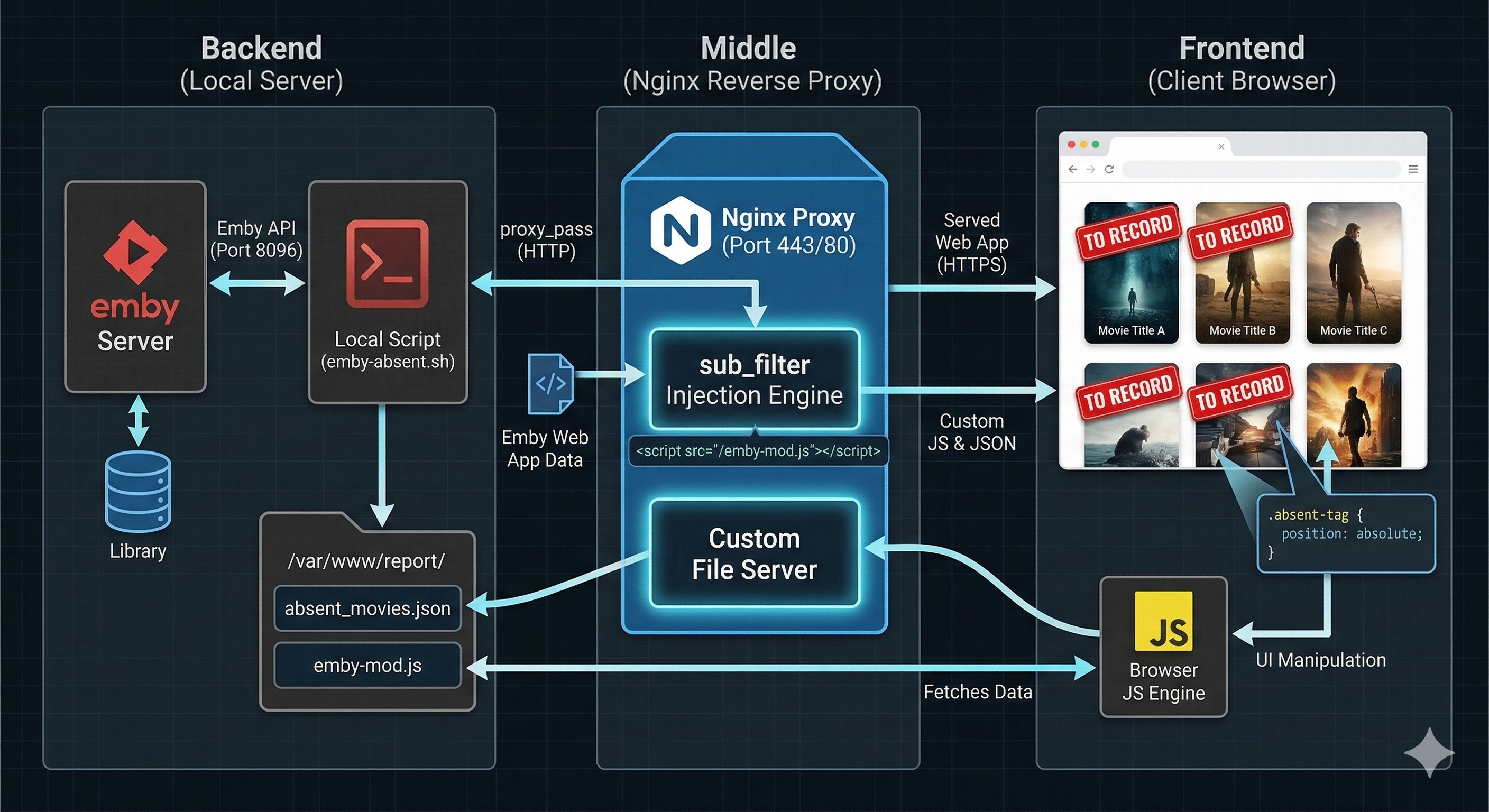

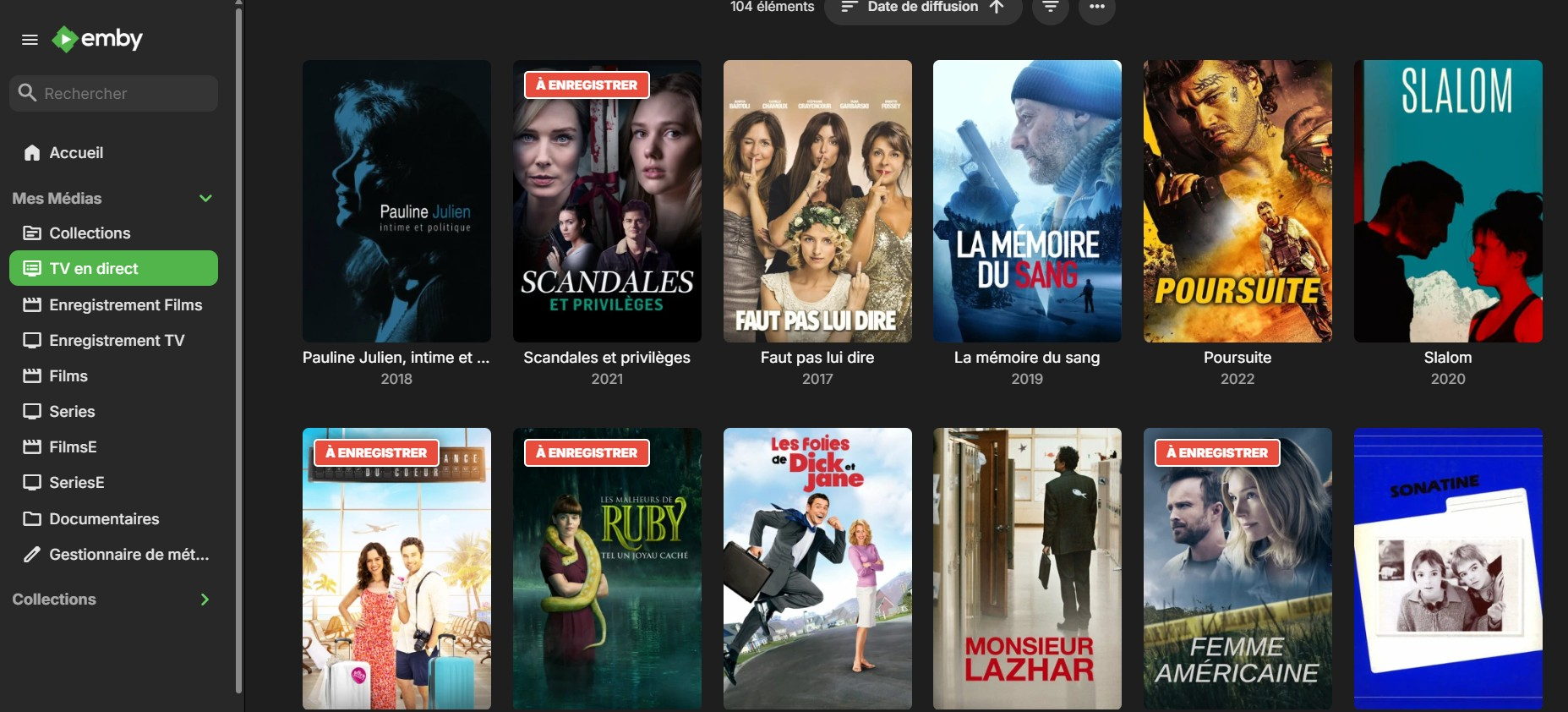

Visual EPG "Not in Library" Indicators using Nginx and API Scripting This solution uses a small bash script and an Nginx reverse proxy to inject a visual "TO RECORD" tag directly into the Emby web interface for any movie found in the EPG that isn't already in your collection. How it works: Backend Script: Compares your library against the EPG via the Emby API. JSON Output: Saves a list of "missing" movies to a web-accessible folder. Nginx Injection: Automatically inserts a small JavaScript file into the Emby web app using sub_filter. UI Update: The script scans the page and adds a red badge to any matching movie titles. 1. The Automation Script (emby-absent.sh) This script generates the data. Place it in /usr/local/bin/ and ensure jq is installed. Update the EMBY_URL and API_KEY placeholders. #!/bin/bash # Configuration EMBY_URL="http://yourembyip:8096" API_KEY="YOUR_API_KEY_HERE" WEB_PATH="/var/www/report/absent_movies.json" # Function to clean up titles for better matching (removes punctuation/spaces) clean_title() { echo "$1" | tr '[:upper:]' '[:lower:]' | sed 's/[^a-z0-9]//g' } # 1. Generate cleaned list of local movies LOCAL_CLEAN=$(curl -s "$EMBY_URL/emby/Items?IncludeItemTypes=Movie&Recursive=true&api_key=$API_KEY" \ | jq -r '.Items[].Name' | while read -r line; do clean_title "$line"; done | sort | uniq) # 2. Get list of movies currently in the EPG PROGRAMS=$(curl -s "$EMBY_URL/emby/LiveTv/Programs?IsMovie=true&api_key=$API_KEY" | jq -r '.Items[].Name' | sort | uniq) # 3. Compare and output JSON echo "$PROGRAMS" | while read -r title; do TITLE_CLEAN=$(clean_title "$title") if ! echo "$LOCAL_CLEAN" | grep -qxF "$TITLE_CLEAN"; then echo "$title" fi done | jq -R . | jq -s . > "$WEB_PATH" chmod 644 "$WEB_PATH" Set a cron job to run this every 4 hours: 0 */4 * * * /usr/local/bin/emby-absent.sh 2. Nginx Configuration Add these lines to your Emby location / block. This handles the injection and serves the custom files. location / { proxy_pass http://yourembyip:8096; # Disable compression so sub_filter can read the body proxy_set_header Accept-Encoding ""; # Inject the script before the closing body tag sub_filter '</body>' '<script src="/emby-mod.js"></script></body>'; sub_filter_once on; # Standard headers proxy_set_header Host $host; proxy_set_header X-Real-IP $remote_addr; proxy_set_header X-Forwarded-For $proxy_add_x_forwarded_for; proxy_http_version 1.1; proxy_set_header Upgrade $http_upgrade; proxy_set_header Connection $http_connection; } # Serve the injected files from your report directory location /emby-mod.js { root /var/www/report; } location /absent_movies.json { root /var/www/report; } 3. The Frontend Script (emby-mod.js) Save this in /var/www/report/emby-mod.js. It handles the visual tagging in the browser. (function() { async function markMovies() { try { const r = await fetch("/absent_movies.json?t=" + new Date().getTime()); const absentList = await r.json(); const absentListLower = absentList.map(t => t.toLowerCase().trim()); // Selector for movie titles in EPG and Library views const allTexts = document.querySelectorAll(".cardText, .itemName, .cardTitle"); allTexts.forEach(el => { const title = el.innerText.trim(); if (title && absentListLower.includes(title.toLowerCase())) { const card = el.closest(".card") || el.closest(".padded-card") || el.parentElement; const imageContainer = card.querySelector(".cardImageContainer") || card; if (card && !card.querySelector(".absent-tag")) { const tag = document.createElement("div"); tag.className = "absent-tag"; tag.innerText = "TO RECORD"; // Style the badge (Red, Bold, Floating) Object.assign(tag.style, { position: "absolute", top: "10px", left: "10px", backgroundColor: "#e74c3c", color: "white", padding: "4px 10px", fontWeight: "900", fontSize: "11px", borderRadius: "4px", zIndex: "999", boxShadow: "0 0 10px rgba(0,0,0,0.5)", border: "1px solid white", pointerEvents: "none" }); imageContainer.style.position = "relative"; imageContainer.appendChild(tag); } } }); } catch(e) { console.debug("EPG Check: Data not ready yet."); } } // Check for new cards every 2 seconds to handle scrolling setInterval(markMovies, 2000); })(); Credits: Special thanks to Gemini (Google AI) for the collaboration in refining this technical solution, writing the English documentation, and generating the architectural diagram. -

Proposed Solution: Visual EPG "In-Library" Indicators via Reverse Proxy Since this feature is still pending in the core Emby build, I’ve developed a workaround that identifies whether a movie in the EPG (Electronic Program Guide) is already in your library. It uses a combination of an external script and Nginx injection. The Implementation The solution consists of three main components: API Extraction Script: A custom script runs periodically to query the Emby API. It fetches a list of all movies currently in the EPG and compares them against your existing media library. It then generates a JSON file containing the "missing" status for these items. Nginx Reverse Proxy Injection: Using a reverse proxy (like Nginx), we inject a small JavaScript snippet and the generated JSON data into the Emby web interface as it is served to the client. UI Modification (CSS/JS Tagging): The injected script scans the web interface and looks for the movie IDs identified by our script. It then dynamically adds a visual tag (e.g., "Not in Library") directly on the movie details or guide screen. Why this works: No Core Modification: You don't need to wait for an official Emby update or modify the server's binary files. Reduced Friction: It eliminates the need to manually search for a movie before clicking "Record." Lightweight: The heavy lifting (comparing the library) is done by the script in the background, keeping the UI snappy. -
