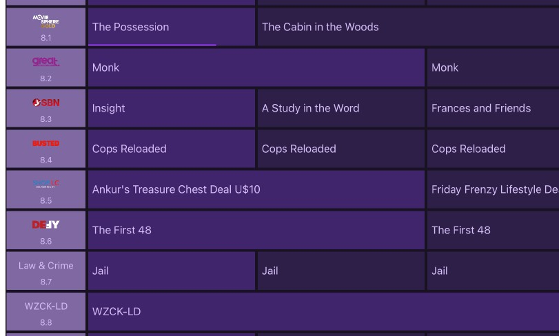

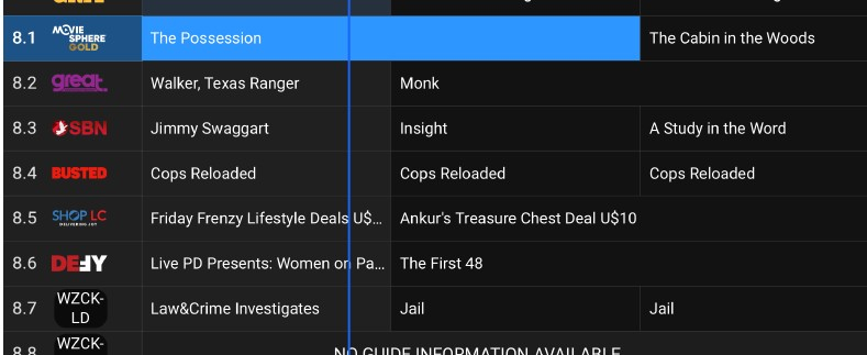

Scibes started following Missing EPG data for USA-OTA53590
Not exactly sure how EMBY gets it's EPG guide data but is it possible to add some missing EPG data for OTA zip code 53590 ? Channels missing guide data are 8.1 to 8.8 Plex, HDHomerun and Channels for HDHomerun all retrieve the correct guide data. See attachments.
