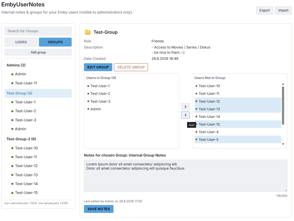

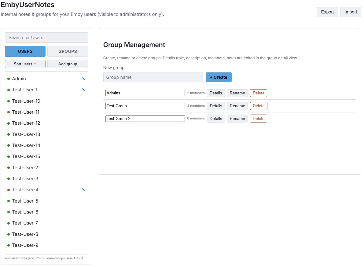

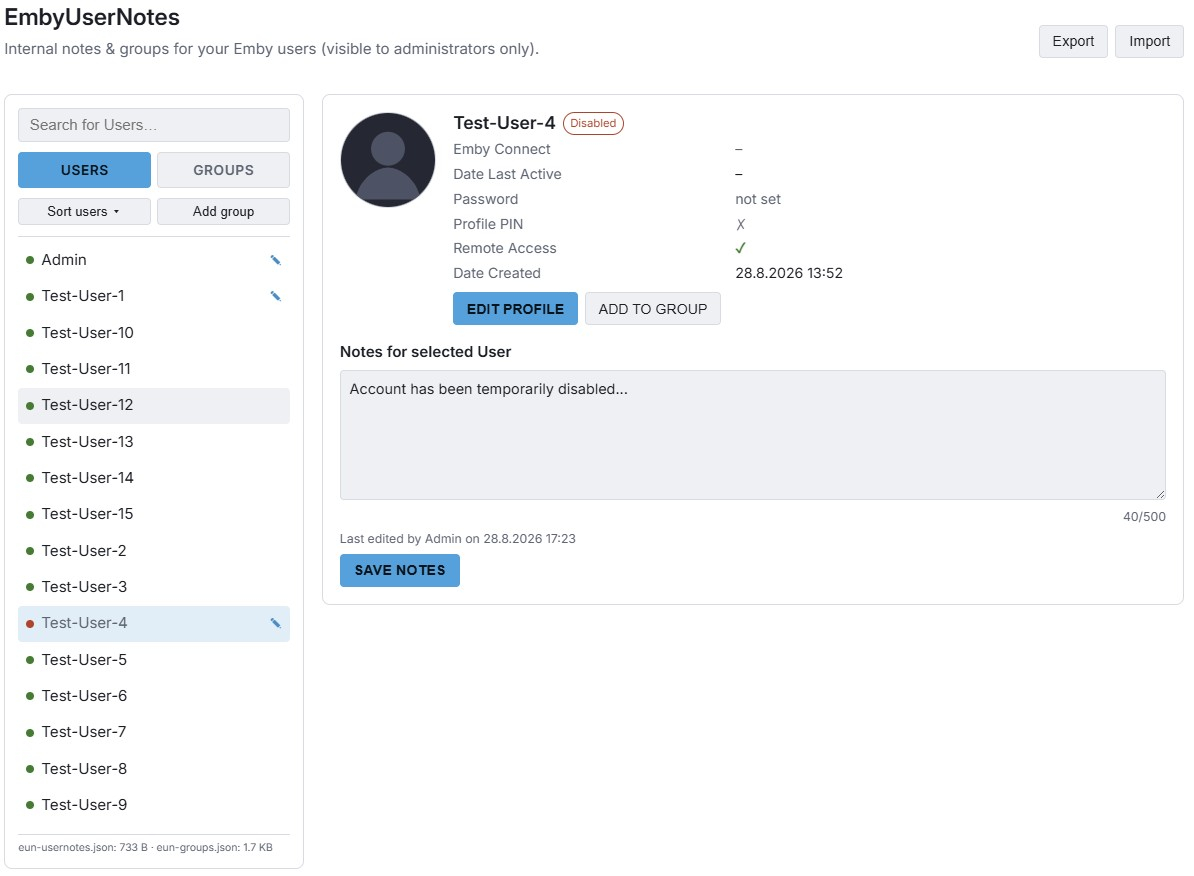

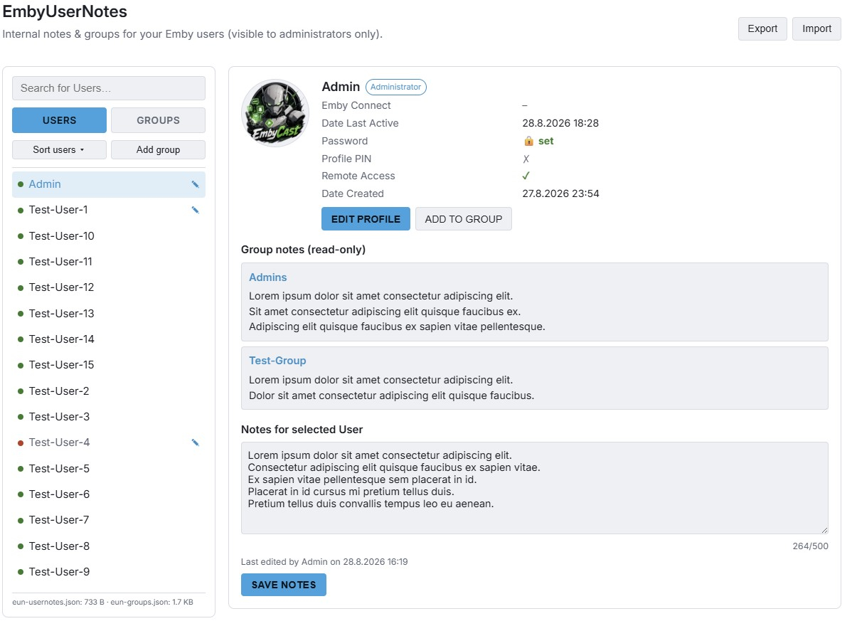

Hey everyone, Inspired by a feature request (Have an admin notes section under each user account), I built EmbyUserNotes (EUN) - a lightweight, admin-only plugin for internal notes on users and custom user groups, with CSV export/import for backup. Here are some screenshots: How to test: 1. Download EmbyUserNotes.dll below. 2. Copy it into your Emby Server "plugins" folder. 3. Restart Emby Server, then open Dashboard -> "User Notes". Security & privacy: - Admin-only, enforced server-side on every route - Never writes to Emby's own database - only reads existing user data (incl. avatar) the same way the built-in Dashboard does. - Notes are plain text only, no rich text/HTML formatting - keeps things simple and safe. - "EDIT PROFILE" links straight to Emby's own official user-edit page for the selected user. Export / Import: The export generates a single .zip file containing 3 CSV files (groups, group members, and user notes). While built-in validation checks are included, manually editing and importing modified CSV files is at your own risk. This is a fully working beta version, but since it's just a side project, further development will depend on community interest. If you'd like to help test this release, your feedback is welcome! EmbyUserNotes.dll
