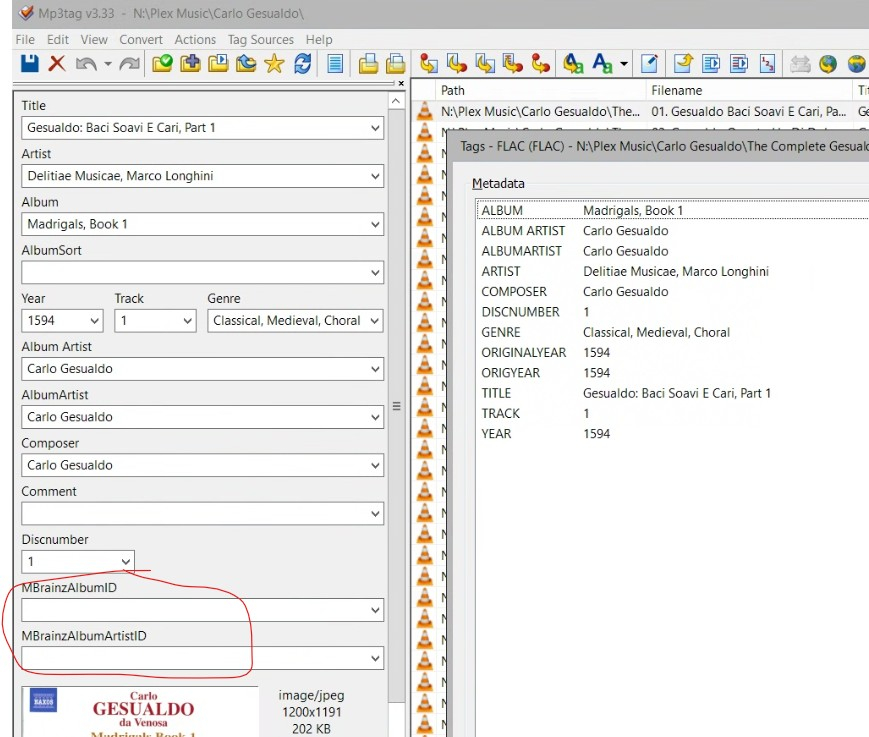

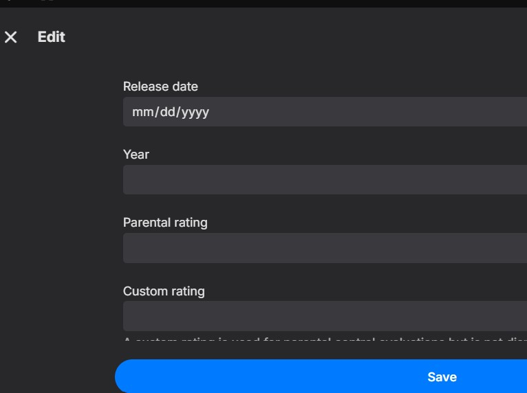

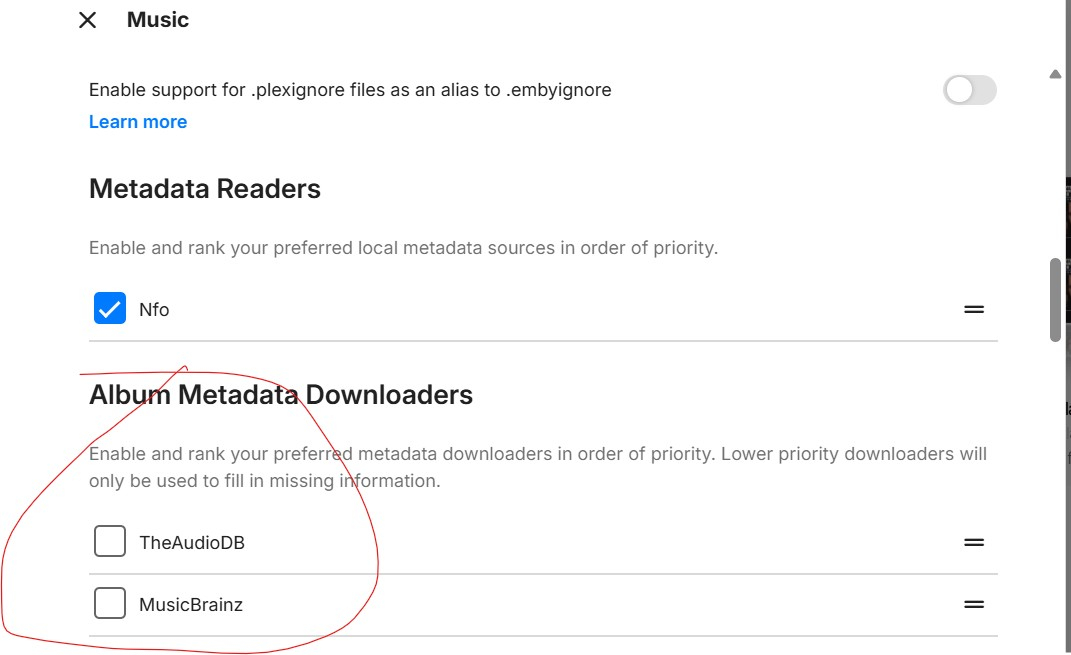

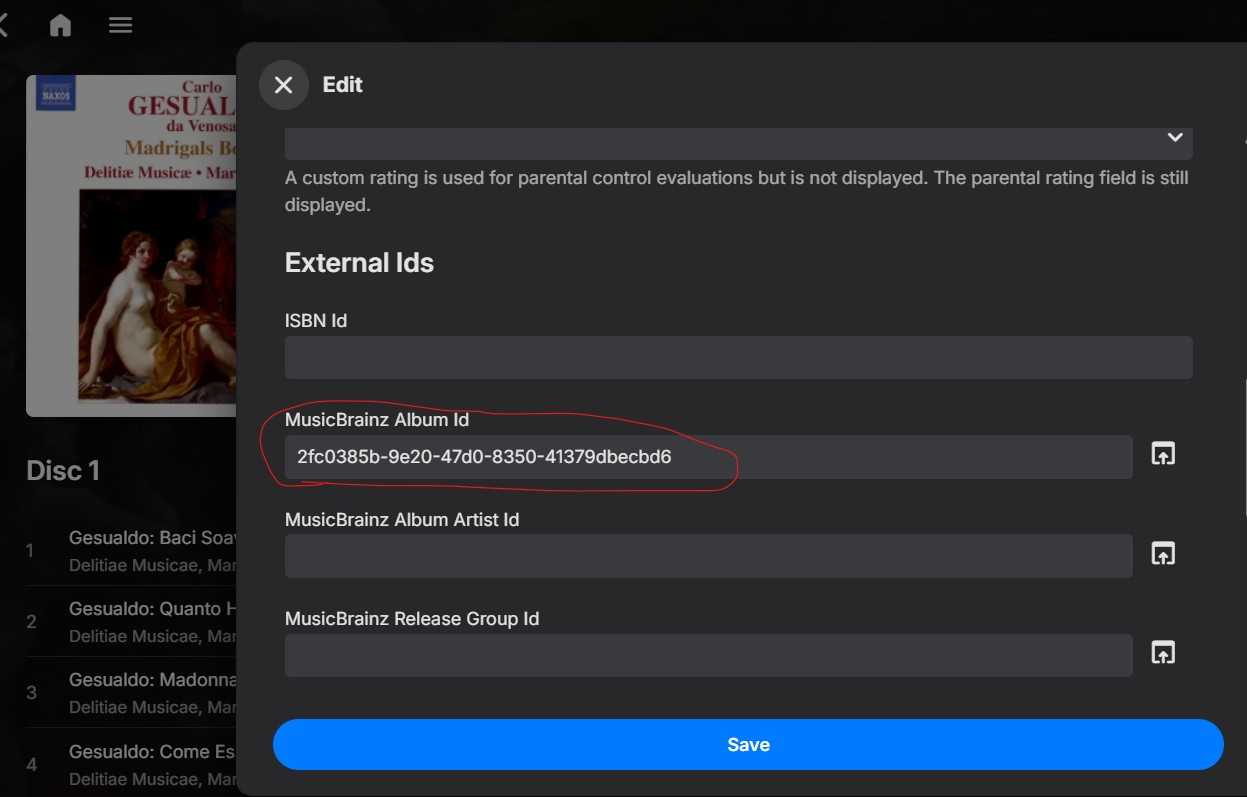

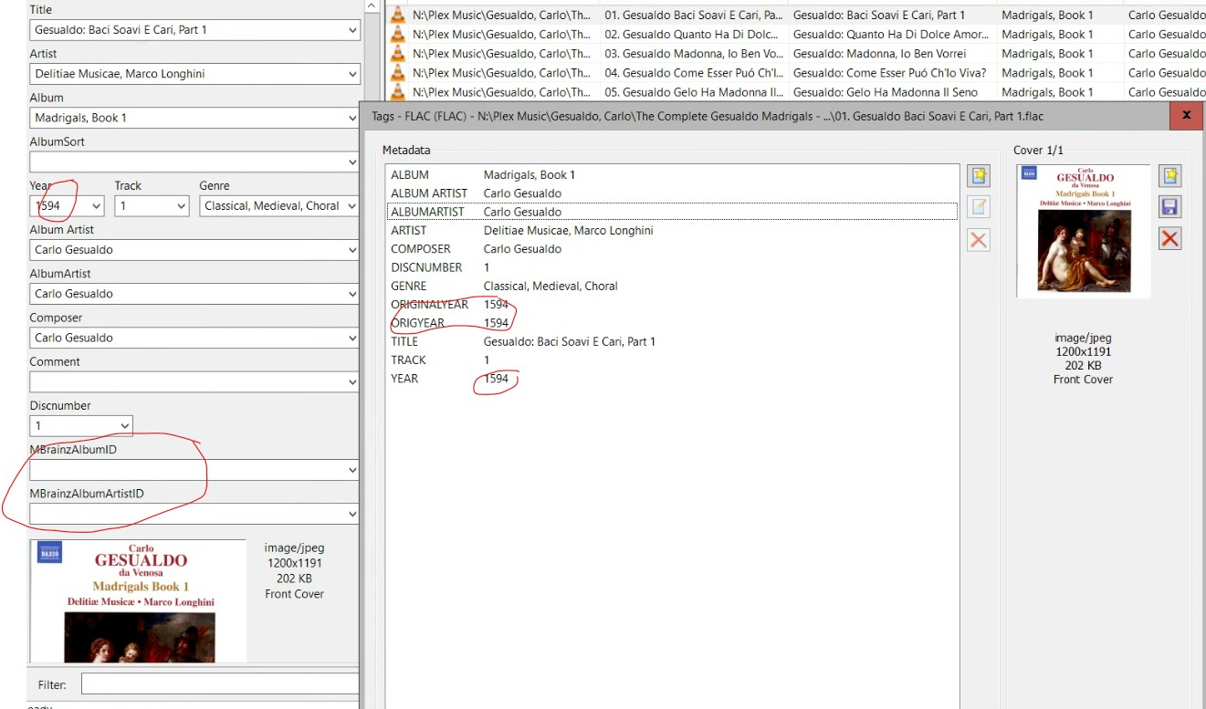

Well, I'm sorry to say that this situation is not fixed or clear @Luke. I am desperately seeking some clarity and some transparency from the Emby developers about how you process scans. I'm attaching below a series of screenshots to show that I am trying to have the displayed year for some music albums be the year of composition, long ago (1594), not the year the actual albums were recorded (2013). Also attached is the log file.Here's what I did: deleted every NFO file, manually in MP3tag, created originalyear fields and populated them with the same corrrect older date did the Emby dance to remove everything from the library made sure that MusicBrainz is not supposed to be consulted. But then when I rescan and return those files to Emby, the scan for some reason is reaching out once again to MusicBrainz! and overwriting the data in my actual files. Please, please, please just provide some clear information on how Emby is doing these music library scans and how to stop it from bringing in external data that hasn't been requested in our settings and that is overwriting actual tag data that we have manually put in. embyserver.txt
