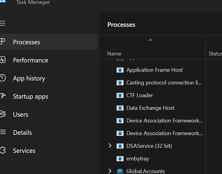

    Emby suddenly stopped working.
    No VPN is connected. Windows, Google functions normal. No, no updates.
  3. Zenith Media
  4. Zenith Media
    In the task manager, emby is showing as embytray.
  5. Neminem
    Hmm that's odd. Can you show a screenshot? Need more info to help. What happened when it stopped working? ( Windows update? install software? VPN install? ) any detail is not too small.) Every thing, does not come out of nothing.
  6. darkassassin07
    Is EMBY SERVER showing running in TaskManager. If not, you need to start it. It should be located at C:\Users\<your user>\AppData\Roaming\Emby-Server If you start it, try to connect, and still can't; grab the new log file (it will have overwritten the previous embyserver.txt file you grabbed earlier) and post it here again.
  7. Zenith Media
    Yes...It is showing as embytray in task manager.

  10. Neminem
    Is it showing in you task manager?
  11. Zenith Media
  12. Neminem
    Is it showing in you task manager? If not then its not running.
  13. Zenith Media
    It is still saying local host refused to connect.
  14. Zenith Media
    Okay. I as you pointed out. It did create a event log within emby-server-programdata-logs.

  17. pwhodges
    If you open a command line, navigate to the C:\Users\<your user>\AppData\Roaming\Emby-Server directory (or wherever it's installed on your machine) and type embyserver.exe, what error message do you get? Do you get an entry in the Windows Event Log? Paul
  18. Zenith Media
    Start what? emby, it will not start. Keeps saying as the screenshot sent.
  19. Neminem
    Then start it. And try again. Does is shutdown again after that?
  20. Zenith Media
    No, it is not in the task manager. Correct, it is from my servers pc. The same as the screenshot, refused to connect.
  21. Neminem
    Do you see the Emby-server running in task manager? Is those screenshots from you localhost / pc / server? Where you open browser and type in http://localhost:8096
  22. Zenith Media
  23. Zenith Media
    Oh no. It's still not working.
  24. Neminem
    Does that mean you fixed it

  26. Zenith Media
    It is not showing anymore.
