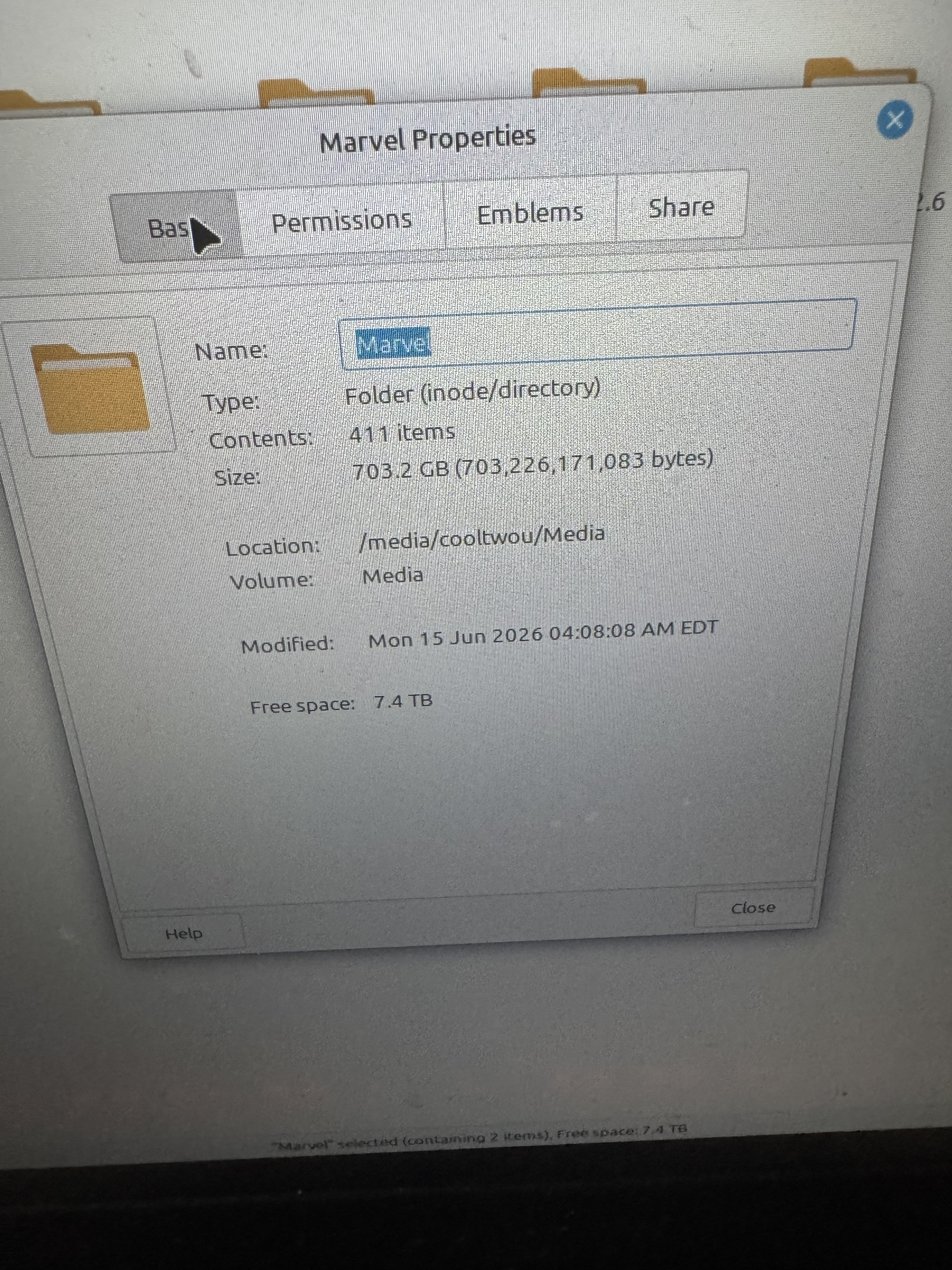

I am able to open the external hard drive in the file browser & everything I clicked opened & how do I fix mount issues
Issue sorted. Dodgy switch. Thanks again.
It look like you have mount issues System.IO.IOException: System.IO.IOException: Input/output error : '/mnt/wwn-0x5000c500e90d708c-part2/Wrestling/Wrestling/Kenny Omega' System.IO.IOException: System.IO.IOException: Input/output error : '/mnt/wwn-0x5000c500e90d708c-part2/Marvel/Movies' Is the mount working out side Emby? Also CoverArt plugin is not working without Emby Premiere, and those errors are making logs hard to read.
Ensure your mount point is properly accessible, there are several errors like this: System.IO.IOException: System.IO.IOException: Input/output error : '/mnt/wwn-0x5000c500e90d708c-part2/Wrestling/Wrestling/Kenny Omega' System.IO.IOException: System.IO.IOException: Input/output error : '/mnt/wwn-0x5000c500e90d708c-part2/Marvel/Movies' System.IO.IOException: System.IO.IOException: Input/output error : '/mnt/wwn-0x5000c500e90d708c-part2/Movies'
