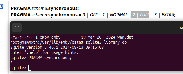

Well "When you run PRAGMA synchronous; in your terminal or SQL editor, you are only seeing the setting for your own connection, not Emby’s." No way to play much with the SQLite settings outside Emby then as I understand.

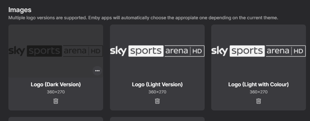

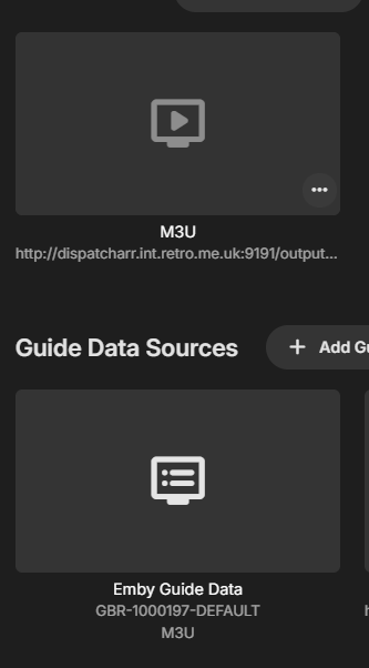

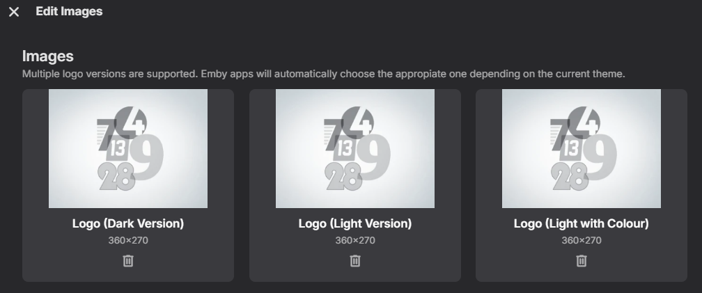

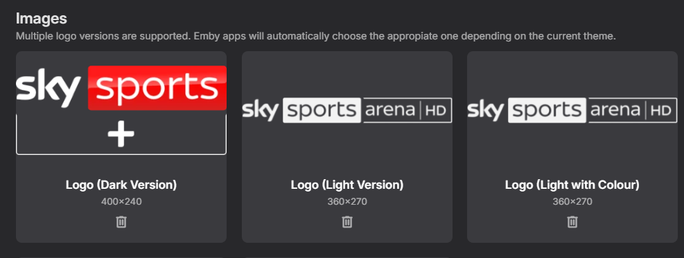

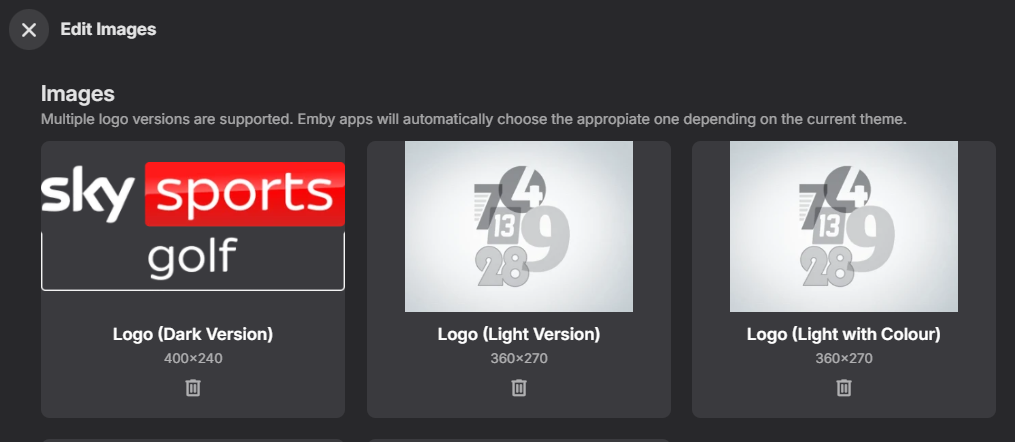

So I've done some more testing with this and it's kind of annoying as unless I am being stupid I can't get it to do exactly what I want. If I set the preferred channel image source of the M3U tuner file from Dispatacharr to be Guide Data Source. I assume this means it will use the Emby Guide data I have setup for the EPG data which is using Sky Q London GBR-1000197-DEFAULT When I do this two example channels which have incorrect images, I assume from Gracenote are Sky Sports Golf (406) which has the same weird image for light, dark and light with colour. And also Sky Sports + (404) which has different light and dark images but they are for Sky Sports Arena which I believe was the old channel name. I've tested both of the above by deleting all 3 images for each channel refreshing my browser to make sure no logo is displayed and then I have carried out a guide data refresh which then picks up the same 3 logos for each channel again. To try and get around these two issues, as well as the fact that I personally don't like the black or white logos which seem to be provided using the Emby Guide Data for most of the channels. I set the preferred channel image source to be my M3U file which contains the correct logos for Sky Sports Golf and Sky Sports + as well as containing, in my opinion better images in the traditional sky red, blue and white colours which work on both light and dark themes nicely. After setting the above to M3U , deleting the existing images for the example channels Golf and Sky Sport + and then carrying out a Guide Data refresh. Golf picks up the correct image from my M3U file and puts it under the dark logo but the light and light with colour logos are still populated with the incorrect image from Gracenote. And for Sky Sports + I also get the correct image for the dark logo from the M3U but the incorrect version for the light and light with colour logos. The problem I have is that I use the dark theme on everything as the light theme is way to bright to look at, which means even though I have a correct logo from my M3U file it isn't displayed. The same thing happens for a lot of other channels, although they aren't actually incorrect images like these examples, they are just the less appealing, in my opinion, white and black images and the only way I can get it to show the logos from my M3U file is to use the light theme for Emby. The weird thing is, if I replace all 3 images with the one I want. Then it works correctly as you would expect and shows the logo I want when using either the dark or light theme in Emby. I can manually run a guide data refresh multiple times and my manually uploaded images are retained. But it seems that something runs over night which replaces my manually added images as with the ones from Emby Data/Gracenote as each morning the images are wrong. Again, as with my other recent posts, I appreciate this is all fairly minor stuff and it's not really a fault or a bug of Emby. But just reporting things that I personally would find beneficial if they were changed. I guess there are two things to this for me. 1. The Gracenote data seems to have the incorrect images at least for Sky Sports Golf and Sky Sports +. I know we have the other post about Gracenote channel number duplication. So maybe they have some work to do on their side. 2. It would be good if in Emby we could either manually specify which image to use for the channel logo which overrides the choice based on theme. Or if there was some way to lock the image so once it's been manually changed nothing can replace it with an image from an automated process. Sorry for the super long reply. Just trying to give as much information as possible. Thanks again. -
Hi, mmh except if I misunderstand something (which is possible), Emby does not apparently set synchronous to "normal" on my system (on the library.db file at least). emby-server is up while I print the synchronous value, so I guess it should display the value configured by the Emby database session. I don't have an idea about how much this would impact search performance though.

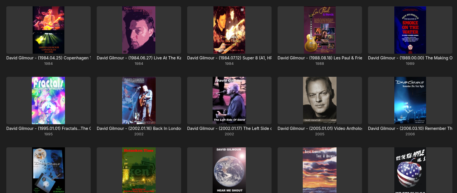

Could one just place a library setting to force the view to be portrait or landscape? How deep is this "first" page? I run my python script and have the majority of the first sort hits with good portrait posters. Still comes up the wrong way. Kev.
