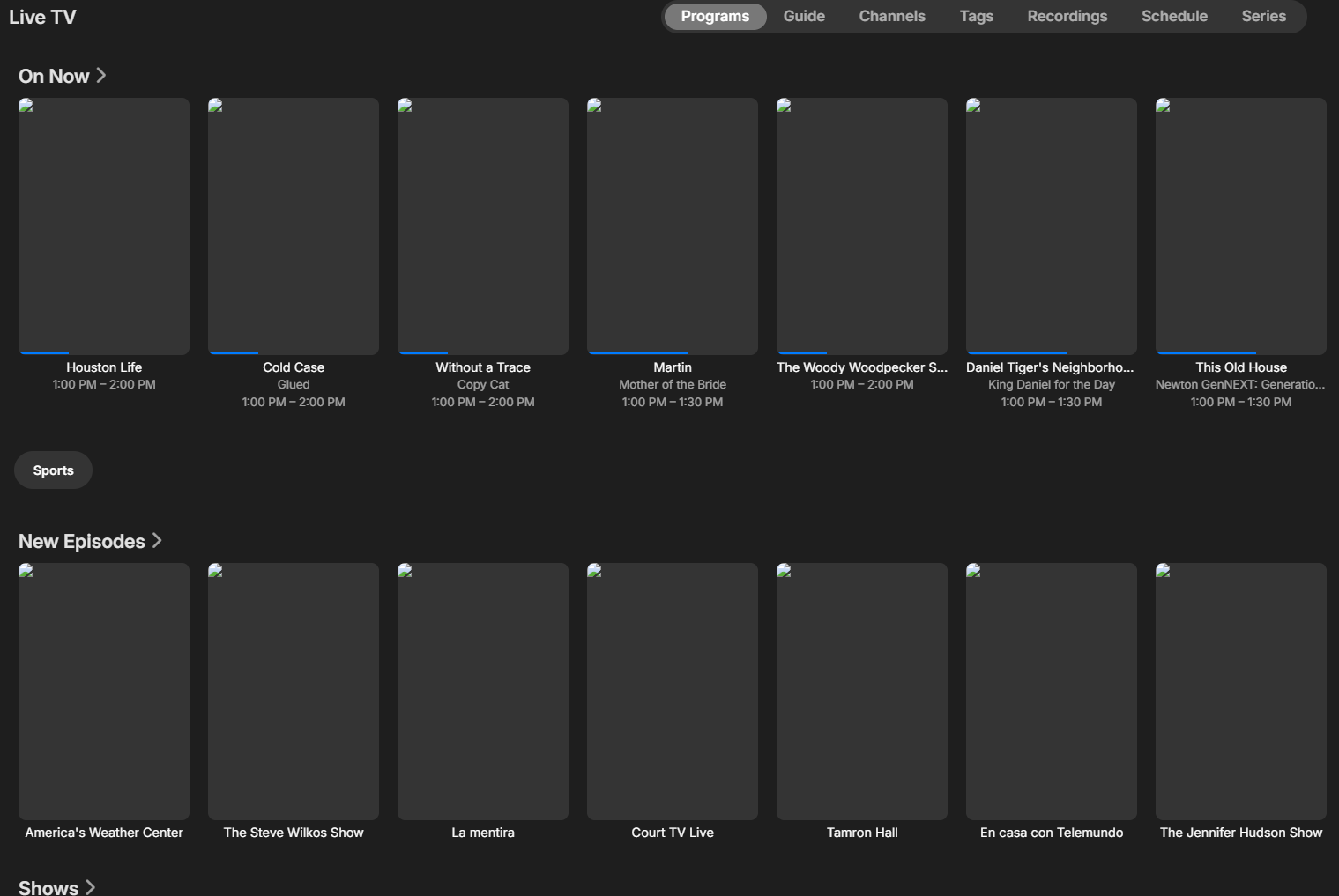

Since opp has not show any logs, can you with certenty say its the same No you can't. It might look similar.
But we have determined it is a very different cause. You have a general inability for your server to get out to the internet. This is just the place you most notice it.

It confirms you have a general problem of all outgoing communications from the server being blocked. Usually by the things I mentioned above. So I think that helps because now you know it's not specific to one single domain.

Thanks None of these you point out would affect the Live TV listings though. I'm looking to determine which service is failing/not connecting for the live TV listing not generating images. CFC

Neminem started following Broken image links for live TV
They are right here Its those you posted If you look at you logs you can see multiple servises failing the same way. Discogs TheMovieDb Not sure what this is but its failing Error updating device info for Dat UBP-X700 Connection to http://172.16.16.165:8091/AVTransport/Control timed out

Thanks. I will check. What IP or web address should I look for in my router logs? Also, where in my attached logs were you able to determine this? CFC
Hi, your connections to our server hosting the images are timing out and failing. If the issue persists, then typical causes are firewall, security software or vpn. Can you look into those and let us know what you find? Thanks.
Ok we are looking into it. Thanks.
