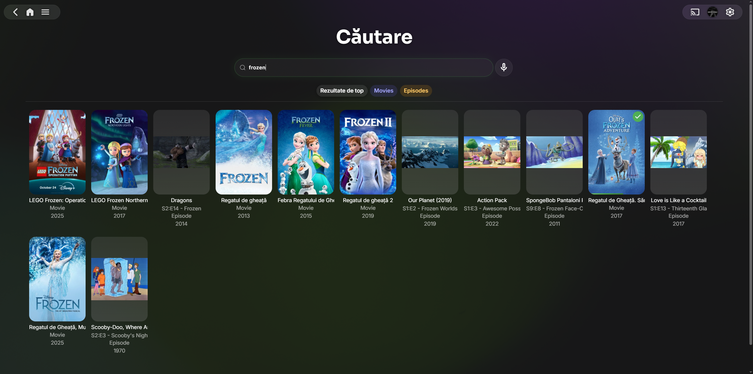

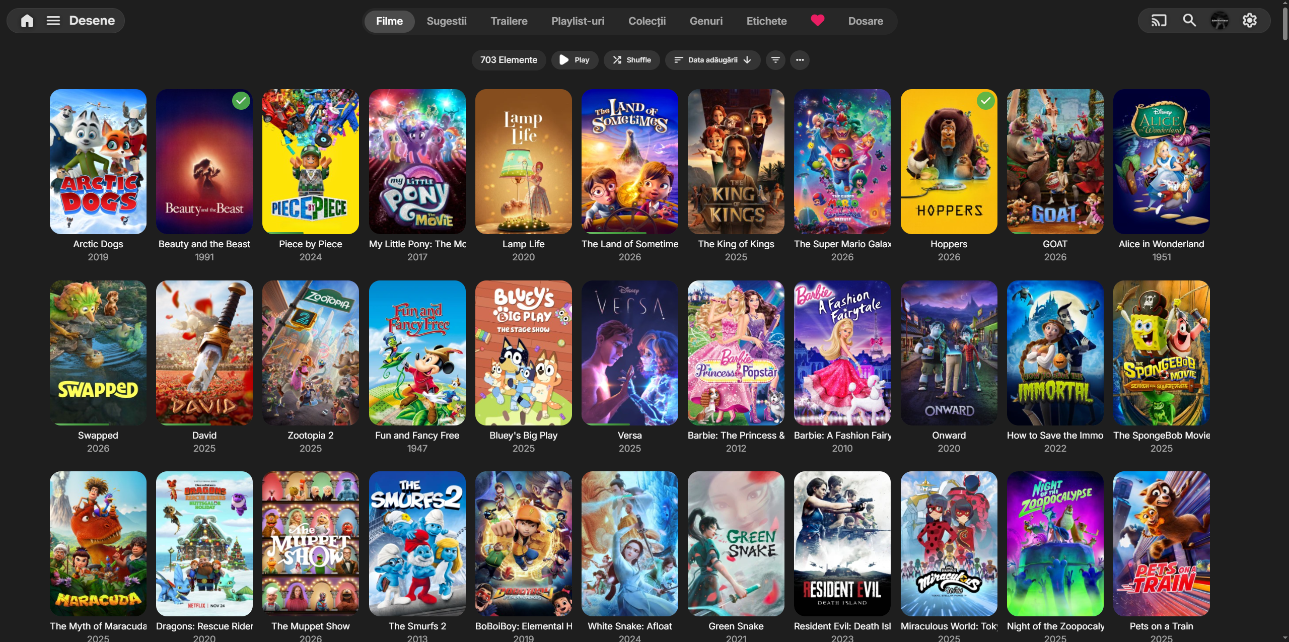

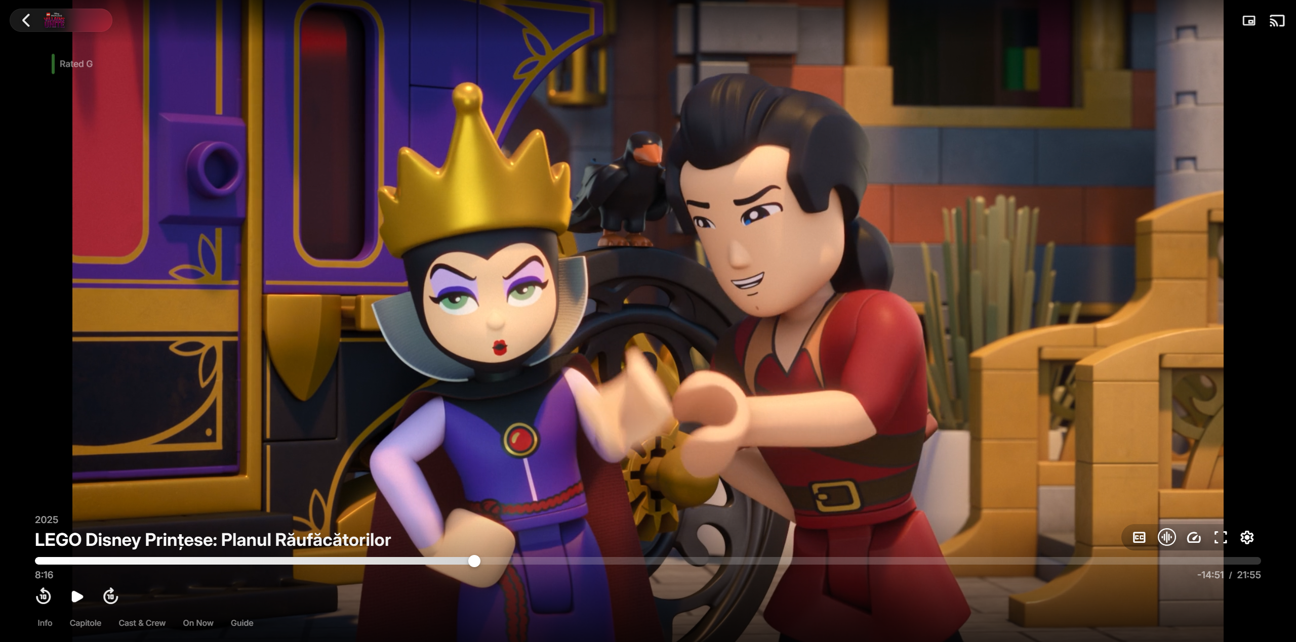

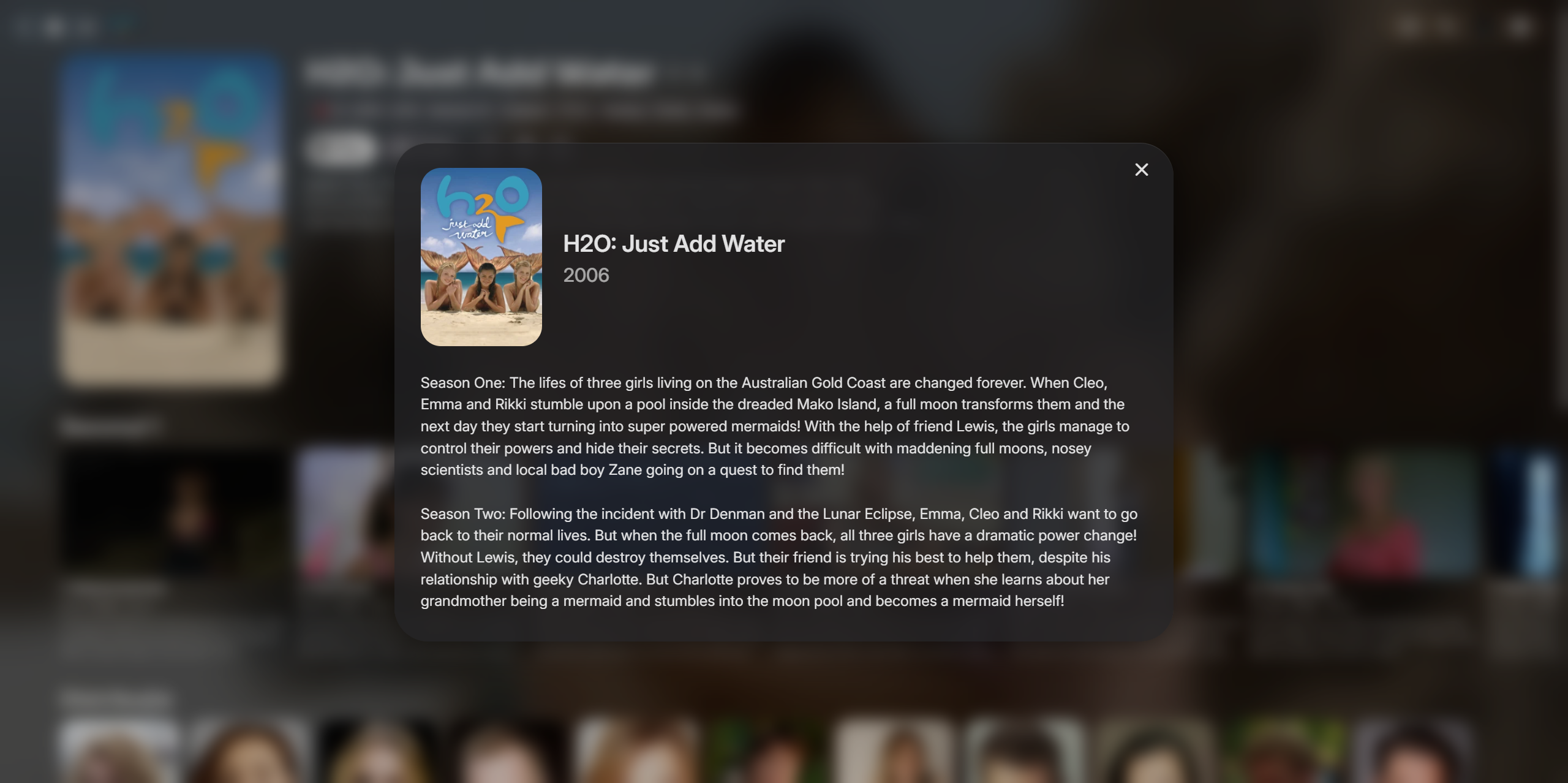

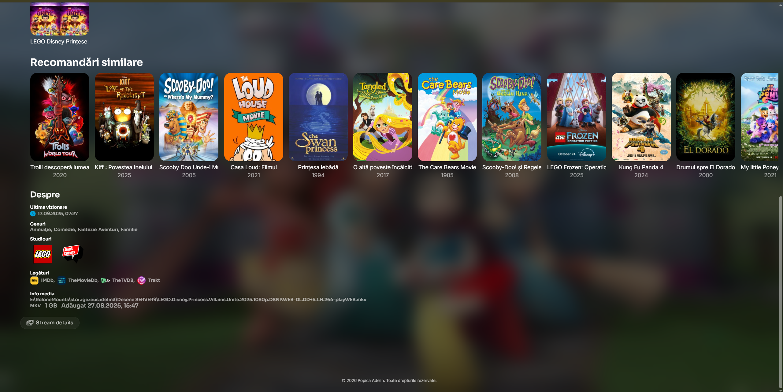

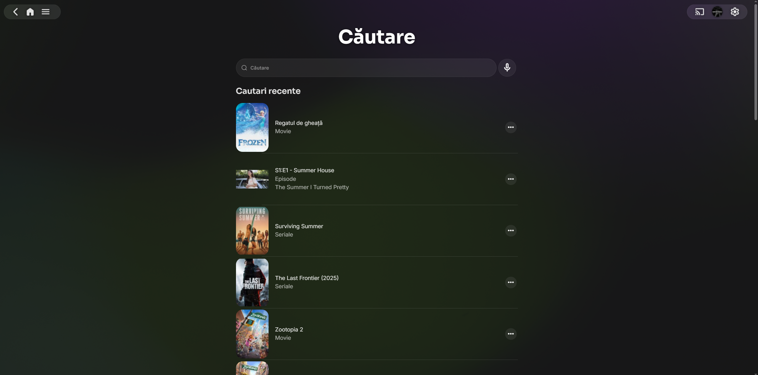

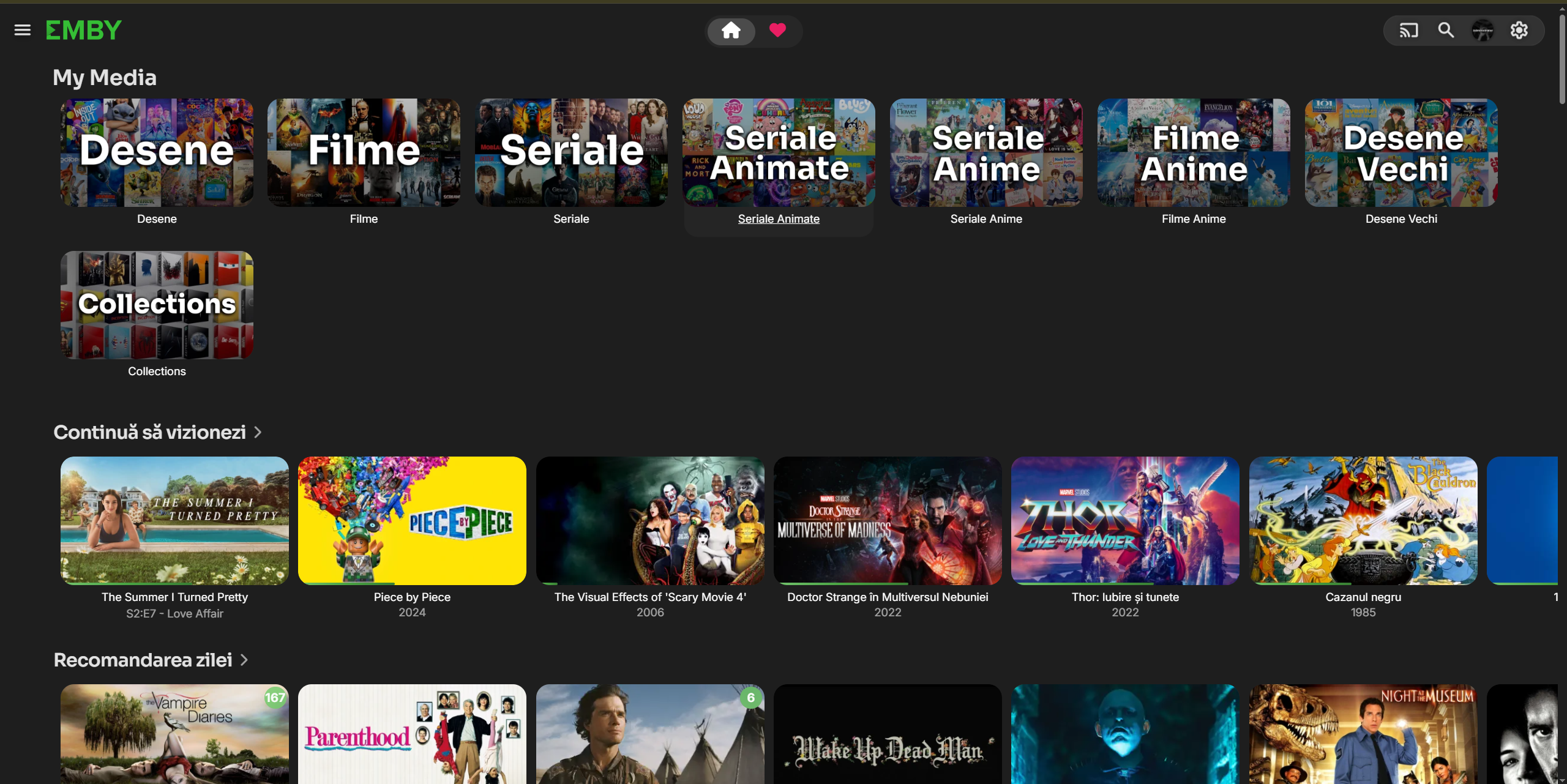

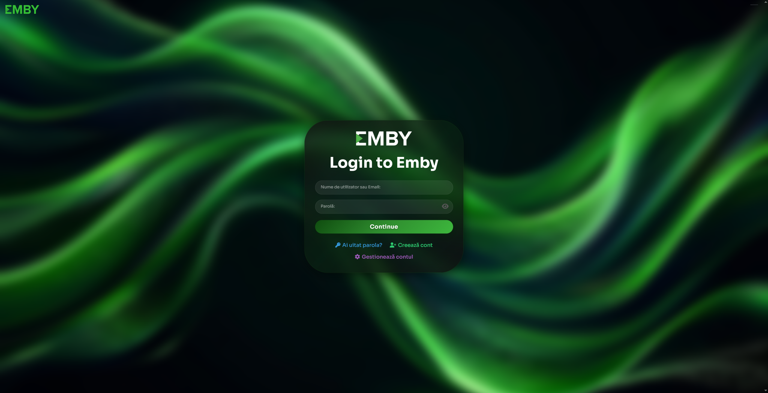

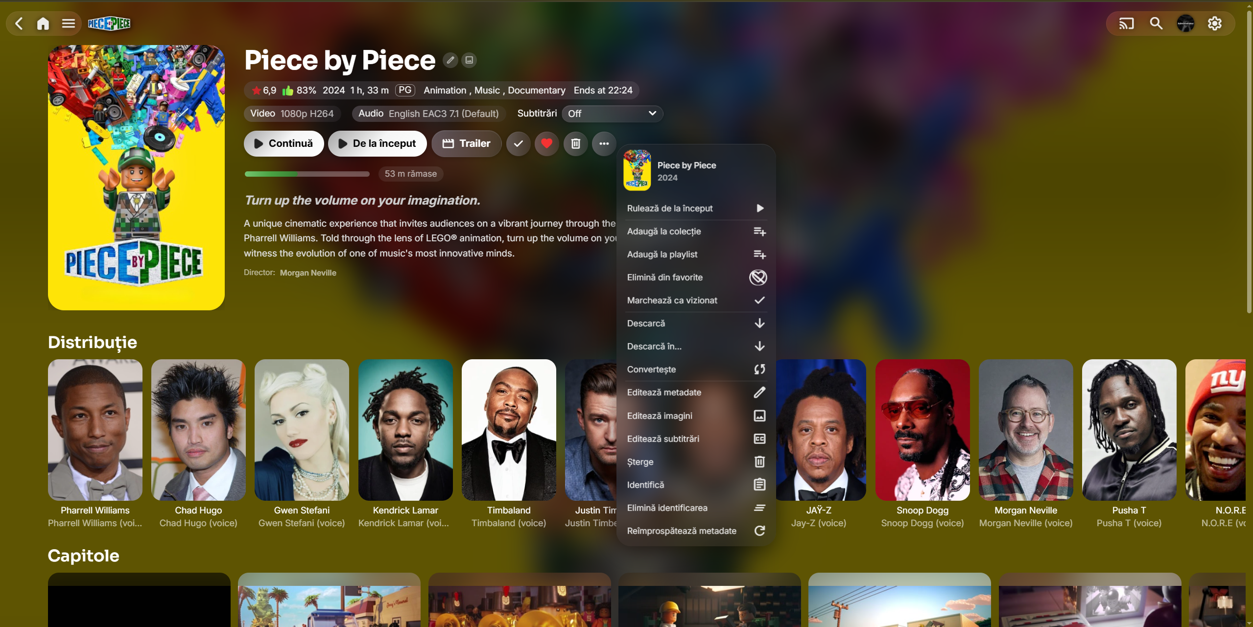

  2. I've completely modernized the Emby interface using custom CSS and JavaScript, creating a premium login screen with full‑screen background and glass‑morphism effect, a modern glass header with blur and smooth transitions, cards with hover animations and gradient progress bars, larger buttons with press animations, enhanced OSD video controls with hover effects and a YouTube‑style center play/pause overlay, a fully customized volume slider with modern glass design, cascading entrance animations throughout, full Dark and Light theme support, custom logos replacing default icons, a fully responsive layout optimized for all devices, premium Sora and Inter fonts
