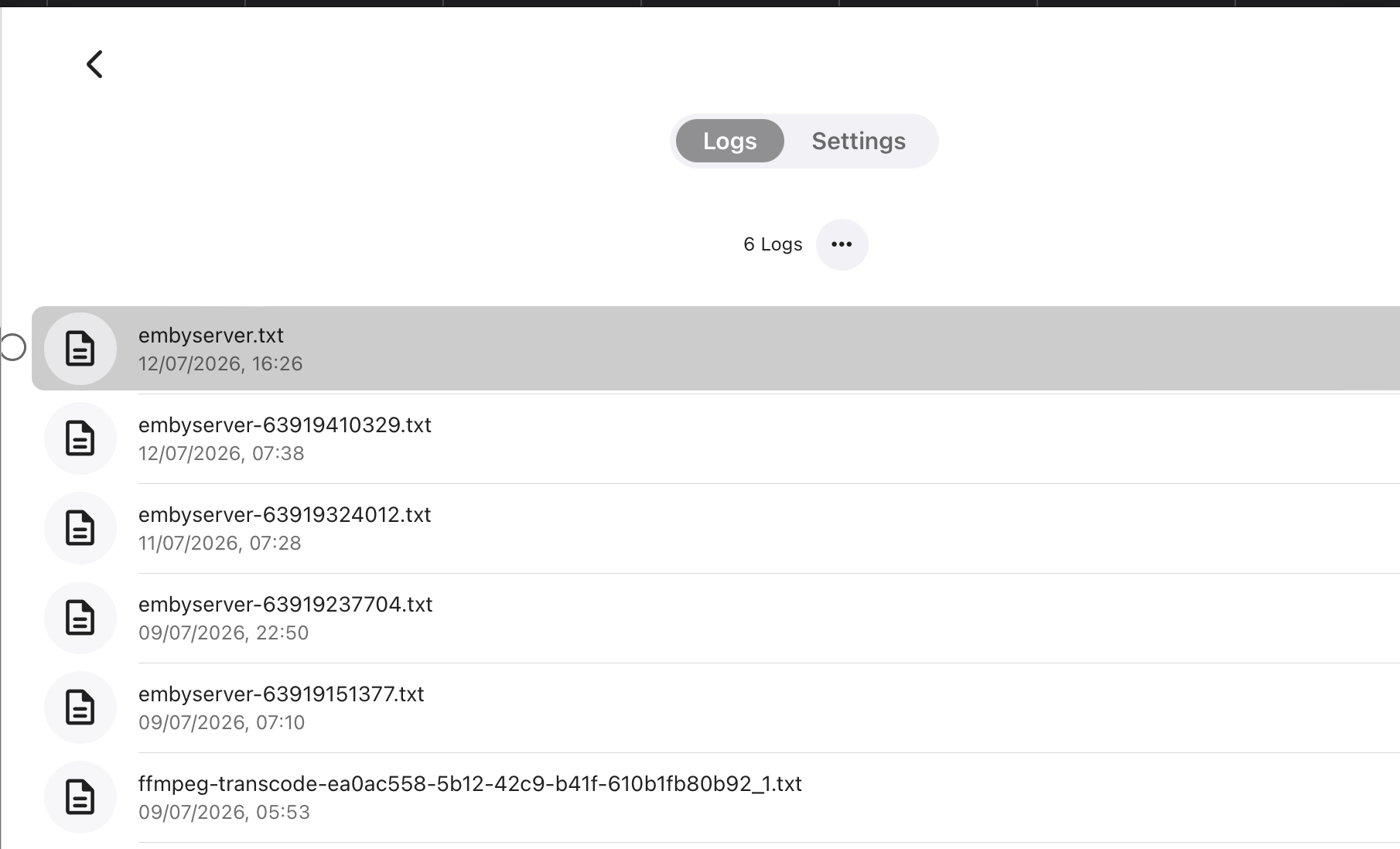

    This should have some upload logs in it as an example.. I can't go back further than a few days? I can't see where this option is? " Show all episodes of all seasons together" embyserver-63919237704.txt
  5. Hi there, please attach the Emby server log from when the problem occurred: How to Report a Problem Thanks!

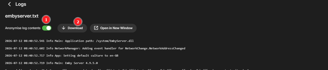

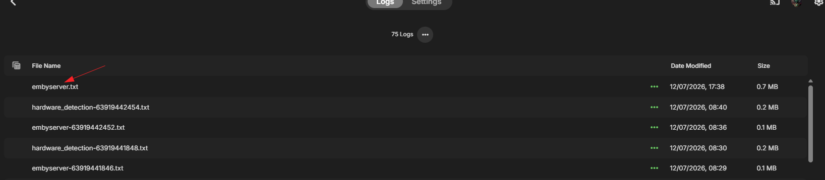

    Anyways click the logs that is with in the time span. Then you should see something like this. Click 1) then 2) and upload to forum ( drag 'n' drop )

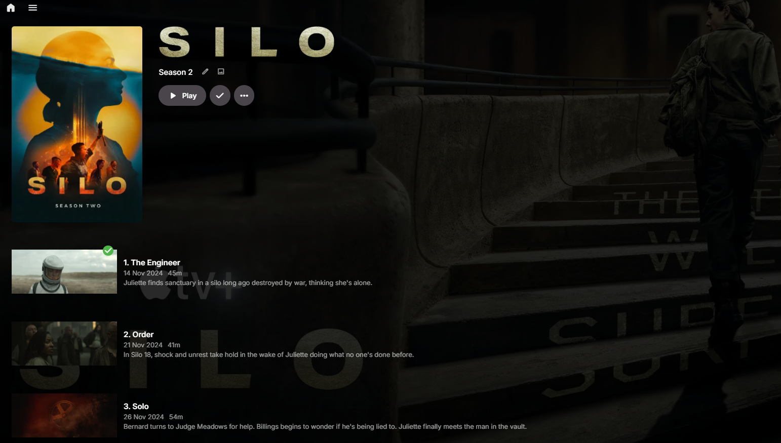

  14. MichaelReed
    TV Episode Naming Convention
    Very odd.. mine aren't too dissimilar and as I say it was working before and just seemed to stop? Movies all work ok using the naming conventions. Server logs wise... help me out haha... I don't have any historical logs? How do I get them?
  15. Neminem

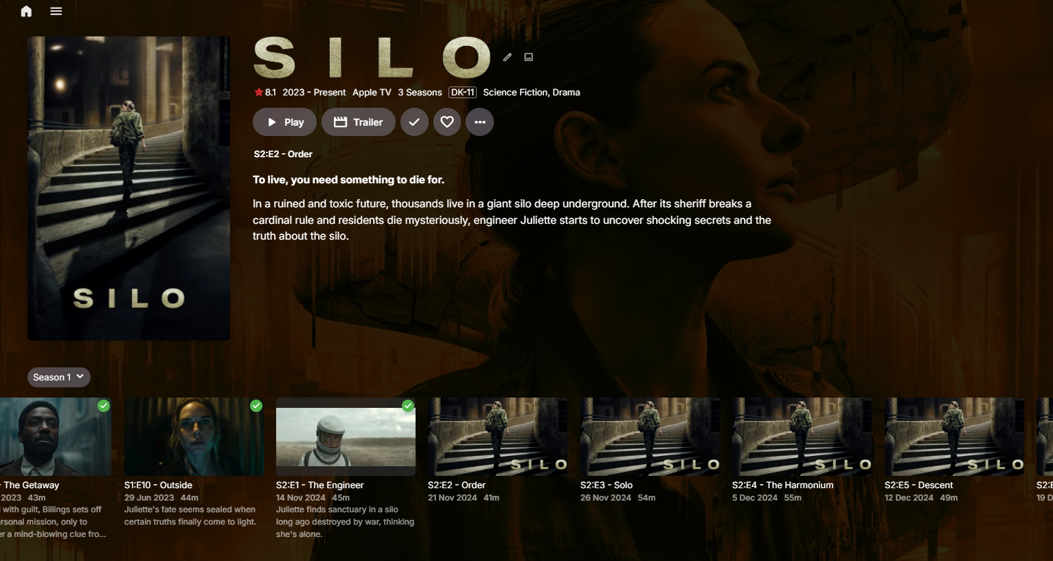

    Ok With " Show all episodes of all seasons together" ticking hide and unticking hide I now see this.

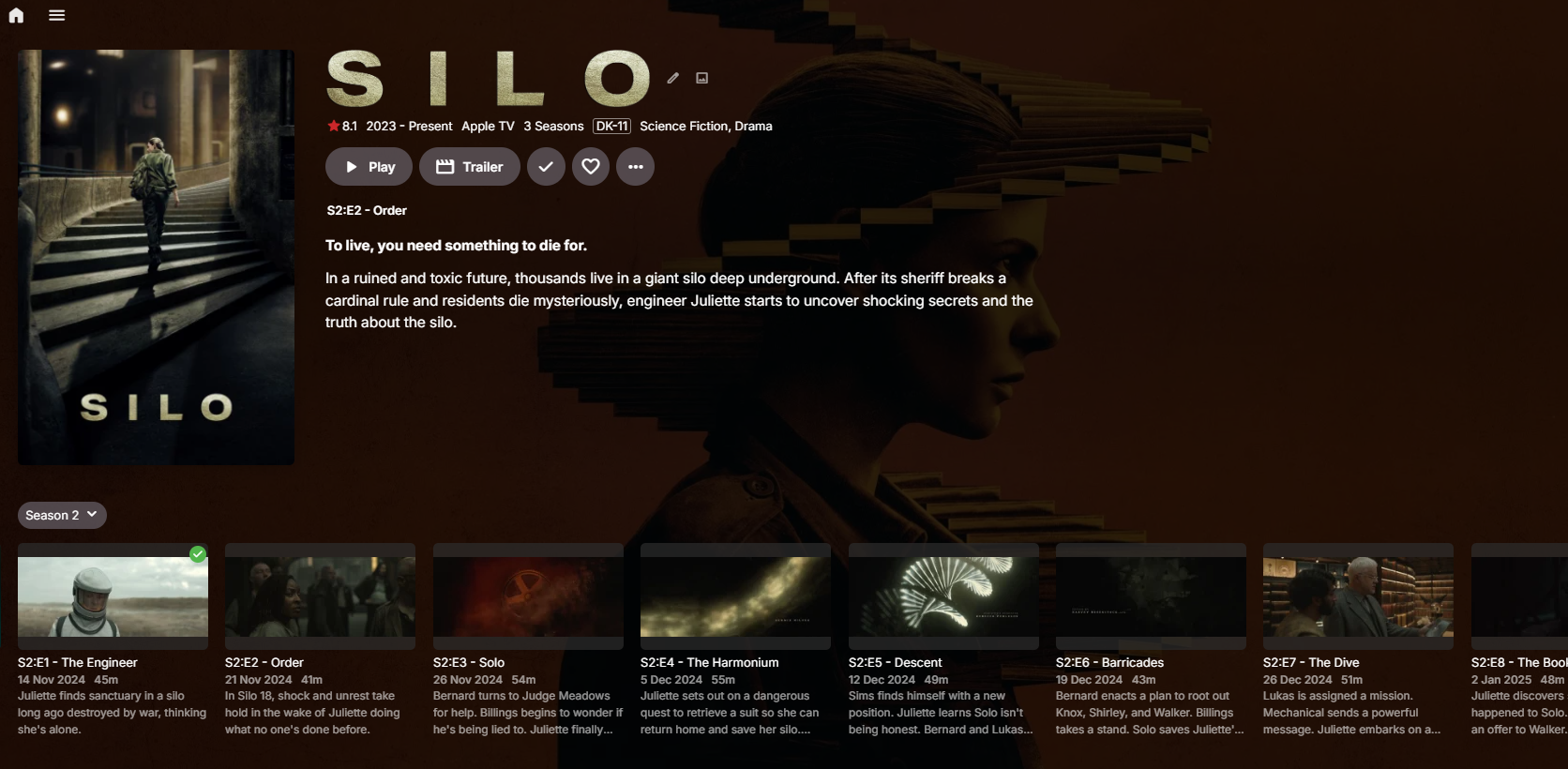

  16. Neminem
    I guess that a bug. I'm seeing the same now. With " Show all episodes of all seasons together" With out that and set to "Always show season folders" I see this.

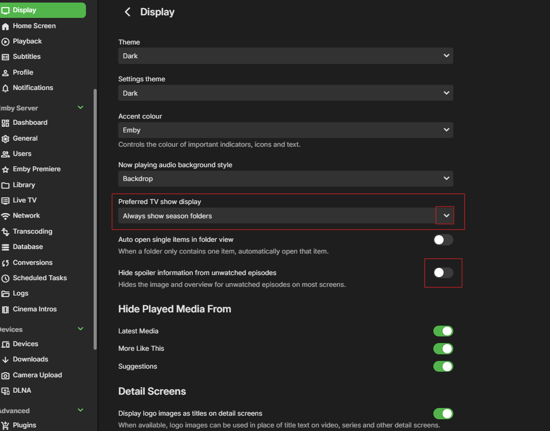

  17. js28194
    Try looking into this setting....
  18. Neminem
    Here are some screenshot of my libraries.

  22. MichaelReed
    Also just to add this isn't isolated to that Silo TV show that's just an example. Its every TV show after a certain point. I haven't amended anything or changed my formatting at all. The only issue is the Handbrake. I am changing the file to a h.265 Even that doesn't hugely tie in though as I have some files that have worked after compression.
  23. MichaelReed
    Can you show me how you have set this up? I have tried it that way and for some reason its made it worse haha.. Amending the headline series to this Silo (2023) [TvdbId=403245] and rescanned has now made all the episodes unrecognisable to Emby? I have attached a load of screenshots. It wasn't happening until recently and haven't really changed anything. The only thing I can think of is my file compression using handbrake as a difference.. Do you TVDB the actual episodes as well? I haven't in the passed and it pulls in the metadata.

  27. Neminem
    I use tvdb id, and don't see the issue Silo (2023) [TvdbId=403245]
